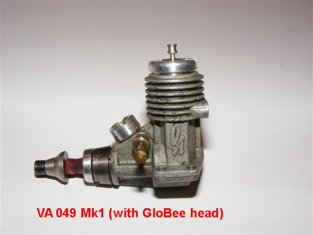

These were made over 20 years ago-and are long since out of production. They were superseded about 12 years ago (ca 1999) by a Mk2 version which was even better-but lot more reliable and a bit heavier and of more conventional construction-but these too are long out of production and the Russian manufacturer is no longer involved with model engines in any way shape or form [a great pity]
Only likely place to find them is Ebay, or on the NFFS for sale items-maybe the MECOA wanted/for sale listings. I have four of various pedigree plus the 020 (which was a big disappointment!)

Yes that is the one the mark 1. it is a very small engine. it has a adjustable timing/compression piston. the connecting rod screws into the piston. once you get it to the setting you like you loctite it into place.
Anyway 25,000 on a 4.5x4 out of it. would be perfect on a 10 ounce 100Sq plane.

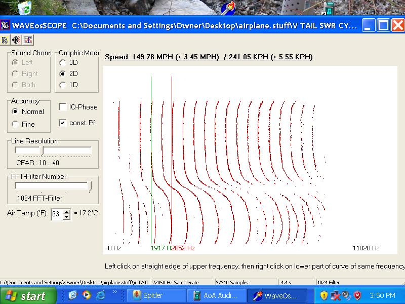

Last time I checked, Doug Galbreathe was a reliable supplier. The problem is he doesn't place an order until he gets a quantity of orders so that he can get a bulk discount from Cyclon.
Depending on where your money comes in during the ebb and flow of his supply of engines you might have a long wait or you might not.
I have a Cyclon .061 powered model that did almost 150 mph on 30% nitro, the wing is about 125 square inches and it's made out of 1/4" balsa sheet.
The wings have to be very thin on a 1/2A speed model.
I would look at the Stuka Stunt and MACA bulletin boards for good used engines, as well as Ebay. There are alot of old timers who got into 1/2A combat as an after thought who have low time engines sitting around collecting dust.
