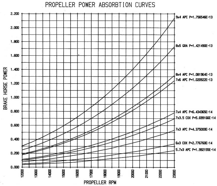

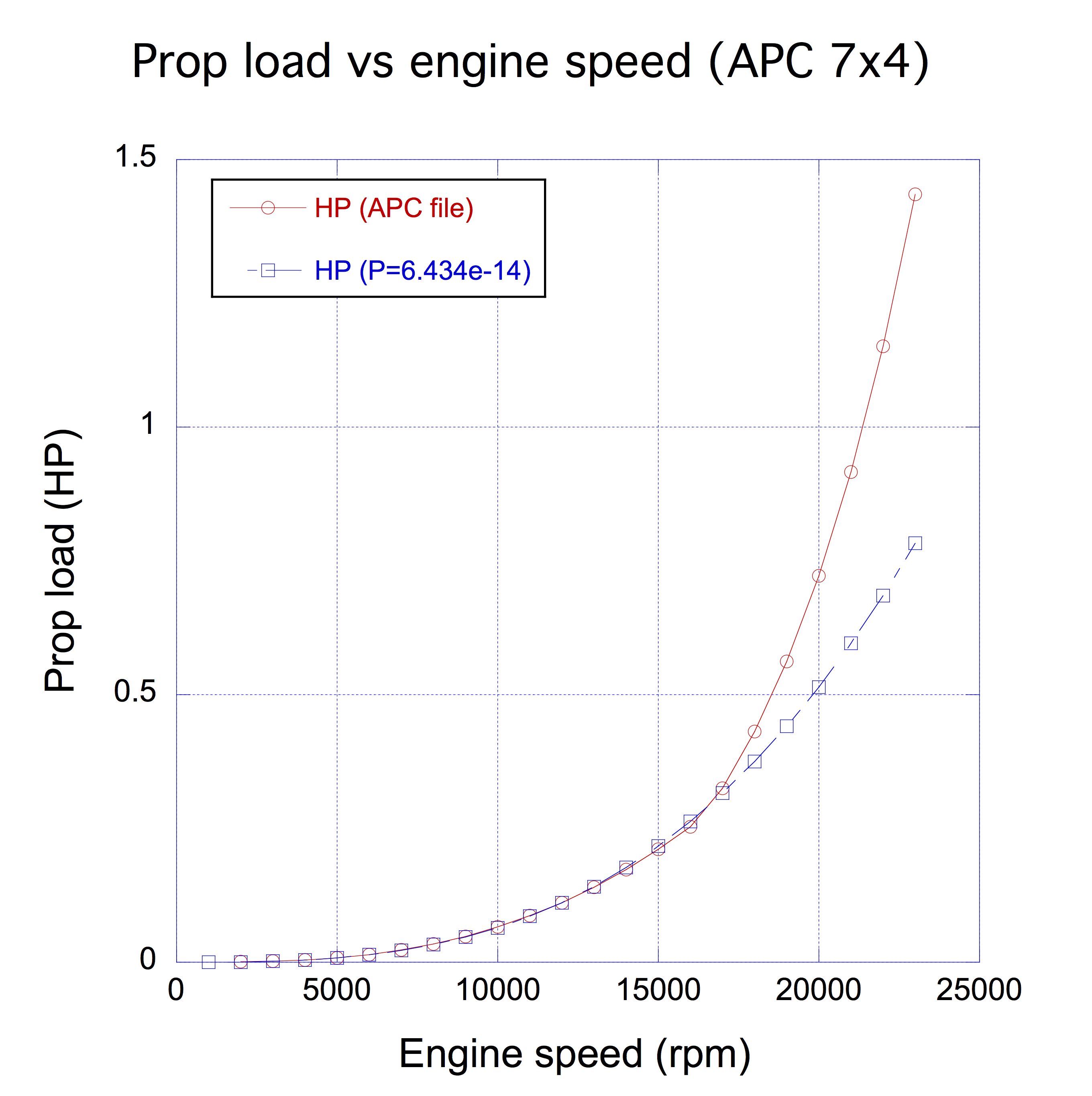

I've had a closer look at the data from APC themselves (https://www.apcprop.com/v/PERFILES_W...tDatafiles.asp) and there is something strange with the 7x4 prop. Don't know about the other props (there could be similar errors) but here is a plot that illustrates the problem. The red curve is from their data base and it doesn't follow an rpm^3 curve after about 17000rpm.
So these numbers seem more accurate (power in HP = P x rpm^3), and replicate the APC data file for revs below 17000rpm (also shown in the blue curve above);

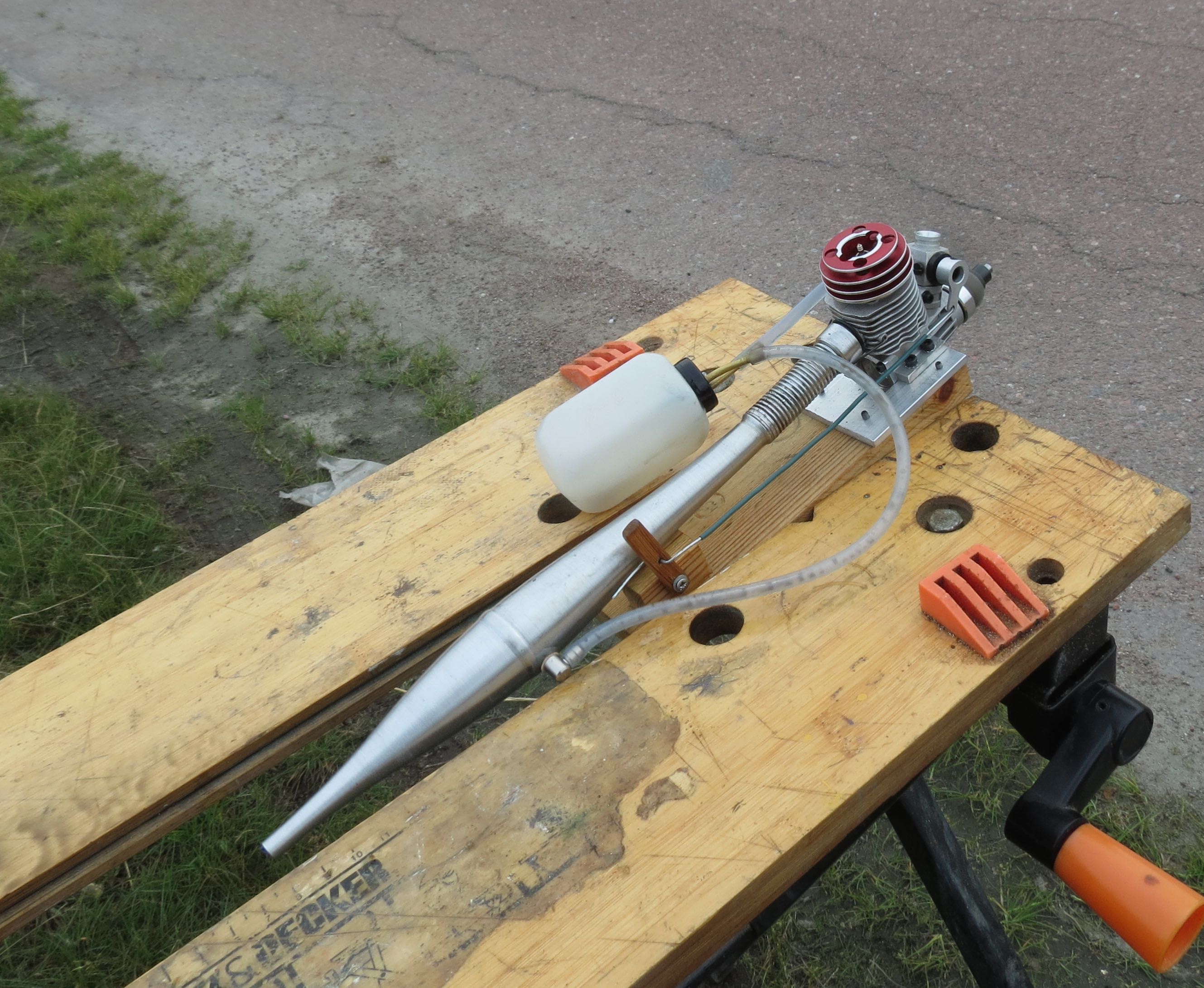

Forgot to mention the reason for getting into the details of the APC 7x4 prop...
I have used that as a reference prop for .10-.15 engines, and it has been working fine until a Picco .12 engine spins it at 22000rpm. This would be around 1.15 hp (!) if one were to trust the data file, but a little more reasonable 0.68 hp if one uses the rpm^3 formula.

Here it is with an MVVS muffler making close to 19000rpm:
http://www.youtube.com/watch?v=n7YEtP5cEbI I somehow messed up the video though with the Rossy pipe on it (did around 22000rpm) and only got an image;

I read 18,491 but you seemed to be doing more of a idle test in this vid, the engine didn't run wide open for long.
Looks good with the tuned pipe 22k static, so unloaded perhaps 24.8

Yes, the engine is set a little rich in the video rather than squeezing everything out of it, and it would creep up towards 18900rpm when left longer at full throttle. The video was more for my own documentation of throttle response etc in order to compare with the running with the pipe on it, but then I somehow screwed that up when I used the camera.

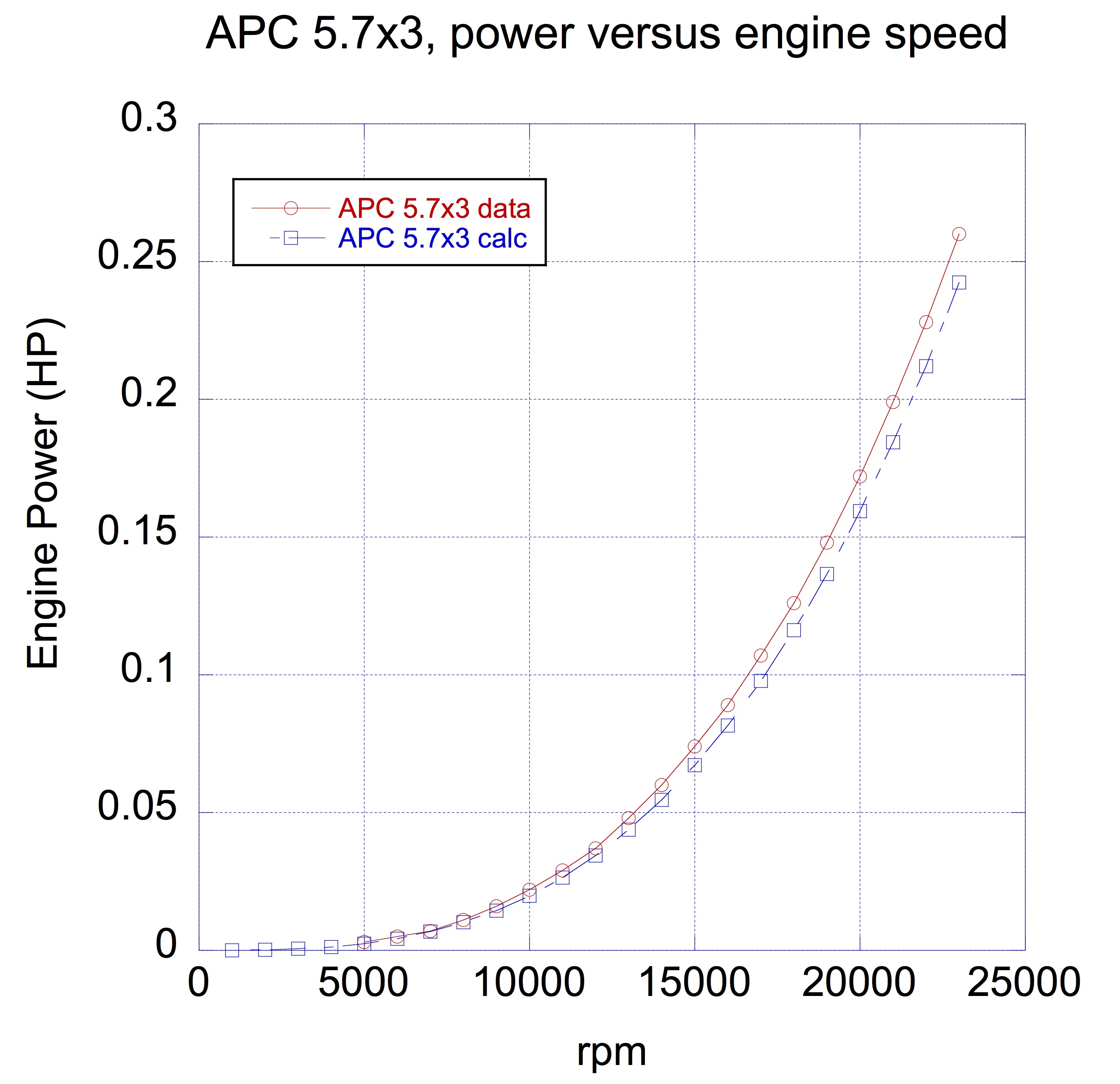

Back to prop loads, I plotted the data for the APC 5.7x3 prop in a similar way, and there the data file seems to be correct up to 23000rpm at least (didn't plot higher). There is only a slight discrepancy in the constant I guess;
