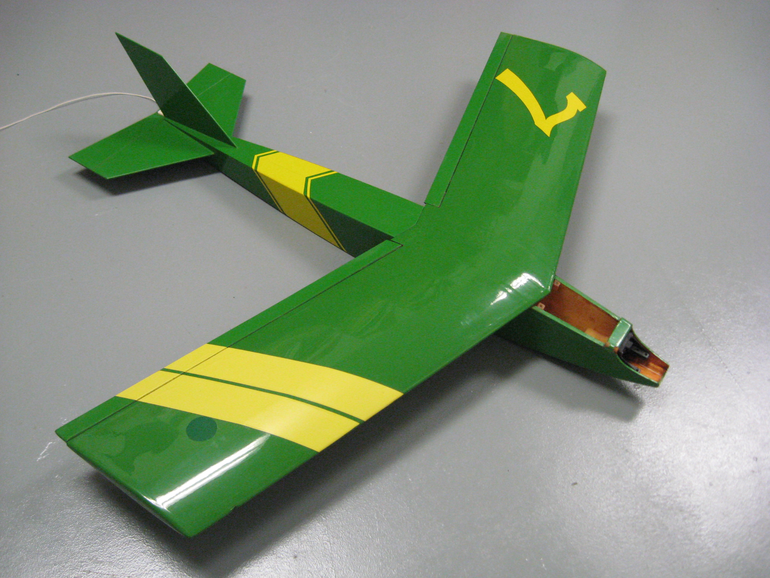

I was coaxed into going flying yesterday even though I have an unusual propensity to build that I haven't had in years. Haven't flown since last fall either. Took three airplanes to the field - one of 'em being the GLH with the modded (1/8") venturi. Halfway to the field, realized I hadn't packed my 1/2A fuel and thought: "Shucks - I'm not turning back now."
Had Omega 10% with me and tried improvising FWIW by loading up the tank with a few drops of castor oil kept in my field box and then fueled up. This action comes from some guys that have talked about the necessity for a generous castor base on these engines and the paranoia on my part that resulted. Two head shims. Back the needle off 1/2 turn prior to start mostly just to break loose the needle for ease of adjustment. With a pessimistic attitude - so I'm never unpleasantly surprised - primed one time and cranked. Engine started easily. Kept glow driver on for a long while and leaned to near peak. Engine started to sag in various attitudes as it always did but exercised patience and laid off the needle for a while. At some point the engine settled into a decent, consistent power level and it felt good level and at ~ +,-15 degrees. I launched and had the best flight with the airplane I've had in years with this engine - was even able to do vertical turn-arounds at each end of the field - Alleluia!
The airplane put in a slightly short flight but pulled well throughout; after about 6 minutes, during one lower fly-by engine stopped abruptly, prop position stopped near vertical, without any hint of low fuel ( I used to get some extended bursts of power prior to emptying the tank and would go for altitude to get an extended glide.) Still had plenty of momentum to turn away from the runway and make a normal turn-around approach for uneventful landing. In looking the airplane over, appeared to have a good smell with nice, clear slimer down the fuse sides and over top of the wing. But then, "Oh-oh, the engine doesn't turn over well at all." Immediately, disastrous thoughts go through the mind: did I ruin the engine? Witness: "Did you ingest your venturi insert?" Me: "Oh yeah, I bet I did... no wait that looks okay... oh, wait a moment, my carb body's loose!" Witness:"Yeah, your retainer nut's right up against the drive plate." Been here before yet still took time to dawn on me; witness processed info quicker...
Is it fixed? I think so, but to be scientific about the whole approach to the problem and listening to some voice that's probably from some long ago conversation from some experienced, wise, old guys talking in the pits about "changing only one thing at a time and checking for a change - if no improvement, try something else... In actuality several things have changed here: four head shims down to two, 30% nitro down to 10%, and the venturi size shrunk and perhaps others like conditions and things I didn't even think of at the moment. I can't but help and think at this point it was the venturi size after all though. Need to try on the usual fuel next time...
Thanks to all again.

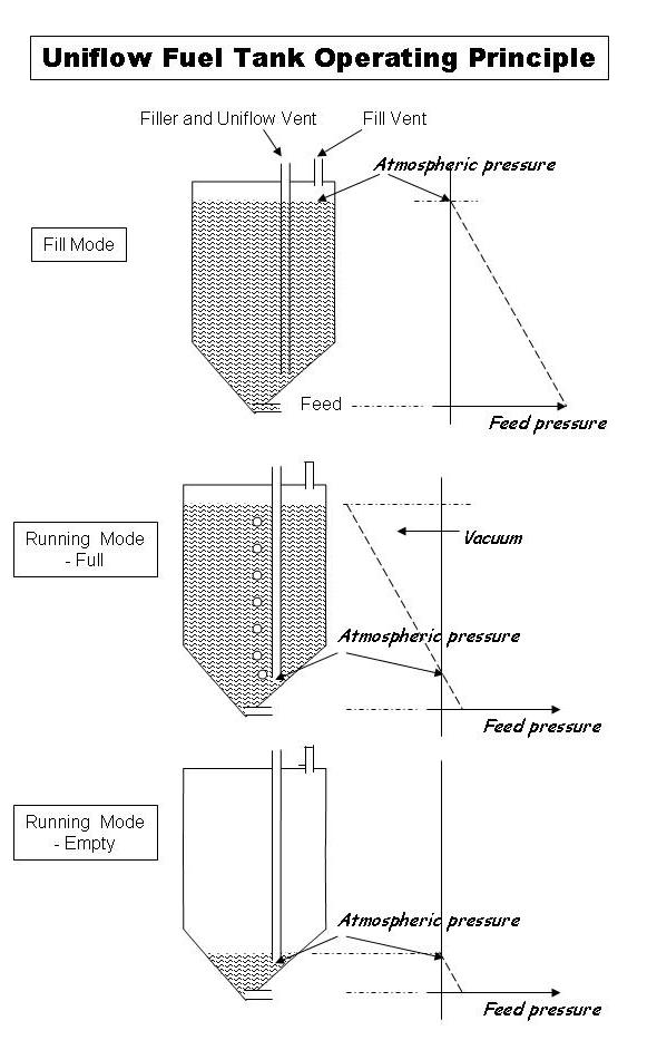

Regarding Uniflow tank - could the fill vent be omitted and tank be filled inverted through feed line?
Regarding bladders - is that a pressure bladder and what's a good source?
#34

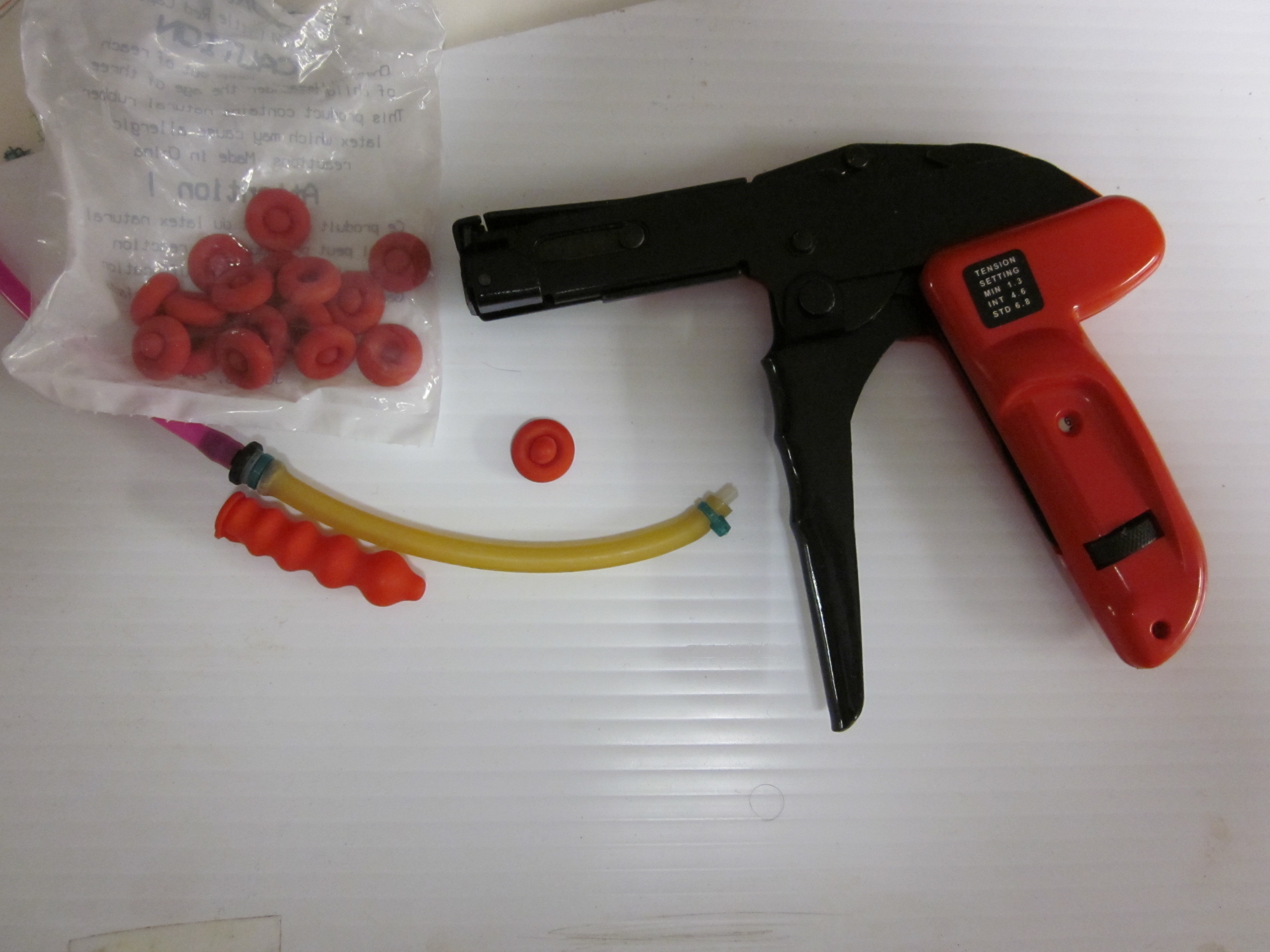

You can fill them any way you wish. Little Red Caps are pretty good low pressure bladders. They are available for about $5 for 20 in a pack. Here we get them from Lee Valley Tools. I think Ace hardware in the US can get them ordered. They are used for caulking guns and work well for that too. They degrade after a few weeks when fuel is on them, and after a year on a caulking gun depending on conditions. You could try Texas Timers for standard latex tubing. I found the local medical supply had some well priced tubing in the 1/16", 3/16" and 1/4" size. A thin wall is preferred if you can find it. The TSC store has some 1/4" stuff that works ok for .15 size stuff.

If you want to use the pressure tap from the back plate, or better yet, the pressure tap on the carb body (best) , then the fill vent is not needed. You just invert the tank and fill through the uni-flow line that goes to your pressure tap and the tank is full once it comes out the feed line to the carb.
A large syringe and a wooden cloths pin is all you need to fill a pressure type bladder. I put the bladder in a balloon in case it bursts. Use the clothspin to clamp the line, and release it once the engine starts.
Another set-up it to use a small balloon inside a tank. The balloon is wrapped and sealed around the outlet fuel line. The vent goes to your pressure tap. First, blow on the pressure line to collapse the balloon inside the tank, to get all the air out of the balloon, Fill the ballon via the outlet line from the tank. When the engine is running the pressure from the pressure tap will push on the ballon and force the fuel in it to the engine. I beleive they sell kits for this, as my pal Larry Renger tells me the control line guys use this set-up.

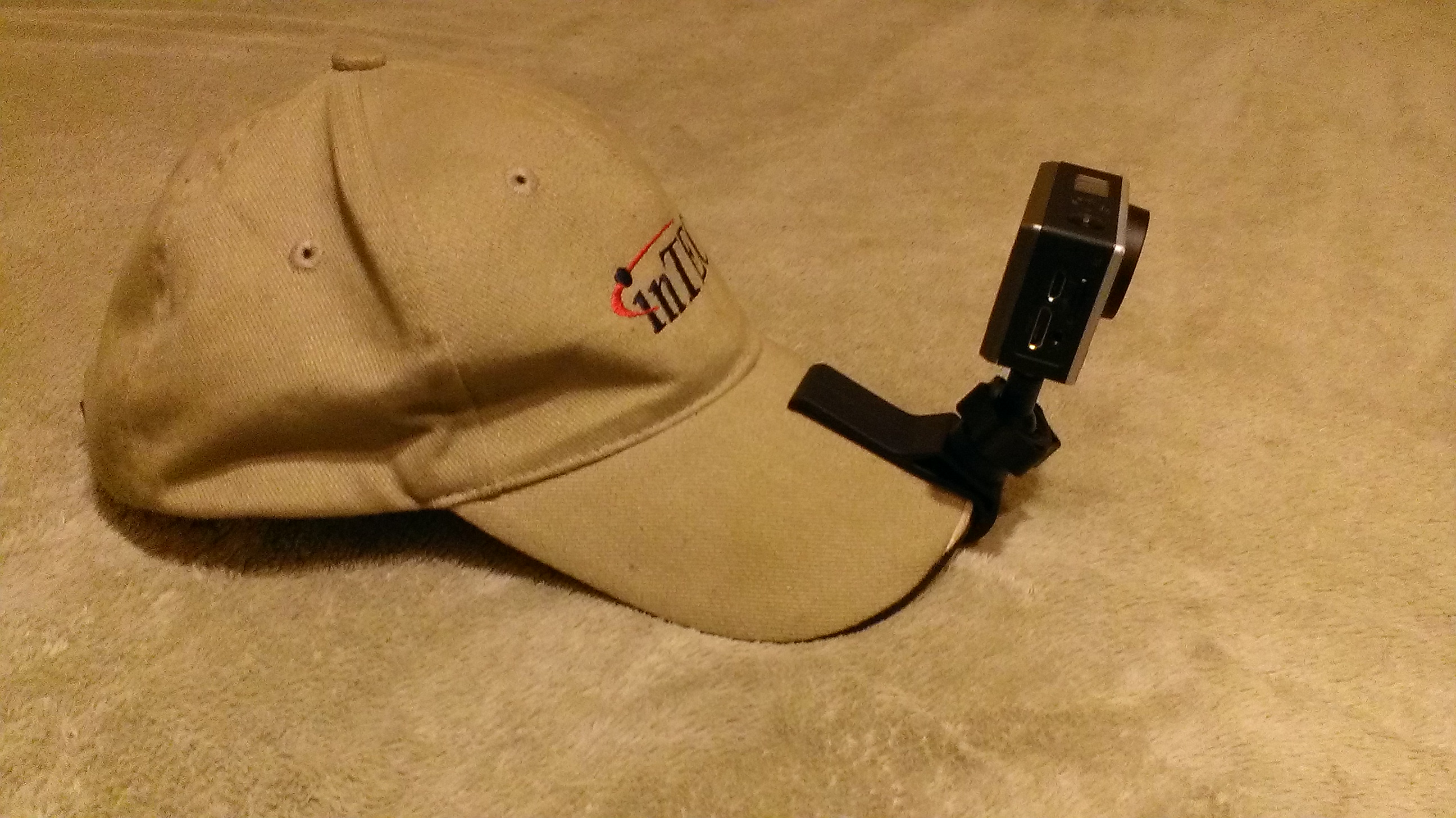

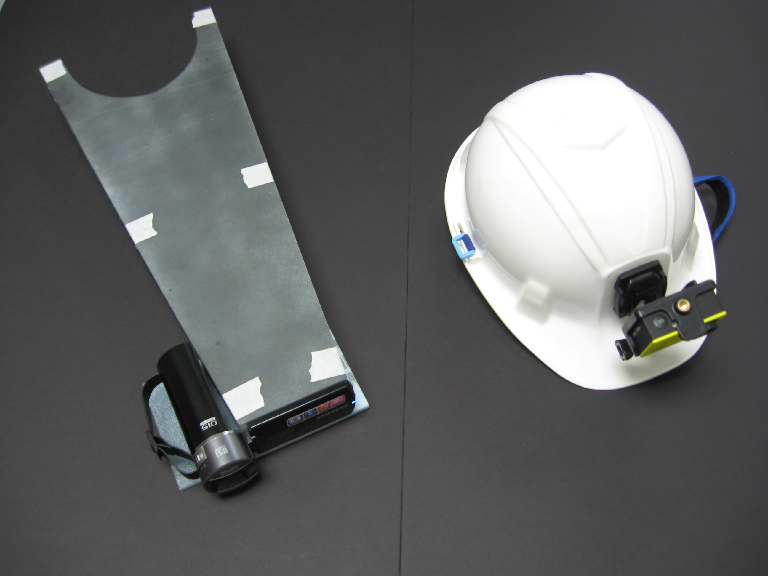

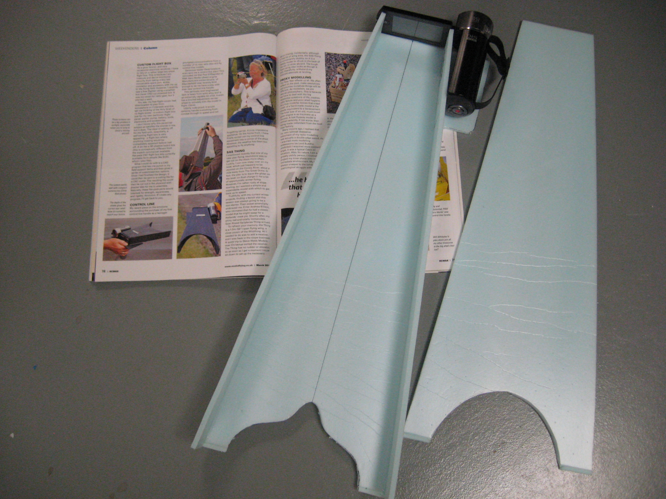

Spent some time trying to use the included accessories and found a combination that looks like it will work. Used my old pylon race helmet and drilled a single 1/4" hole for a 1/4x20 nylon bolt. Has the added benefit of emphasizing the "geek" factor too!
Also used a bit of fanfold foam to put together a face-hugger sunshade for the handheld camera - got idea from the local bookstore Brit aeromodeling mag - just don't know how to turn the camera on or off without having to open/close the viewfinder...

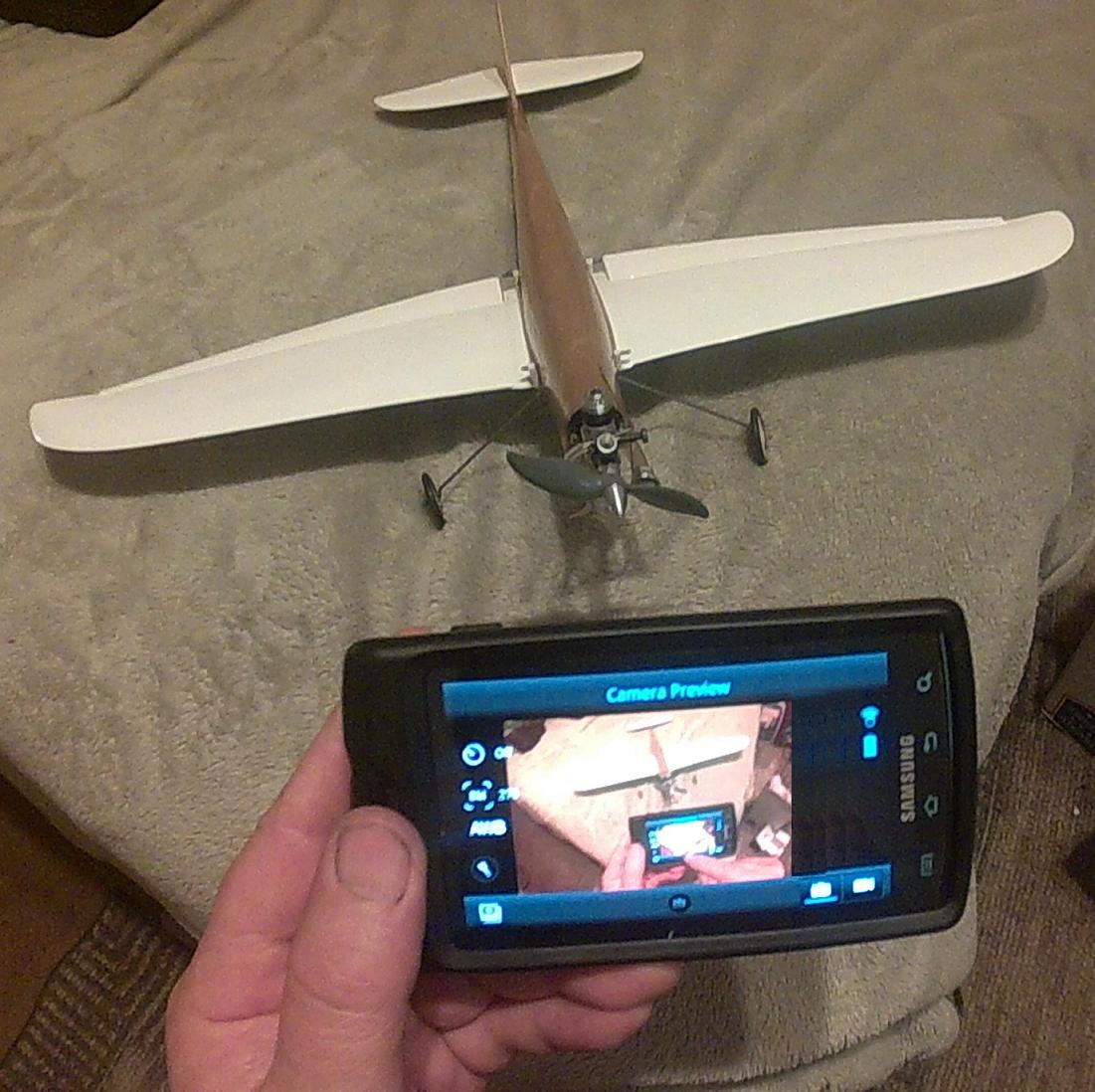

Nice the helmet cam will get it done
My sport cam has wi fi so I just turn it on / off with my cell phone shows a nice view on the phone.
I check my hat / cam position then hit record on the cell.
#43
That's very cool; picture-in-picture and adjustments can be made in real time. I'm a little behind the times and somewhat resistant when it comes to hi-tech gadgetry - I don't think I can do it with my dumb style, flip-phone - wife and I have discussed moving into smart phones...
