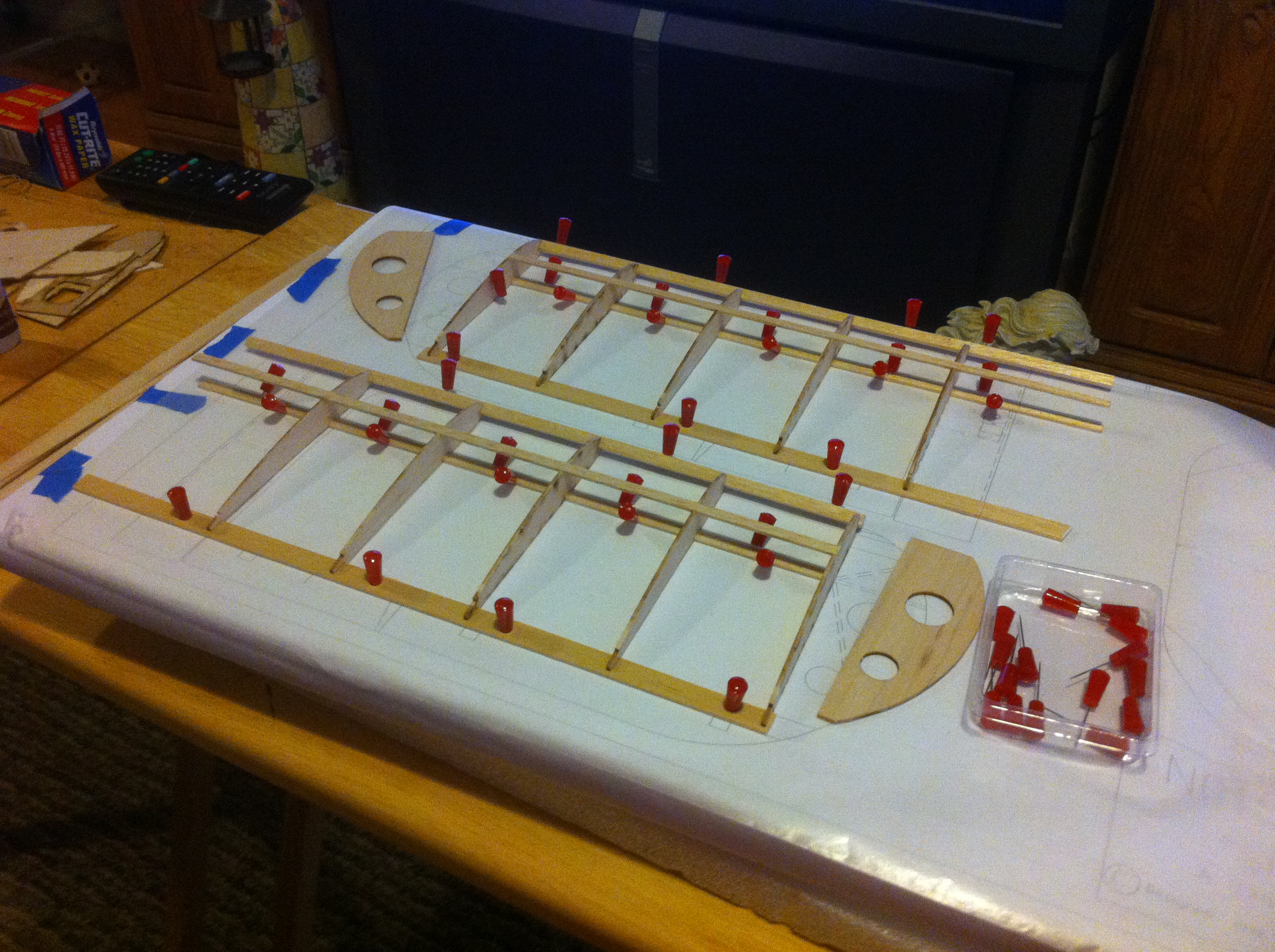

The wing panel pics are from 2012. I believe it has a 24" span.

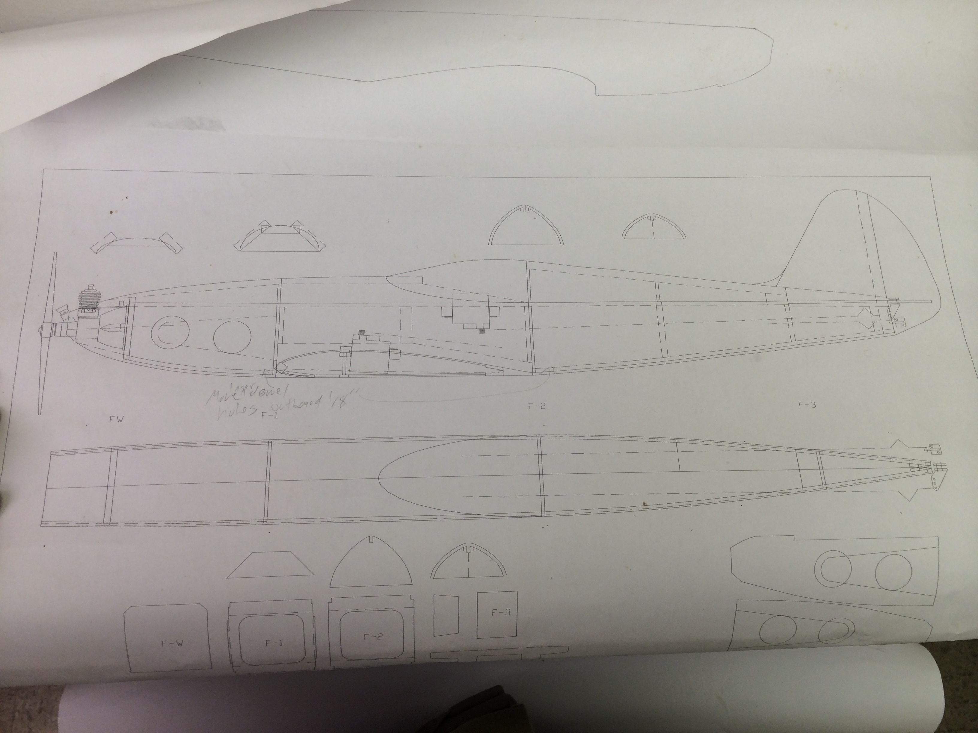

Old 07-30-2017 | 02:55 AM
Joined: Feb 2007
Posts: 1,984
From: Angleton, TX

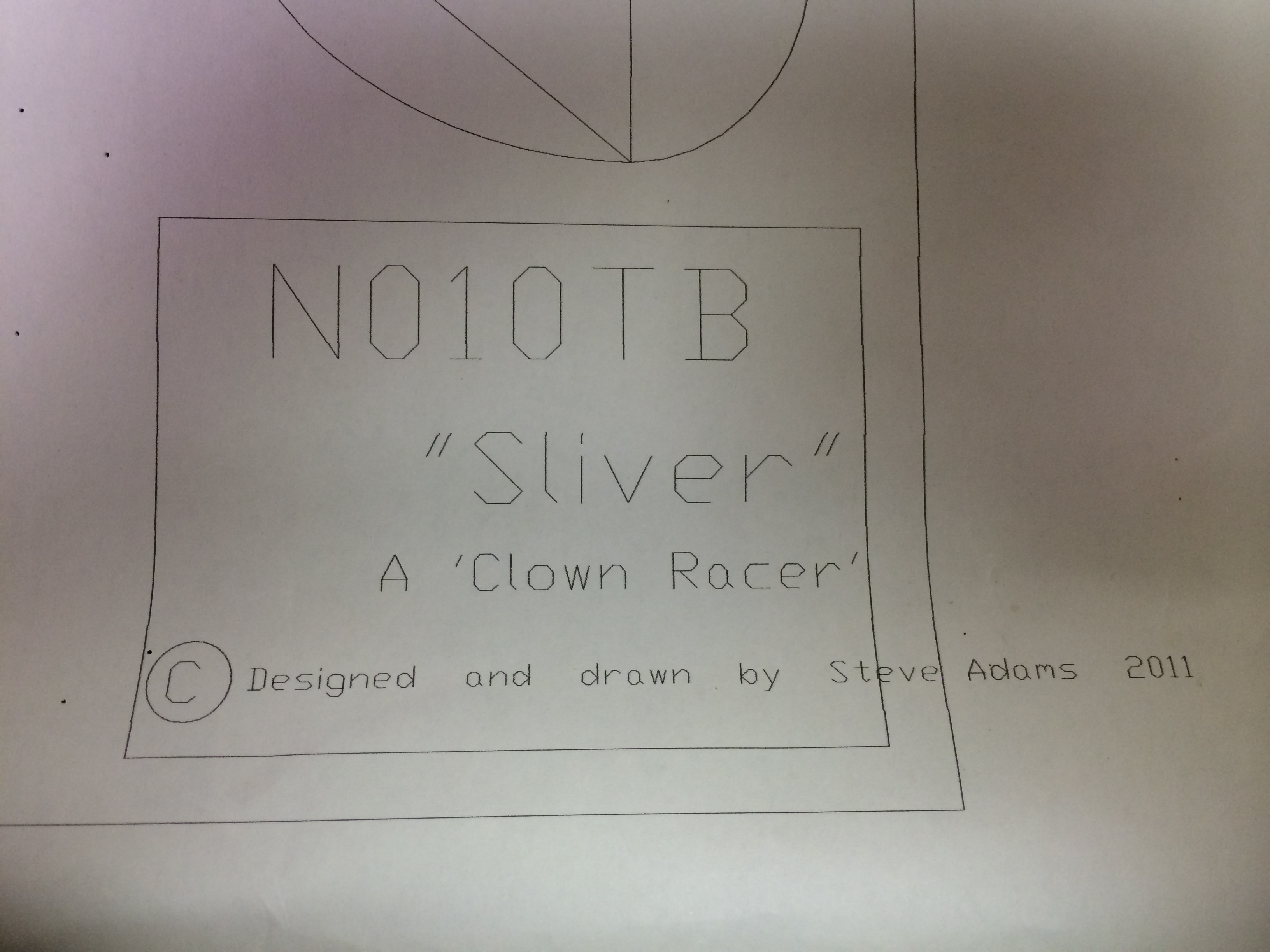

The plans as drawn by skaliwag.

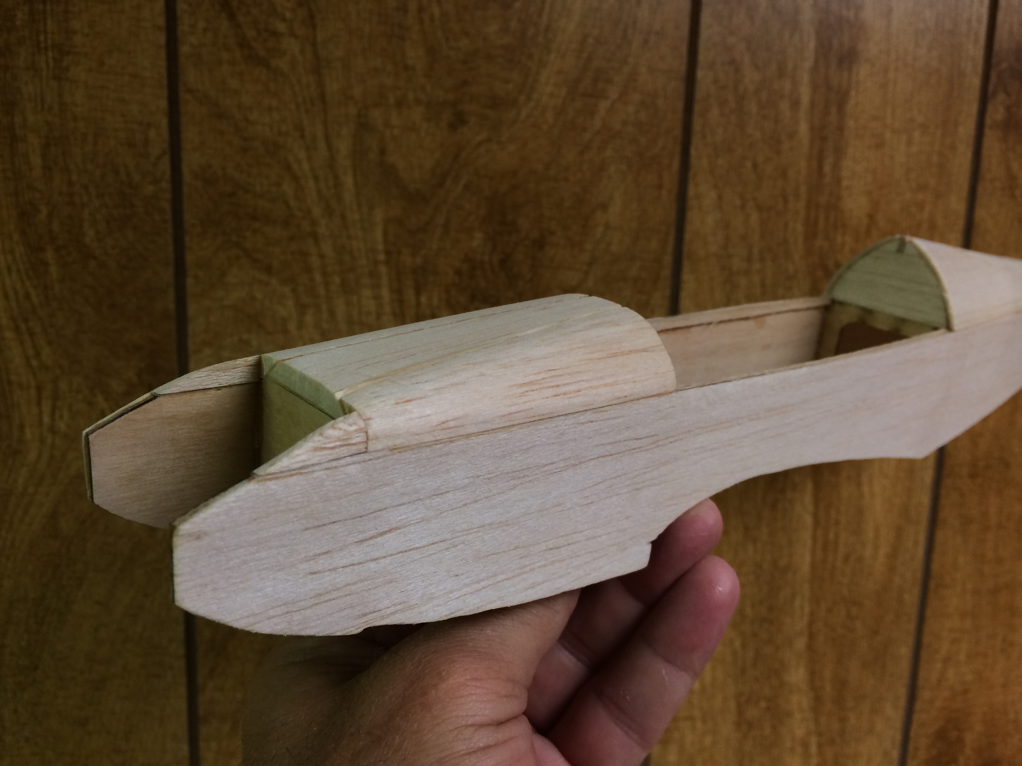

I resumed the project by starting construction of the fuselage. The pre-cut sides were only 1/32" thick. They were paper thin and flimsy so I laminated them to achieve 1/16" thickness and they are now much more robust. The forward doublers were installed and1/8" stringers glued into the corners. I glued the sides to the bulkheads while they were pinned upside down on the plans to keep everything aligned. After the firewall was shaped, it was epoxied in place. The upper bulkheads were then installed which lay the foundation for the turtledeck and the area behind the firewall.

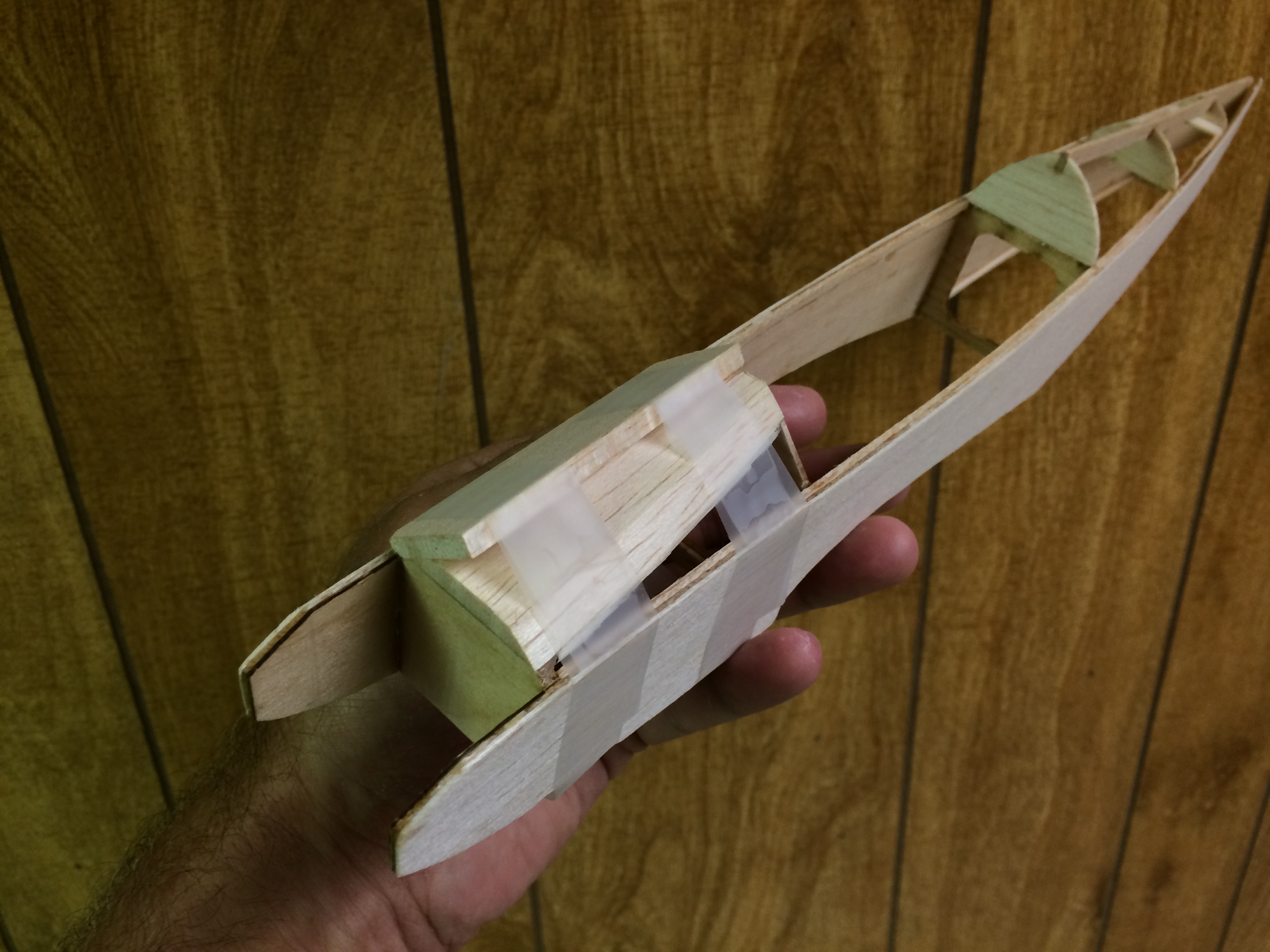

At this point, I began adding 1/4" thick pieces of soft balsa cut and beveled to fit the forward section. I continued shaping and adding blocks of 1/4" as needed then started trimming them and sanding/shaping them into the desired contour of the airframe. The turtledeck was sheeted with 1/16" balsa.

More filling/sanding/shaping. This type of build is much more time consuming than a typical boxy, rectangular "stick" type plane but will be easier on the eyes when it's finished. I just made it up as I went along since the drawings didn't provide any details of the technique needed to achieve the overall shape. It's a satisfying project but probably not suitable for a new model builder.

The cockpit area was built up in the same manner, using spacers as appropriate to support the blocks at the proper height. This allowed careful sanding and beveling of the blocks without them breaking off during the process. I used Sig Bond alaphatic glue on the blocks to make sanding easier than if I had used CA. Once it was all set, I began shaping everything with sanding blocks. I then made a pencil line for the cockpit area and carefully cut out the section with an Xacto blade. So far, so good. I'll apply lightweight spackling to all the joints and cracks to smooth things up a bit.
​​​​​​​Feel free to chime in with ideas or opinions. I'll probably ignore them, but it may make for good conversation along the way.

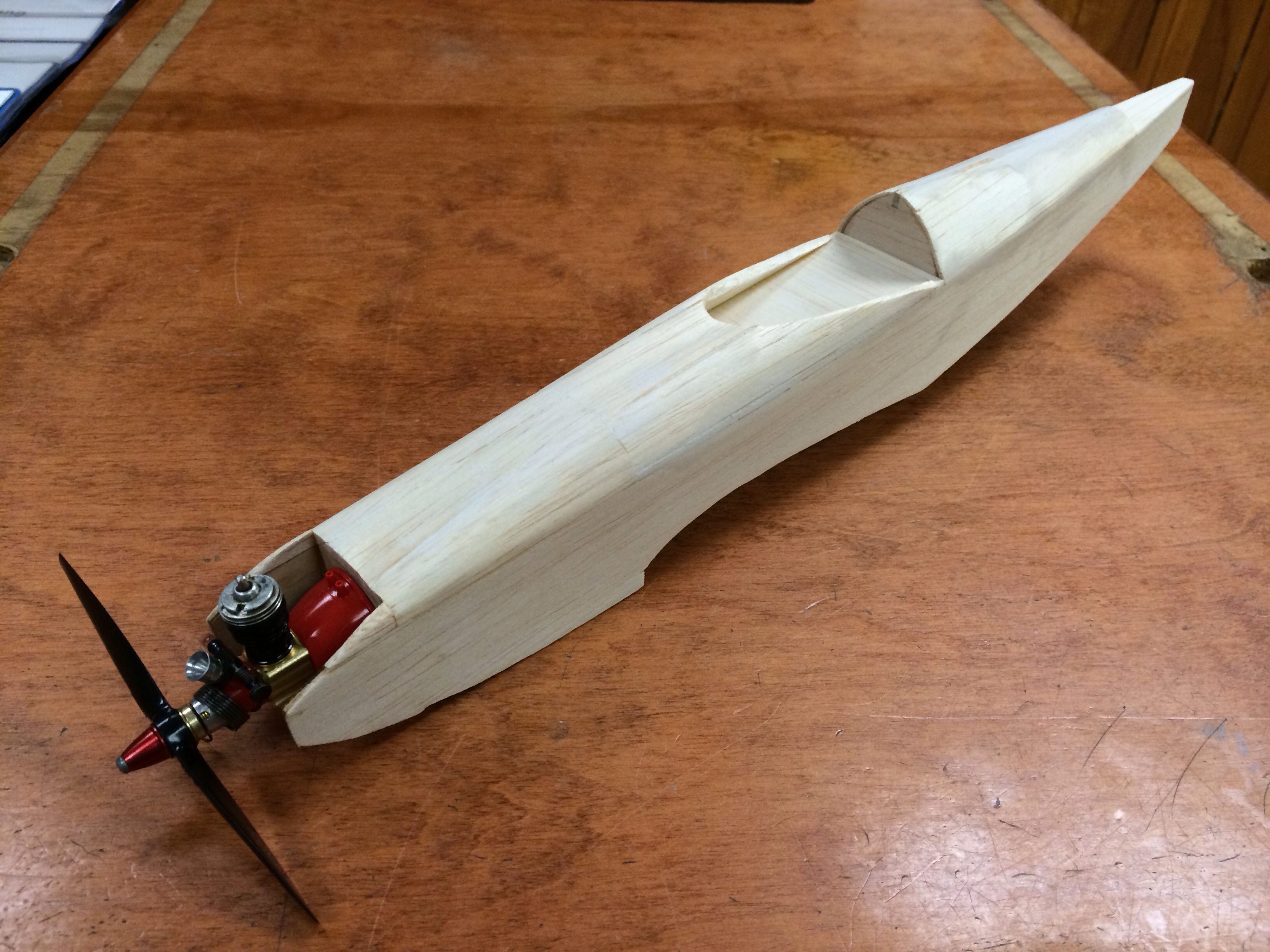

Old 07-30-2017 | 02:18 PM
Joined: Feb 2007
Posts: 1,984
From: Angleton, TX
After filling in some of the seams and rough spots with lightweight spackling, I did a quick sanding job to smooth it out and mounted the engine to the firewall for the first time. This is one of my favorite parts of building a new model plane.

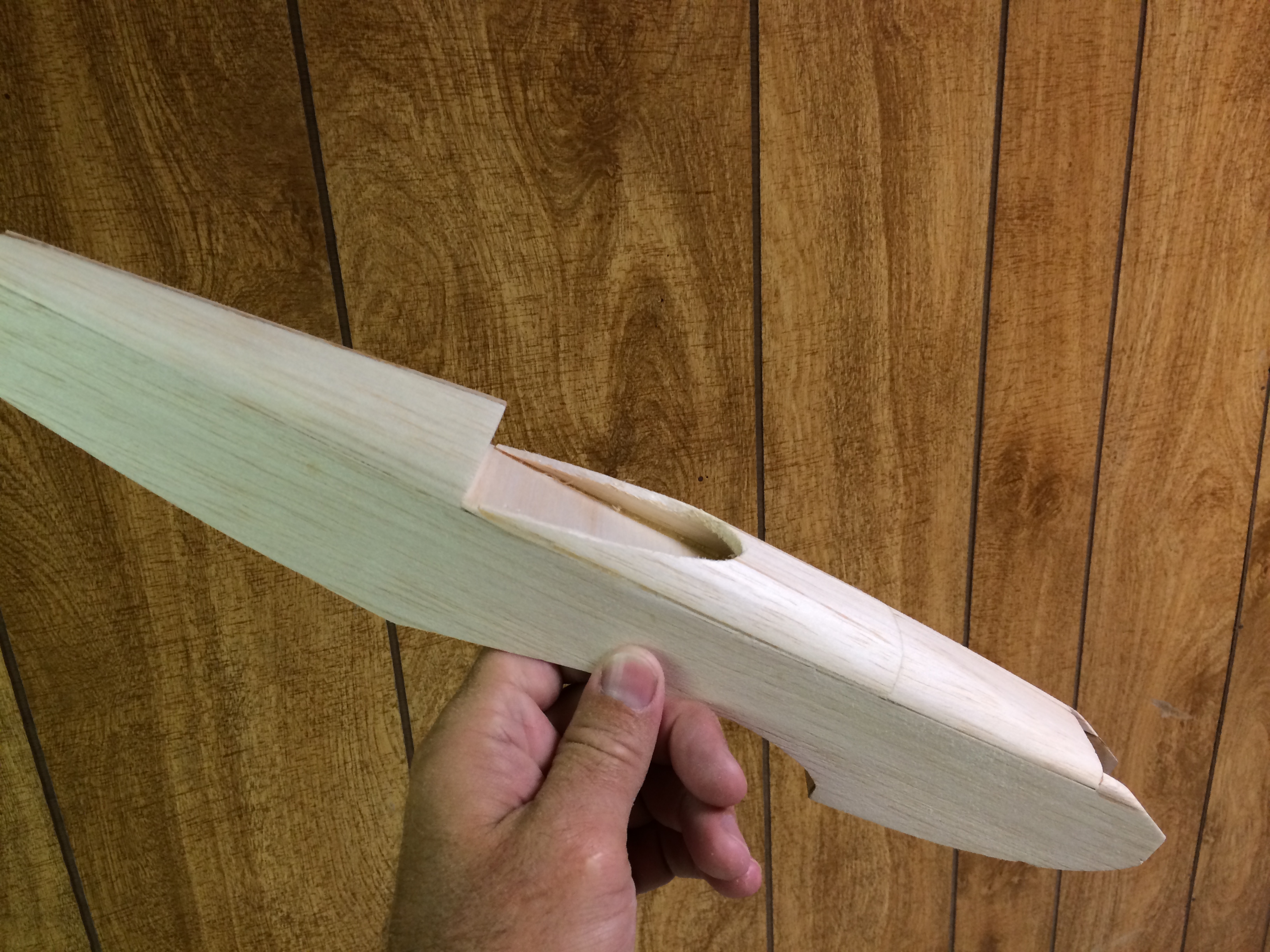

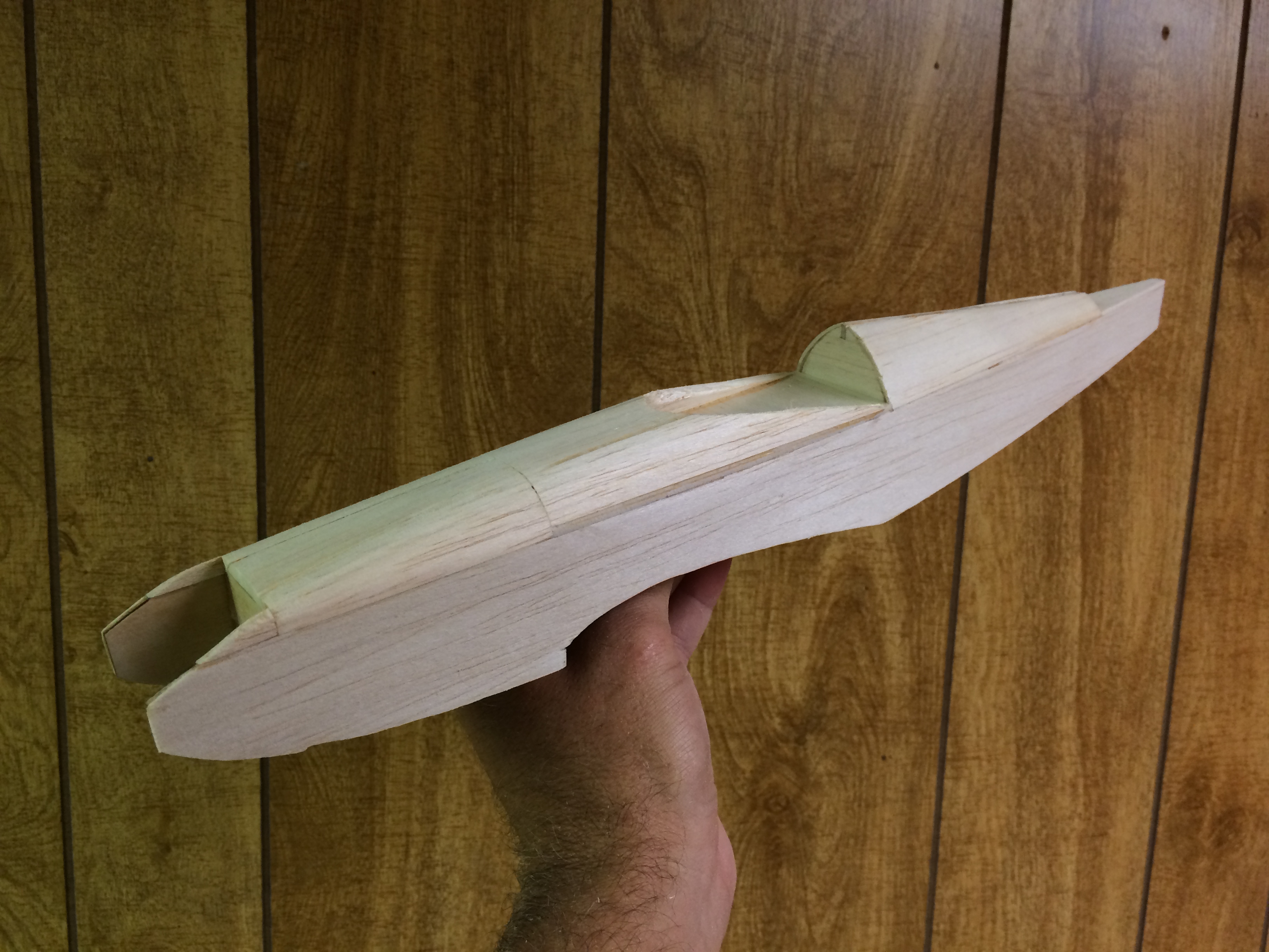

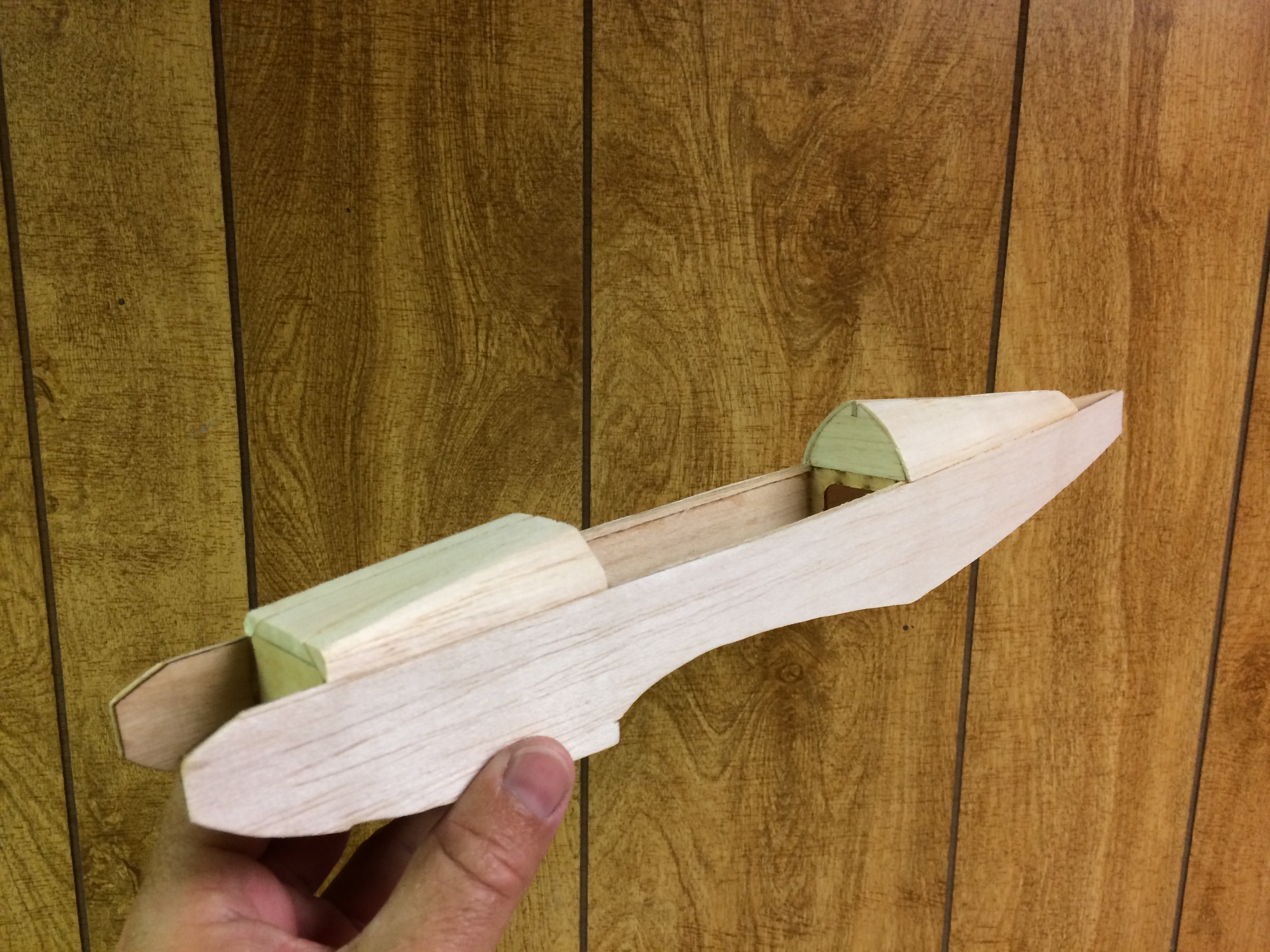

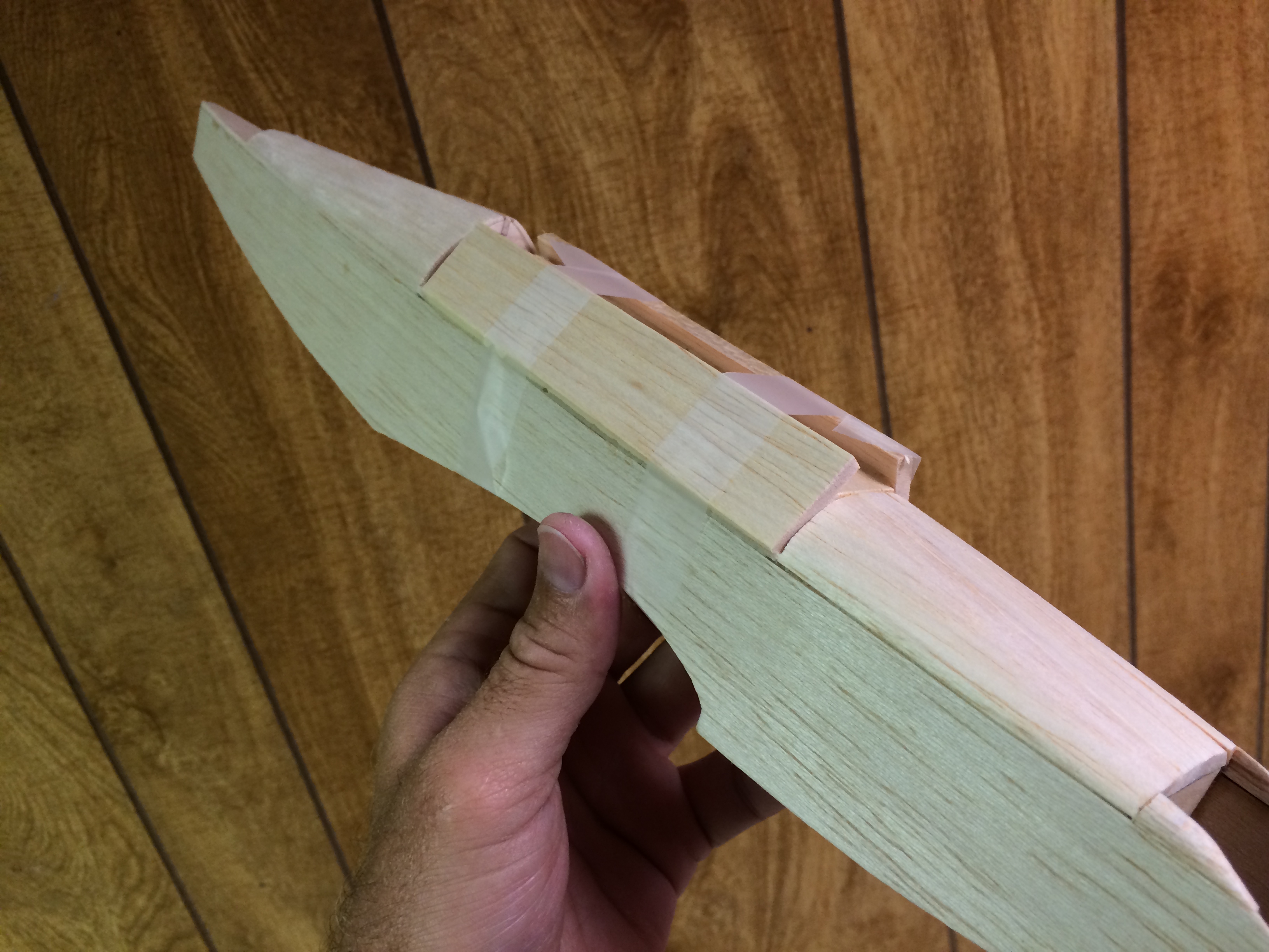

Old 08-08-2017 | 09:30 PM
Joined: Feb 2007
Posts: 1,984
From: Angleton, TX

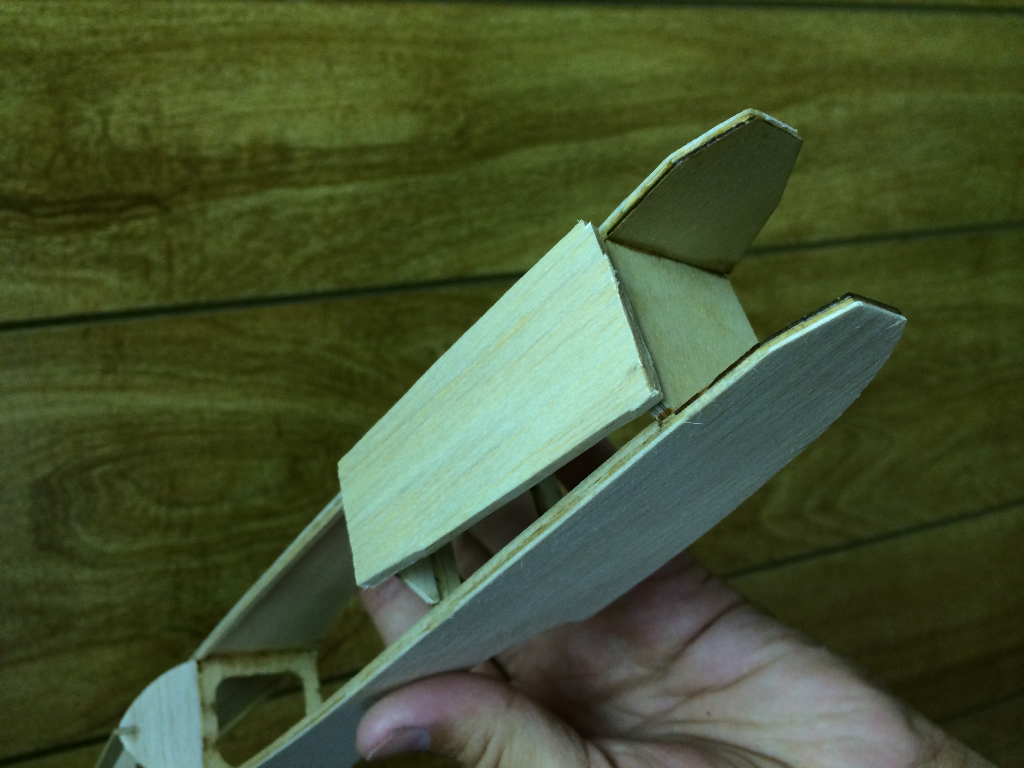

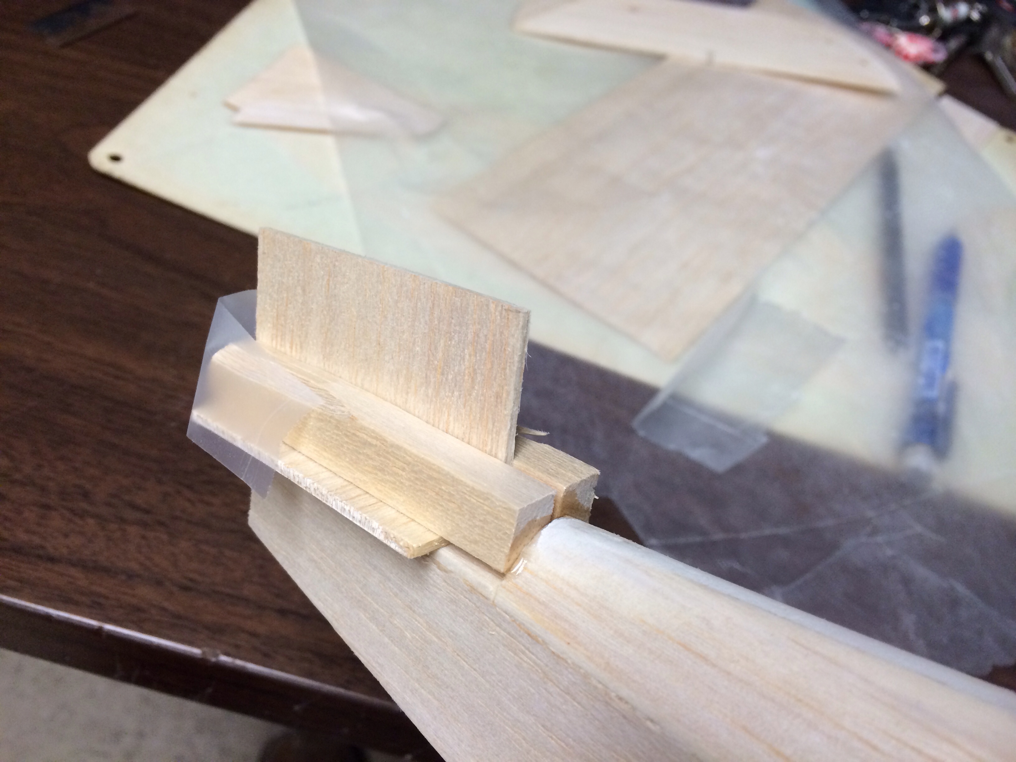

Since you brought up the subject of tail fairing blocks.... My first attempt at making them failed after gluing them to the fuse with CA, lightly tacking the spacers with Sig Bond, and attempting to countour the blocks with a belt sander. The sander promptly grabbed hold of the blocks and snapped them off of the fuse, sending parts across the shop. On the next attempt, I epoxied the blocks to the fuse with the spacers taped in place. Once the epoxy had set well, I began hand shaping the fillets with a small sanding block. This worked much better.
