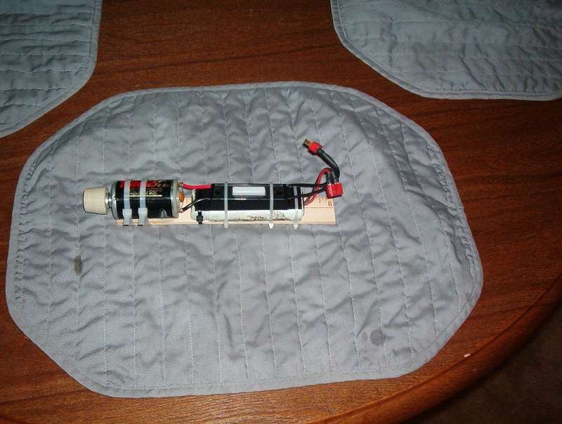

I think the drill will turn too slowly. If you don't have everything you need to make your own (r/c car battery,charger, motor, switch) I would buy a Sullivan 1/2A starter.
I made one from parts that I already had and used a motor from an old dustbuster...all I had to buy was a horn button switch. I made the prop cone with a wood paint brush handle (foam brush)and some 1/2 inch rubber hose over that.
It works great!

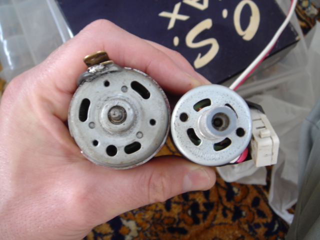

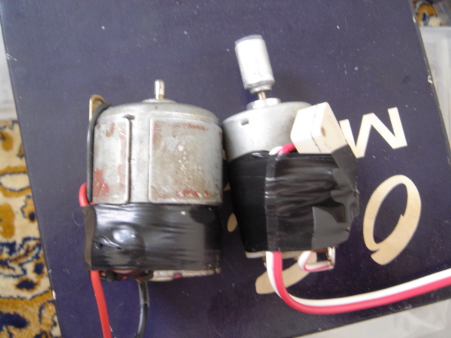

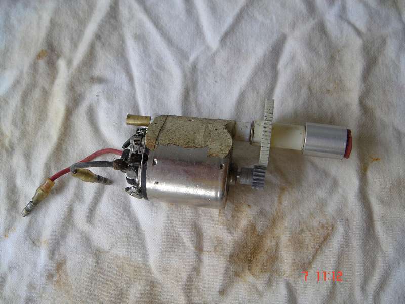

I have made three versions- The first using a 540 size car motor with a 1:3 reduction ratio- This worked VERY well- the battery would last for ages.
The second was a direct drive onto a 540 dustbuster motor- but this really did not have enough torque- even on 9.6V to start my V.A 049 reliably, and it chewed through the batterys.
The last version uses a motor from a makita cordless drill- which is bigger and has much more torque than the 540 motor-it probablyis not as good a solution as the geared 540 as it uses quite a bit of juice too- but i does start my V.A and norvel .074 and it was easy to bang a few wires on it and an adapter!
J.M

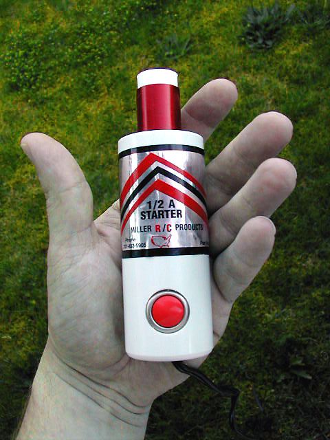

I don't think that a cordless drill will spin fast enough and it would probably have enough torque to break the con-rod if you had a hydraulic lock.
I have a Sullivan 1/2A starter and a Miller RC 1/2A Starter. I like the Miller starter much better.

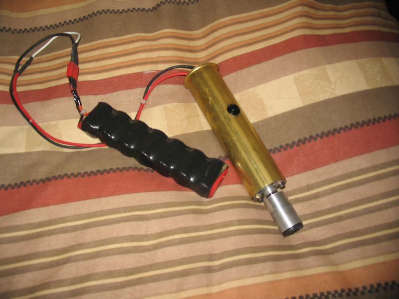

I used a Mabuchi 550 from an old Airtronics glider kit.The brass sleeve is from the plumbing section of a hardware store.

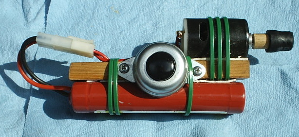

Well what the heck ,might as well post a pic of mine. 550 motor, 7 cell nicd, doorbell button, the rubber cone is a sig heicopter adapter.
Darren
