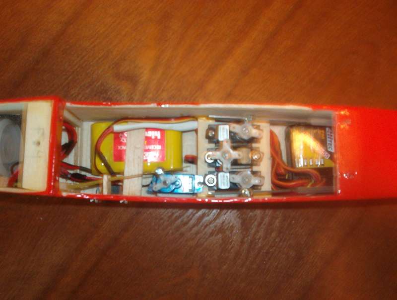

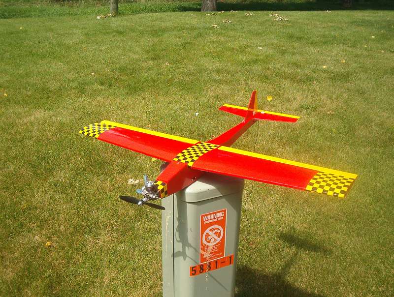

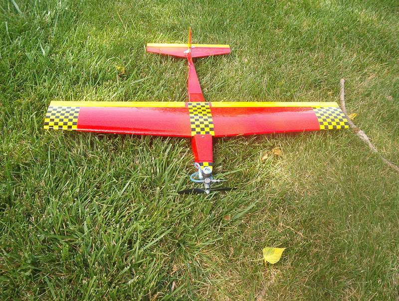

Here's my ACE 400, going to maiden her tommorow. I'd like to try today but theres been alot of lightning about.
Norvell .061 w/cox 6x3 rubberduckey
Film Tank
four channel

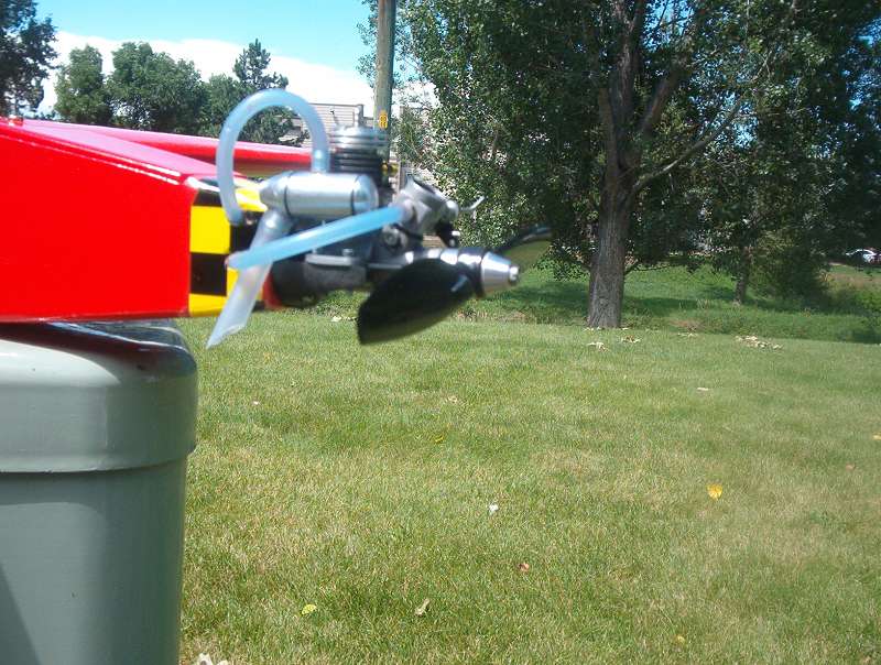

I Found some Dubro 5/32 ID silicone tubing for an exhaust deflector.

Lynn, I did use the stock alerons. I thought about making them bigger to increase the wing area per your suggestion but didn't. We'll see how it flys. I can always cut them off and put larger ones on. It did come in a little heavy at almost 15 oz.

Well I just got back from the madien flight trip to the park and all went well. The plane flies great. A couple of trim passes and it was off to the races. The .061 has plenty of power for this plane even at 15oz. It would be even better if I could get the thing to run right. The carb needs some modification to seal some air leaks. One thing I would do differently on the build (especially if you don't have mixing capabilities on your radio) is build the wing with 0 dehidral. The plane experiences a large amount of roll coupling when rudder is used for knife edge flight.
