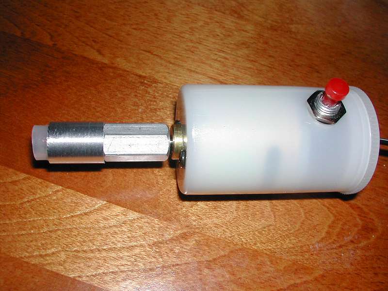

My Miller 1/2A starter has too much torque for my .020 and .010 engines, so I made a little starter.
It consists of a 12V motor from Radio Shack, an electric prop adapter, an aluminum cone that I made on my lathe and a piece of Norvel silicone exhaust tubing. It is all housed in a Fuji film canister.
RE: 1/4A & 1/8A starter
The part no is 273-255 12V DC High-Speed Hobby Motor.
It is $4.29 USD at [link=http://www.radioshack.com/product.asp?catalog%5Fname=CTLG&product%5Fid=273-255]radioshack.com[/link] or $4.99 CAD ad [link=http://www.radioshack.ca/estore/Product.aspx?language=en-CA&product=2730255&category=Motors&catalog=RadioShack]radioshack.ca[/link]
I selected this motor because it is 12V and I can run it off of my field box battery.
The switch is part no 275-1547 .5A SPST NO push button.

I just checked the current draw and it is 2.7A when turning over an .020, so the switch might be a little light, but it's only run for a few seconds at a time.
Hi Andrew --
Very neat package -- I've got to find someone with a lathe and buy him a beer or two!!!
Have you tried it on either an .049 or .061? When you were shopping around at Radio Shack, did you notice any other motors that might be of sufficient torque for the 1/2 A's?

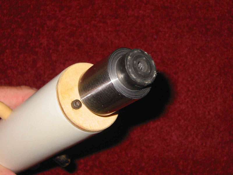

Hi BipeFlyer,
You say the Miller has too much torque for .010 and .020? What are the recommended RPM and torque settings to start an .010 or .020, how do you test the torque of a starter? Reason I ask, I have a Miller that I planned to run off a 10 cell NICAD pack for .010 and .020, in addition to a homemade starter. Here are some pics and specs of my 1/2a starter, made for me by a hobby shop owner back in Dallas.
Specs:
Old 480 Mabuchi can motor
4.8v 600 mah Nicad
DPDT switch from Radio Shack
PVC
Heater hose for starting cone
Aluminum adapter (cut on lathe)
I think that 540 motors are used in most 1/2A starters; at least in the Miller, Sullivan and Astro Flight starters that I've seen anyways.
Here's one at [link=http://www2.towerhobbies.com/cgi-bin/wti0001p?&I=LXGGA8&P=7]Tower[/link]
Of course you'll want something that can handle 12V. This one at [link=http://www.allelectronics.com/cgi-bin/category.cgi?category=search&item=DCM-216&type=store]allelectronics.com[/link] should do the trick. It looks like they have a little motor similar to the one I used, [link=http://www.allelectronics.com/cgi-bin/category.cgi?category=search&item=DCM-141&type=store]click here[/link].
ORIGINAL: SeanT
Hi BipeFlyer,
[img][/img]
Hi BipeFlyer,
[img][/img]
How do you test the torque of a starter? I just tested it on different engines. This one can spin an .020 easily, but it can't turn over an .049. How much torque? Just enough to spin the motor. How fast? Fast enough to start it.
Sorry if the answers are a bit simplistic, but I didn't do anything very scientific. I just know that less torque is safer and more RPMs works better for starting smaller engines.
I just tested it out on a PeeWee and it works perfect. Just barely enough power to turn the engine over when it is up against compression. I only need to hold it on for less than a second.
I don't like the starter springs. After a lot of use they create noticeable wear on the carb body and aluminum piece in front it.
The little starter I posted above is pretty high RPM - a lot more than a standard starter - without enough torque to turn over a locked up .020. I always prime then turn an engine over 2 or 3 times by hand before staring, regardless of the engine size or whether I am hand starting or using a starter.
