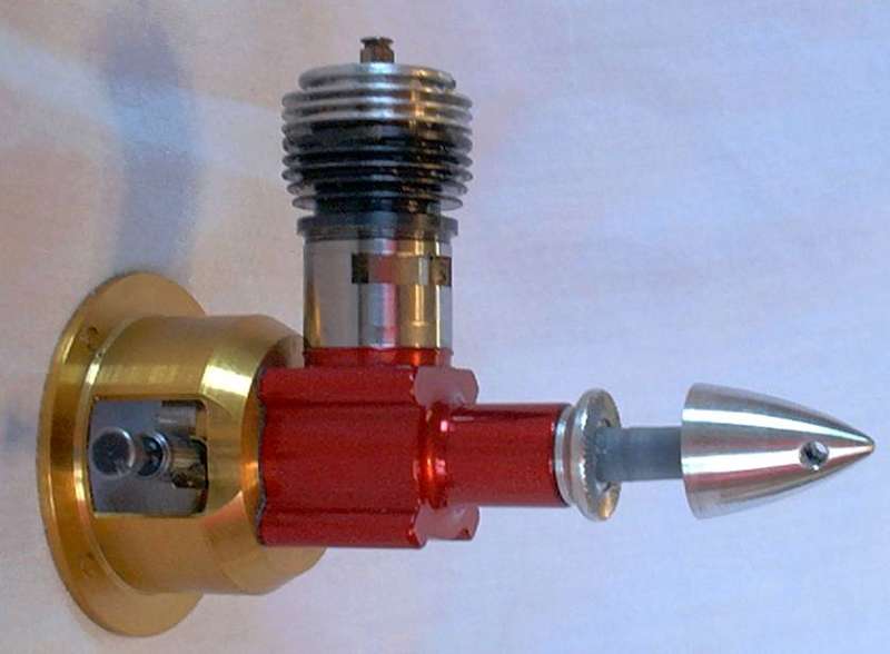

So I had a batch of anodizing to run so I threw some of my parts in while I was at it. This is the finished Sniper DR(disk rotor) .049. This is my second proto using my new milling machine. This engine was happy making 18,200 rpm on a black Cox 5x3 on 20%nitro. It will turn a Cox black 6x3 at 15,000. It is a very easy engine to start and I was hand flipping it 90% of the time. This was in 30 degree temps while it was snowing/sleeting here yesterday.

Very nice! It looks like it's hooked up to a LAKEWOOD SCATTERSHIELD!

That engine looks GREAT !!!... Let me know when you get something ready for testing....!!!

OK... so I have been messing with this engine alot over the last week. Final tach numbers as of Friday night was 20,100rpm on a APC 5x3 running a brand new #1 cylinder/piston( twin bypass NOT TD), regular glow head with 1 head gasket on SIG Champion 10% nitro all castor, either 20 or 25% lube. After reading over my old "Norvel Killer" thread I remebered AJC's chart about intake timing, Japman thought that the little engines would be happier with the intake closing sooner than 30/35degrees ATDC due to the short intake track they have. I made a rotor( it sure is nice to just be able to make a different rotor than a new crank) with the intake closing 20degrees ATDC. The engine HATED it and barely ran at all..go figure! I will go the other way when I can make a different rotor this week with 40 degrees in it.
So I mounted the engine up yesterday afternoon to my Sniper(last years contest plane). I have a balloon tank in this plane still from when I was running my reedies on it. The engine would start very well and run solid till I tosed it at launch then it would just flat out die. Two or three times of that and I knew something was up with the fuel draw. I changed to a smaller venturi and that helped. I got in a couple three flights. I was launching it a few clicks rich thinking it will lean out as the prop unloads in the air. Well every time it would richen after launch. It still had a ton of power and ran solid though alittle rich. Late last night I took the plane apart and realized the pickup on the balloon tank was maybe almost 1/2" higher than the needle ..DUH! So that was most likely a big part of the problem. This would also be the reason I flooded the engine a few times..DUH again. So I'll re-rig the balloon tank and run her some more.

I wanted to know how what you did with regard to the length of the crankpin? Earlier you said that you had shaved the connecting rod so you could hook up to the drum, but then I thought you said you were going to try to extend the crank pin, so what did you finally wind up doing?

Well so far I have just narrowed the bottom of the rod. So far so good. Friday night I ran it for a good 25 minutes straight, filling the tank before it was empty. I was figuring that if something was going to break that was the time
