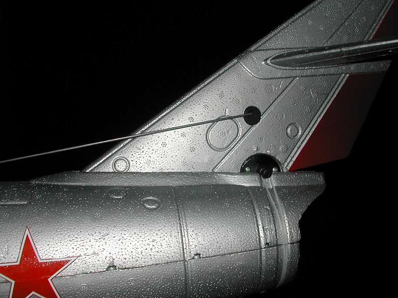

Can someone please explain or provide pictures of neutral elevator position? I'm almost ready for maiden, and I'm not quite sure what the [instructions?] are trying to communicate.

The bottom of the circle near the front of the V-stab is supposed to be just touching the top of the fuselage.
Here's a picture of mine at the neutral position.

Ok, thanks. I thought so, but the elevator looks like it's not quite level in that position.
