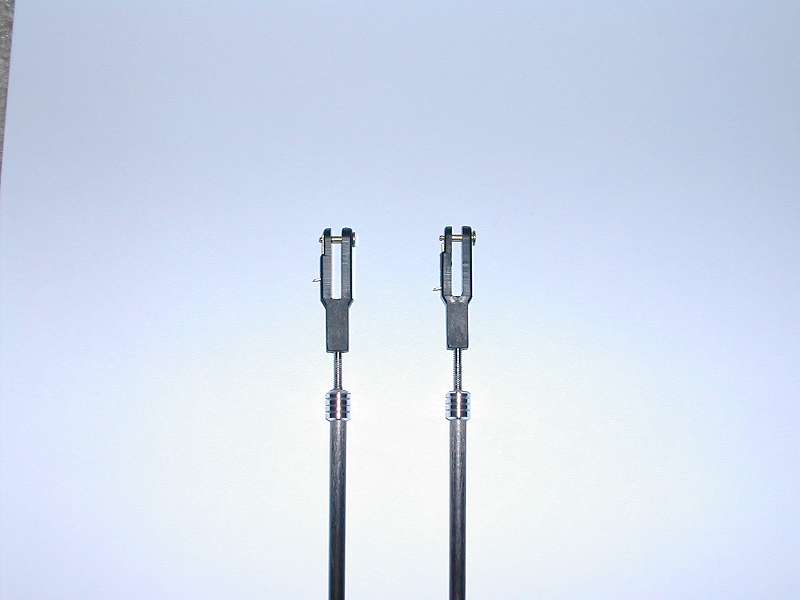

I've been using carbon fiber rod for pushrods lately. For the 1/2A stuff, I use .070 solid rod epoxied to brass ferrels. On short runs, they work without support, but need a midlength guide to prevent bowing on longer runs. There is essentially zero stretch. However, the rod is too light to use on .15 sized and up.
1/8" OD pultruded tubing seems to be about right with sufficient stiffness for larger models. However, I wasn't sure how well I could get the 1/16" wire to adhere in the ends or what might be the best adhesive. So the experiment ---
Pultruded CF Tubing: Purchased from Kitebuilder.com
OD: .125
Grams: 10.13
Length: 48"
Price: 2.95

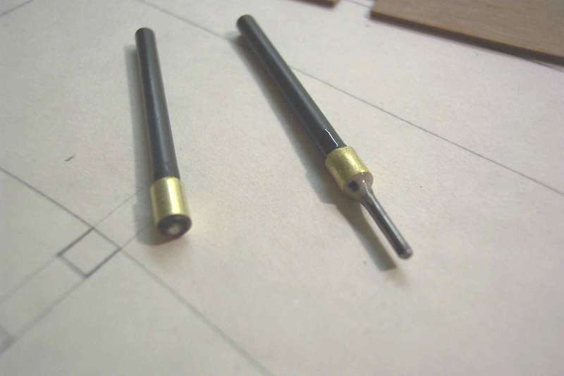

I prepped the CF tubing with acetone wiping the outside and using an acetone soaked balse stick to swab the inside. I roughed up 1/16" wire with 80 grit and wiped with acetone. Brass ferrels about 3/16" long were cut and prepped. I made up two test rods, one using Elmers ProBond polyurethane and the second with 30 minute Hobby Poxy II. The wire was inserted 3/4" in both and both cured 24 hours.
I drilled a 1/8" hole in a 2x2 deep enough so that about 1/4" of tubing below the ferrel was exposed -- I wanted to see how well the wire was retained and not break the rod off. I set the 2x2 on a scale and pushed down on the wire end with a steel plate. At about 80 pounds, the epoxied wire was slowly pushed into the rod -- it was not an immediate breakdown, just slid in. I was able to load the ProBond up to 130 pounds, but it held.
Frankly, I was surprised that the ProBond beat the epoxy and that it held up at 130 pounds (tested it twice at 120 and once at 130). Bottom line is that either adhesive will produce a bond strength greater than any of the other parts on the model can withstand.
Since CombatPigg has his Thrust-O-Meter, I guess I can label my bathroom scale a Push-O-Meter.

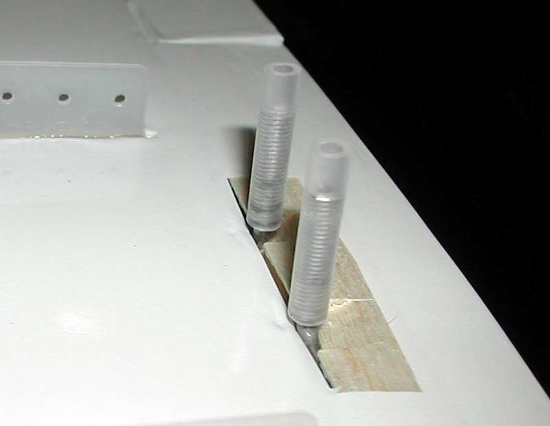

DuBro makes the nylon connectors for 2-56, but you have to buy the whole torque rod set to get them. I've been using a piece of inner ny-rod with a hole drilled in it for 2-56 torque rods. Here's a pic of what they look like before the holes are drilled.

Thanks for showing me that and confirming that the 2-56 knuckles are history. I bought a SIG nylon C/L bellcrank and have been making my own knuckles out of it. I just put on my best pair of glasses and hack the pieces out with a razor saw, and drill and tap the material. The park flyer hardware is too small, and the 1/2A aileron hook up kit costs more than what I have invested in most of my planes!

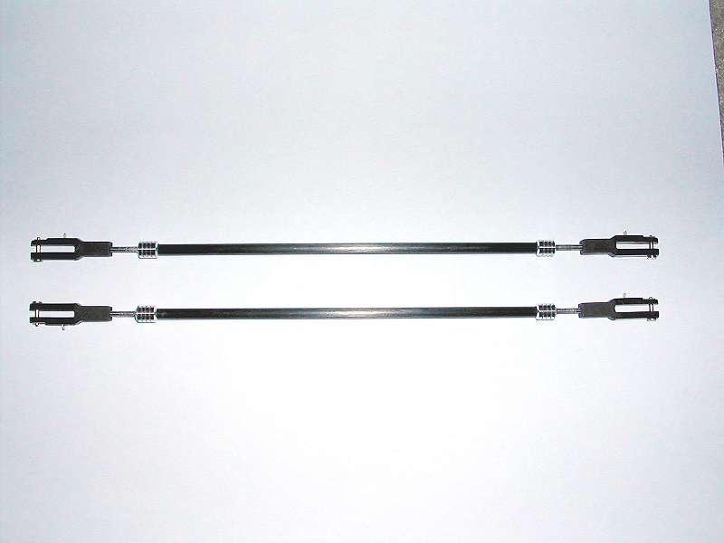

I made up my aileron interconnects today using the same size CF tube that Andrew used. Since these are less than 9" long, and for the sake of simplicity, I ran a piece of stainless 2-56 threaded rod all the way through. I figured that a couple of extra grams wouldn't hurt on a .40 sized model and I wouldn't have to worry about it being able to pull out. I didn't have any aluminum or brass tubing in the right size so I made aluminum ferrules and glued everything together with CA.

Pull Test Update -- 6/5/05
I made up another pushrod -- 2" of pultruded 1/8" OD CF tube, 3/16" long brass ferrels, 1/16" wire pins. The wire was well roughed up and inserted 3/4". Everything was cleaned with acetone and one end was glued with Elmer's Probond (polyurethane that activates with water); I used JB Weld on the other end. The JB weld had set up about 43 hours; the ProBond has about 30 hours.
I could not manually pull the pins out. I wanted to have some sense of how much weight it would withstand, so I suspended a pair of vice-grips from a treelimb, snapped a second pair on the other end of the pushrod and stood on a scale. I weigh 210 -- so I pulled on the pushrod until the scale read 100 pounds -- I'm assuming that the rod was carrying about 110 pounds of pull. I figured if something broke, I could have a face full of vice-grip so I stopped. I loaded the rod to 110 pounds twice.
Results:
30 min. epoxy failed at 80 pounds of push.
ProBond loaded to 130 pounds of push without failure (a check showed no plug of ProBond behind the wire -- good point by Bipe)
JB Weld and ProBond did not fail at 110 pounds of pull.
So, with a little care in cleaning and surface prep, either JB Weld or ProBond joints will give adhesion strength greater than the structural strength of most of our planes. I'm very impressed with the performance of ProBond -- one part and easy cleanup. One note of caution: Choose your carbon fiber tubing with an ID close to the wire size to avoid too much of an adhesive bridge.
