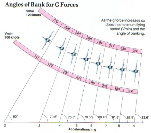

The scary thing to consider though is that G forces build up in multiples of your original weight. Since this plane weighs so much more than the average SWR, hopefully the wood will just bend but not break. [

This talk about your wings coming off reminded me of the G-force charts I had seen. I'm sure these numbers are for a specific plane, but if you take a rough look at it your plane wing will have to hold about 8 lbs in a pylon turn.[:-]

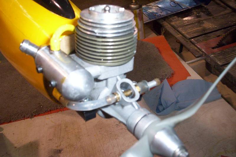

Got a little data on the .074. This one doesn't have much POP, it needs to be electric started, but the bottom end seems OK.
Stock muffler 7x3 APC 15% nitro BYRONS' 17,200 rpm
Open exhaust " " " " " " 17,500 rpm
" " 5x4 fiberglass prop [LARRY D]26,000 rpm
There doesn't seem like much point in going further with testing until the props from APC get here. There also doesn't seem like much reason to touch the engine either, it seems very happy running high revs, the last reading was slightly rich, like a good launch rpm. This set up would generate 98 mph and 1.25 pounds of thrust, if it hooks up to the airframe. So far, so good

OK FELLOW NORVELIANS back with some exhaustive test results. The carburetor was ditched and replaced with a little NVA that came with either a STELS or early VA, a NORVEL C/L NVA would work just as well..... I opted to leave the muffler on because of the big gaping air hole in the crankcase that we're trying to pass off as an air inlet and it would probably not draw fuel well without muffler pressure. Same 15% fuel, the results are surprising [vs the stock carb].................................................. ..............................
5x4 C/F prop from LARRY D.........30,500.....4500 rpm improvement over the carb!.........
4.7x4.7 APC.....24,800 easy to needle, pretty good thrust too.....................................
5x5 APC...........20,800 Diameter Is The Enemy, Pitch Is Our Friend............................
5.5x4.5 APC......18,500 DITEPIOF , Russian word, [means the same as above]
I guess it's safe to say that the carb is restrictive, and that the C/F prop that LARRY sells looks like the hot set up. [I don't want LARRY to find out that this prop looks like the killer set up, or he might jack the price up on me a nickle or two.
] The 4.7x4.7 looks promising if it will launch the plane. Haven't had the head off or started playing with nitro yet, from experience the trade off with high nitro [40-60%] is only worth it if you are trying to keep up with everyone else. The NORVEL replacement parts are priced high enough to make you think twice about doing a major repair.
