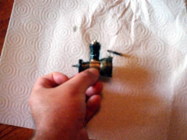

[8D] I have a bit of a problem with one of my older 1/2 A engines and I need some advice. I believe its a black widow type, .049 with a bypassed "attached to rear of motor", metal fuel tank. You know the little bowl shaped kind. Anyway, I was flying with it the other day and my engine performance became more and more erratic. I tried twisting the fuel tubing which surrounds the needle valve and which acts as a "sealer/extension". I noticed it ran erraticly but when I squeezed the tubing with pliers to adjust, it amped up and ran fine!! Ok I'm thinking needle valve air leak now! So I decided to remove the tubing from the end of the needle valve to see how it ran then. So I pull on the tubing, and out comes the needle valve, AND THE SLEEVE IT SCREWS INTO!!! What the!! So, I guess I found the air leak huh! First question is, how do I reinstall the thing? It has a little hole "port" in the side, which way should this point when I put it back in. Second, should I JB- Weld this thing back in or something? What do I use to keep it from popping out again? Any bright ideas will be much appreciated, cause I've never dealt with this issue before. Good thing it didn't fall out in mid flight, I'd never have found it!!
TIA ZZ.

ZZ, there might be some debate as to how you should secure the needle valve assy. back in. One thing is for sure, the parts have to be meticulously cleaned. Soaking in a jar of solvent that is taped to a orbital sander will sonic clean everything, or you can use a denture cleaner. Locktite has a formula for this application [permanent]. The little orifice should face the reed. I like to take it a step further and make an upper NV support that packs the NV seal tightly, so the needle is hard to turn. You will get very consistent runs this way.

Metal tank, metal backplate? Mine looks to be knurled like a press-in deal. Press it back in till there's about 1/64 sticking out. A tiny bit of locktite should help.

If a repair is going to be successful I suspect it'll need the Loctite or similar to bond the sleeve into place. The little hole in the side of that sleeve should probably line up with the hole in the backplates fuel line nipple. A bit of small sized music wire as a test probe to ensure alignment is probably a good idea. Be sure if you use Loctite or epoxy or whatever sealant that you use just a small smear and avoid it getting into the hole or into the needle valve area.
And ditto on the super clean prep first.

Whoa!! combattpig, shoving and cussing is one of MY first "go to's" in just about any repair job. Your a man after my own heart. I have to aplogize to you all for the truly crummy picture I'm about to post of the engine (larger blur) and the needle valve and sleeve (smaller longish blur). My digi cam is down right now and I had to use my brothers. Its resolution doesn't allow for really close shots and when something is this size, thats pretty much EVERY SHOT!!! If you can believe it, the one shown is the LEAST blurry of them all. Might give an idea of what type engine this is though. So as it stands my steps will be:
1 Clean all parts
2 Line up port in sleeve with reed valve, ie front of engine
3 Insert (FLUSH with surface?!) and glue with some sort of adhesive.
The sleeve has little vertical ridges, (I assume to grab the walls) and I guess I should smear whatever adhesive I use into these before pressing in.
Let me know wht you guys think.
Thanks ZZ

That's about it, ZZ. Make sure you scribe some kind of index mark, so you can line up the hole in the side of the NVA with the fuel inlet nipple, not the reed. If the NVA is real loose in there, then it is probably trash, because you'll have a hard time sealing off the lower end, without accidentally gumming something up. At any rate, you don't have much to lose by trying.

ZZ, I would use a tooth brush handle, or a piece of any hard metal to push it in. Wood could splinter and get inside. If it is too difficult to push all the way home with finger pressure, then I would pass the job onto a vise with smooth jaws. The back plate has a fuel inlet nipple cast into it, doesn't it? This is where the plastic fuel pick up line goes. If the little hole in the side of the NVA isn't lined up with this passage way, fuel won't be able to transfer into the NVA, flow past the tapered needle and finally dump into the air intake. Once you get those splines lined up, you are commited. I would not press it in with the NV in place.

[8D]Thanks CP. The deed is done. I saw what you meant after I removed the backplate. When I installed it I shined a bright light in the upper end of the assembly to be sure I could see light down through the port and aligned nipple, and it woked perfectly. I tapped it into place with a small hammer, and a soft flat wooden ruler as a"ding buffer". Looked to work perfectly. Thanks to all of you who posted here with helpfull remarks and hints. You all ROCK!
Anyway, during the process I found a BIG metal flake down in the sleeve cylinder shaft, it was almost clogging the entire port that the needle valve pokes through. Good thing I took you guys' recommendations and cleaned it all out well. I took a sewing pin a *****ed the little bugger out. MAN LOCKTITE IS EXPENSIVE!!!! $14.00 for a tube, from which I needed like two drops!! It cost more than the entire engine!! You gotta love 1/2A!!! Hmmmm, tube of locktite or two surestarts....tough call.LOL Well, you gotta do what you gotta do. By the way, anybody know how long it takes this stuff to cure completely before usage? I'll give you guys the final results of the operation once I get this thing stuck back in the AC and crank it up. Fingers crossed.
