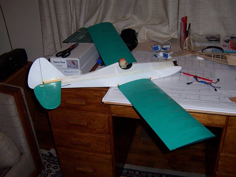

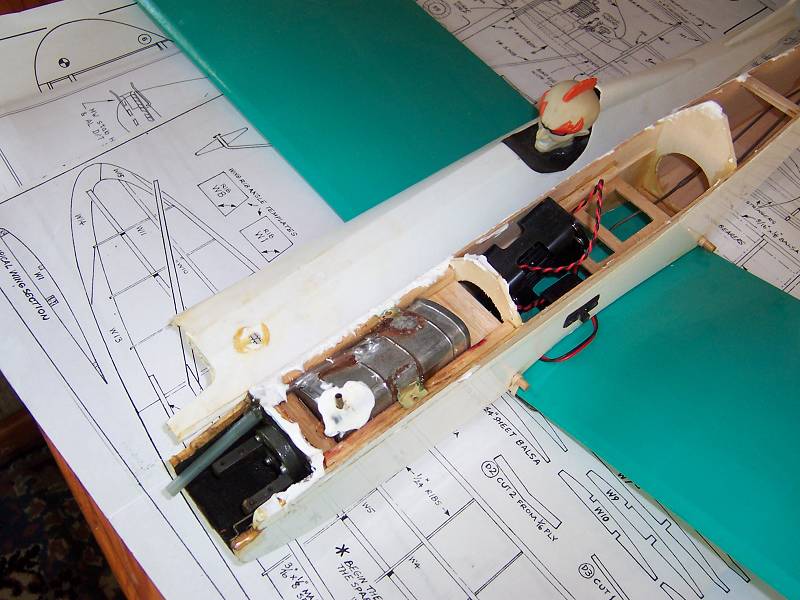

Old 02-19-2006 | 07:12 PM
Posts: 7,182
From: Burlington, NC
Default RE: Cox Mantis
okay so I started on the Mantis, wing is together but I have to put in a tank because of the bladder problem,,they made the bladder part of the ARF thing so since I have to use a tank I thought I'd go with my norvel .061 the problem is I have to raise the engine up higher than the cox would be and put the tank under the shelf they made for the bladder, its going to be tricky enough as there is no access panel, I've never had any pressure problems with norvels ,,the top half of the model is plastic so I dont want to cut it out for the muffler, wondering if the tank location is gonna be too low to work? Yeah I know I'll have to run it to figure it out, just seems like the engine is too high and the tank to low, wonder if the setup will work on the bench AND in the air?...Rog
Old 02-19-2006 | 09:41 PM
skaliwag's Avatar
Posts: 2,469
From: Corralitos CA
The top Plastic half is held on with a band of 1/2 inch Scotch tape... Just slit it and replace after you have made your mods to the shelf and other stuff.
Picture of top off and the old C/L tank installed
