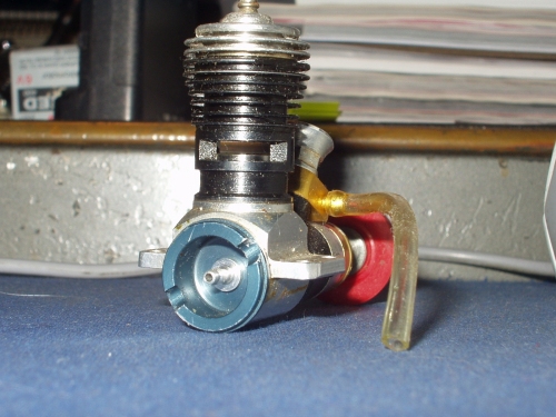

I was at a club Auction yesterday and had some extra $$ floating around in my wallet, so I picked up this TeeDee. The first thing that the astute observer will notice in the rear shot is a tap. I've never seen one on these engines, nor the blue anodized plate. Was this a pressure tap? And, if so, why not use the pressure tap that was available on the side of the engine case?

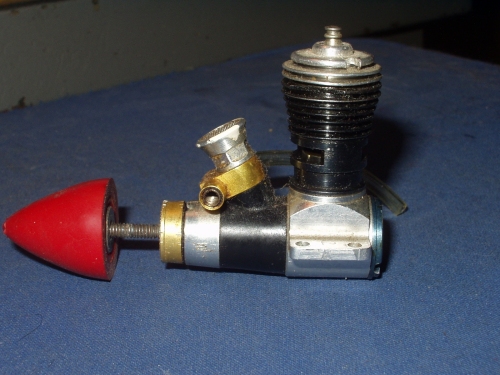

In the side shot, you'll notice that it does not have a Needle Valve or a Spring. Are these still available somewhere? And if so, where can I get one of them?

Either that, or I forgot to upload the photos.... Here, lemme try to get this right.... DUH!
And, it looks like the previous owner rotated the NVA around 180-degrees.

The only two parts you need are the fine thread needle and a galbreath head. Both are upgrades you'd want for a brand new TD. A new-in-box TD ain't worth it's weight in salt to me. A few upgrades and you have a fine engine.

That's a KK backplate. There were two kinds, red and blue. I think the blue did not have the one way valve and the red did, Or vice versa, TD's run best on pressure. I've never seen anyone use the tap on the crankshaft. You probably do need a fine thread needle. Incidentally, the TD 09 runs fine on backplate pressure with the stock needle.

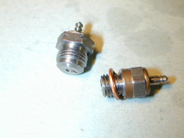

The Galbreath Head is a dropin replacement for the COX glowhead and uses a NELSON glowplug. Henry Nelson is the designer and manufacturer of the NELSON pylon engines. The NELSON plug face is chamfered and seats on the bottom of the plug rather on a compression washer like a standard glowplug. The head and plugs can be purchased from Larry Driskill at [link=http://www.kittingittogether.com]Kitting It Together[/link]. One advantage to the Galbreath/Nelson combination is that the plugs run about $3.25 apiece and are very long lasting. The big advantage is that this is one of the only combinations that will maintain or boost rpm on a COX or NORVEL and use a standard plug. With replacement heads running $9.00 or so, it's a money saver and power booster. The NELSON thread is 11/32 x 32 and will not fit a standard engine.

Andrew, your post jogged my memory that I've been putting off ordering a Galbreath head and some Nelson plugs. Larry's site shows three flavors of plugs. I would guess that for sport flying with 25% nitro the STD would be the one that I want? Anyone care to comment?
Tanks in advance,
Al
Old 03-07-2006 | 12:43 AM
Joined: Feb 2003
Posts: 3,215
From: Murray, KY
Default RE: Help recognizing/Rebuilding a TeeDee?
ORIGINAL: Big Al-RCU
Tanks in advance,
Al
AL --
If I remember correctly, I believe Larry posted that the STD plug is being phased out of production in favor of the HD. The HD is supposed to be better for all types of flying and should work well for you. I have both, but can't really tell a difference in performance. They look the same to me except the HD has notches.
