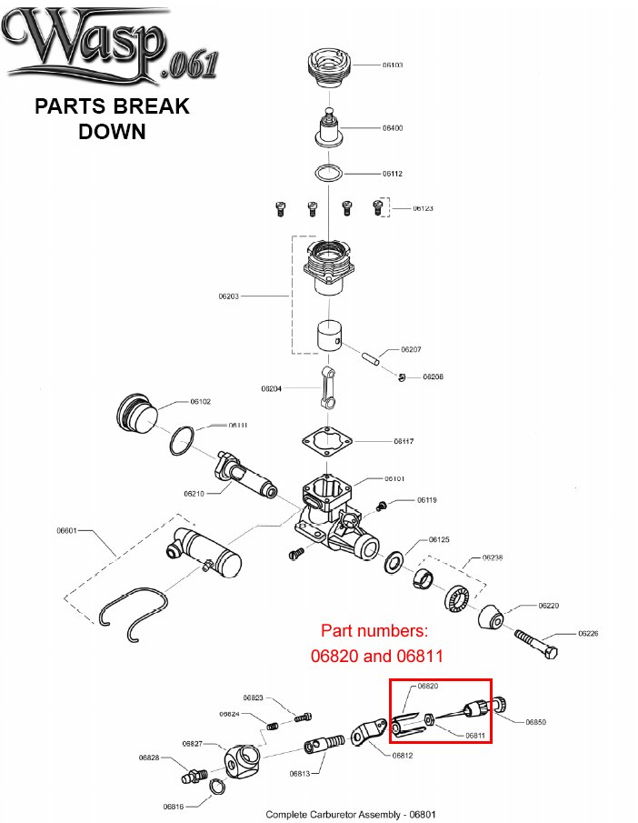

Since parts are short on supply, does anyone know if any of the AP engine (looks just like a Norvel) parts would fit a AME .061. I broke the spring clip for the needle and rounded the retainer nut.
