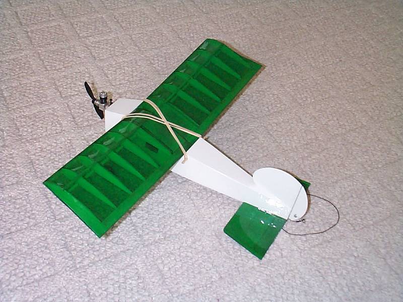

Kinda depends. If you wanna fly 'em single channel/RO, probably the TD .010 might be the most fun or maybe a Pee Wee .020 because it will climb and fly slower. But you'll need to build light - particularly for the .010.
If you want more speed and the ability to carry more servos for rudder and elevator control, the TD .020 will likely satisfy where the .010 would be marginal. (I've had a couple of 2-channel Littlest Sticks powered with .010s. They did OK but not as "frisky" as Bobhh's TD .020 Wee Stick. My electrified Wee Stick flies darn good).

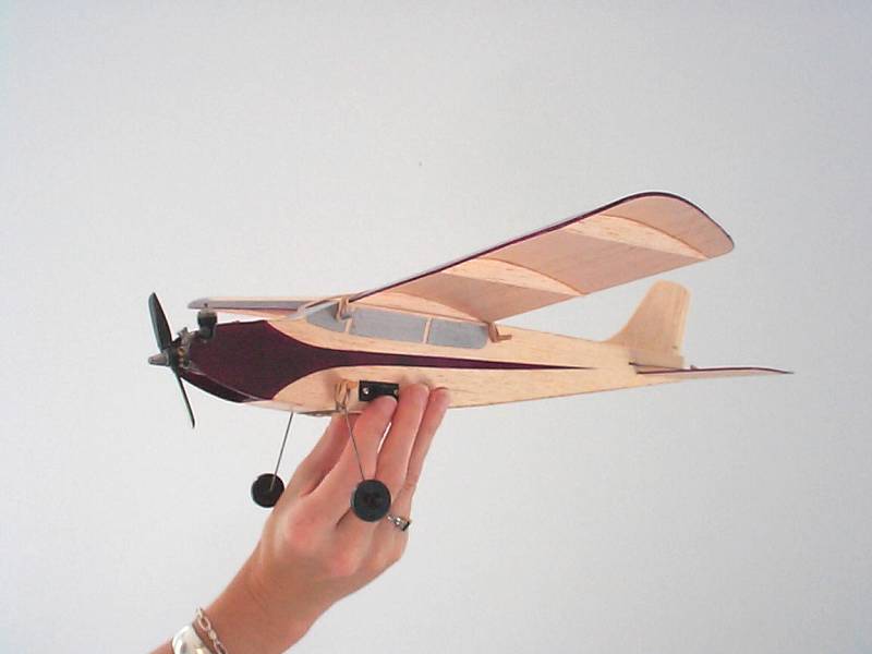

Like our famous Raymond says the Wee Stick is a throw off of the Littliest Stick by Ace. Originally set up for single channel pulser with Tee Dee .010. It will fly with 2 servos and a Tee Dee .010 well but the .020 will give better response. I have a Wee Stick with a Baby Bee .020 that is single channel and is quite hot. My original Wee Stick with 4 channels and Tee Dee .020 is a rocket and a ball to fly! The Page Boy is a bit smaller and the Tee Dee .010 flies it great with 2 channels and GWS receiver. Both have a gazillion flights and will be at the 1/2a flyin again next month!! Come on down and give them a try!!

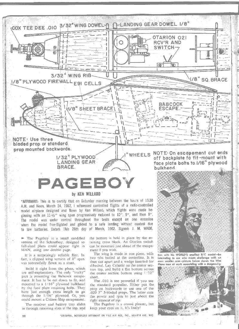

Having built several Pageboys I can relate my experience. All were built per Ken Willard’s original plans as published in MAN, i.e. single channel, same down thrust, incidence, etc. Ken didn’t state an all up weight in his article but the super-regen Otarion receiver and rubber band escapement was light weight even by today’s standards. He stated that the .010 was too powerful for the Pageboy so he suggested that the prop be installed backwards or else use the 3-bladed .020 prop to cut down the zip. Unfortunately the postage stamp sized Otarion was soon rendered useless (interference caused by the CB craze) and so I used the newer but HEAVER proportional super-het Ace Commander/Adams Baby actuator on the first one. The increased wing loading meant that it had to be flown with kid gloves to avoid a stall and the inevitable spin to terra firma. However with the .010 peaked and with a little altitude, a two turn spin (to build up airspeed) would allow it to loop, do consecutive rolls, etc. LOTS of fun back when most guys considered .010 R/C not just a novelty but impossible! Especially with rudder only. A real crowd pleaser. I was hooked.
Fast forward 40 years.
With today’s micro gear a Pageboy should come in at about 4.0 to 4.2 oz. At that weight you have a Tiger by the tail. I doubt that even Ken could fly it with the old rubber band escapement without restricting the .010. It will do consecutive loops while GAINING altitude right from launch. With proportional rudder it is (barely) controllable as long as you are one jump ahead of it. I guarantee a real blast just for the price of some balsa from the scrap box. Try one.
Oh, by the way Dewey, if you are thinking rudder only then needless to say the .020 would be way too much. I have never tried one with multi-channel. But that isn’t what it was designed for.

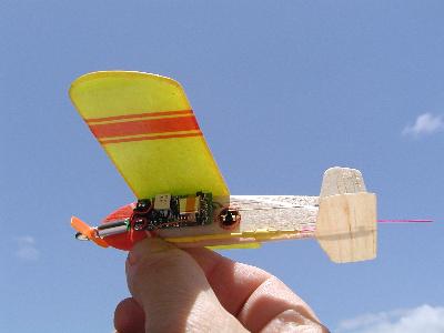

Raymond, the 14" 3d fuse model would suit your gear , the profile plan uses magnetic actuators, as does the MiMi pictured above.
The GM plans, and MicroMite-7 3/4" can be dounloaded from the Bradleys site :- http://www.parmodels.com/ralphs_models.htm the MiMi (mini mite) 5" span,flying weight 9grams. I think was posted on rcgroups , theres a thread in the indoor n micro models section.
