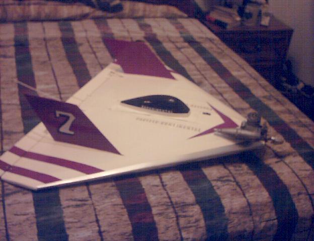

Default fast!!!
pic

Is that a Scande demon?

Yaa,Das Maybe Rite Heir Foamy, or maybe Das Secret Weapon,

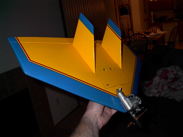

Laser Models Arrow: Flight testing so far has been:
Flight 1) Centrtifugal forces allow fuel tank to tear through hatch in bottom of plane.
Flight 2) Fuel starvation from similar forces cause flame out.
Flight 3) While preparing for launch, plane tears out of my hand and almost give me poopy pants. Spray bar on engine cracks off.
Flight 4) Wait for Dad to help me

I think on most deltas the tanks are to low and that aids in the fuel starvtion, my holy smoke has the tank higher than most and has no problems. I am thinking I may go to timed crank case pressure so I can lean it out more on the demon, and yes you will use both sides of your underpants with these planes!!! nice Arrow what eng. you using

This one actually belongs in the melted monokote forum, it's got a enya .60 phase III. Unfortunately my demon suffered a radio hit from about 500 ft that stripped 2 servos and burned straight in at full speed. Oh well, my fault for using an AM hitec focus 3.
