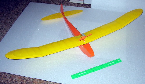

If some one has one ... How aboiut a picture.

I'll try to upload a picture........Dave

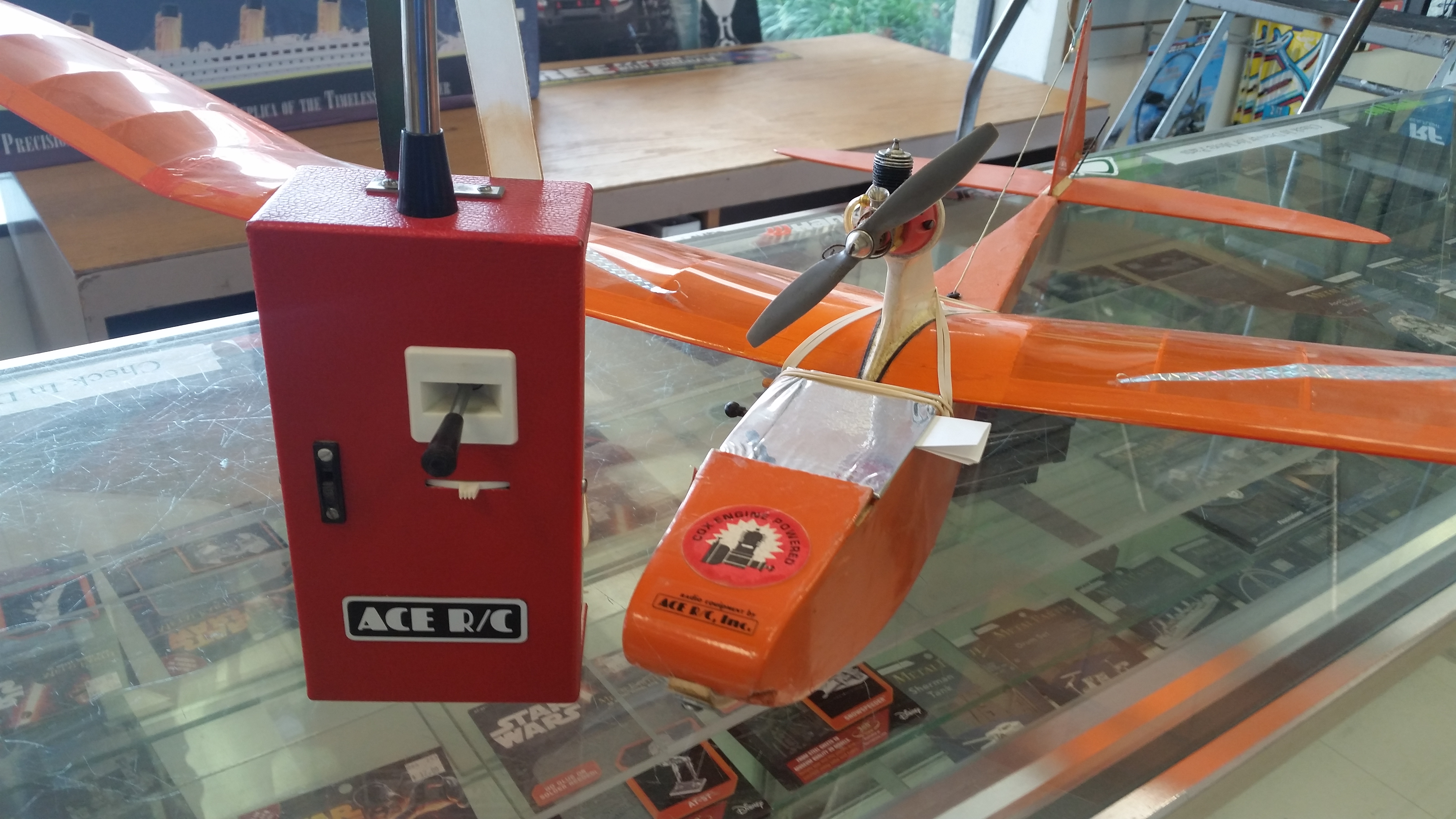

I know this is a really old thread, but I recently purchased this Nomad at the LHS, it was hanging on the ceiling there on consignment. Came with a TD .020 and an Ace R/O system. Notice the sales receipt tucked under the hatch.. it was already mine at this point.
I've swapped the TD for a Park 280 motor, 10A ESC. Installed a Savox SH-0350 servo in place of the actuator, but am using the original torque rod to drive the rudder. It'll have a Spektrum AR400 RX, probably a 500 mah or so battery - or a little bigger if needed to balance it.
Should be fun, on those rare days in Kansas when the wind's not blowing too hard!
The .020 has been cleaned up and stored, it's not going away. For now, it'll be e-power so I can put it in the car with minimal support equipment, and maybe stop at the flying field on the way home from work when the sun starts staying up a little longer.
I also just scored a copy of the original August-September 1961 Flying Models magazine with the Nomad published in it. Should be a fun read!

I built a House of Balsa Nomad back in the 1980's, but made the fatal mistake of using Monokote for covering all over the plane, big mistake, made it too heavy to fly, Tee Dee .020 struggled to pull it in the air. It became a shelf item, until succumbed to moving damage.
Had I covered the wings with clear doped light silk and clear doped the wood surfaces with color trim, it would have been light and flew well. Wing was designed for silk or silkspan, provides tautness and strength. Good discussion in another forum, else needs a hardwood spar or wing will snap. With a spar a lightweight covering like Polyspan or Coverite Coverlite would work.

this one is right at 10 oz with the motor, battery, radio installed. Considering the original back in 1961 was about 9.5 oz, that's not too bad.

Good for you. Restoring an old classic back to flying condition certainly deserves kudos. I hope the Kansas winds are kind. The wing design is a little on the light side, but a calm afternoon should give you lots of fun.
