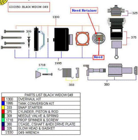

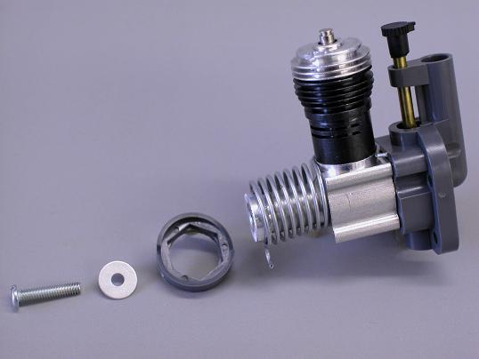

hi im new to this stuff. I just got a 049 surestart engine from a guy and he said it doesn't have a reed valve.
Does it need this to run? []

Yes a surestart needs a reed to run, you can cut 1 from a floppy disk.
To make a Reed , first cut a circle that fits neatly but loosly inside of the reed retainer- ie it falls out easily. then cut the sides off the disk to look like the 1 in the picture- note it must still be wide enough to cover the raised circular flange on the back plate or it wont seal.
Stewart

The reed controls the fuel and air that enters the engine. As the piston goes up, the reed opens and a vacuum in the crankcase pulls air and fuel in. As the piston goes down, the reed closes and creates pressure. At a point the piston uncovers bypass ports that allow the mixture of fuel and air to be pushed to the upper part of the cylinder.

hey, that thing about cutting out a reed from a floppy disk worked!!! 2 flicks of the prop and she fired up!!!!
