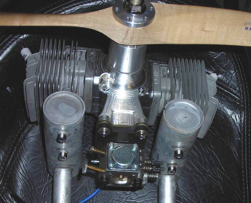

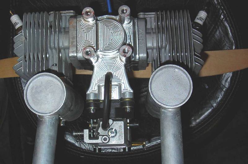

Yea, the reeds are downstream from the carb, so I see no problem having both. I've got a 52cc twin that has reed valves in a dog house under the crankcase.
ID:	572656   Click image for larger version
