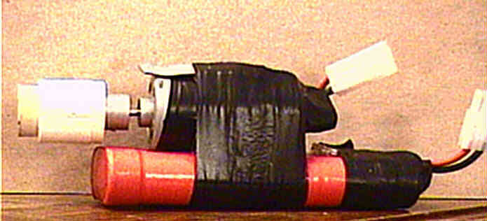

I use to have this page up on my website, but I haven't had that site for a couple of years now. Anyways, here's a homemade starter.
Before we get started, I know we've all seen construction articles in our favorite magazines on how to stuff a car motor and a battery pack into a cylinder of PVC or cardboard. These methods are nice, but I like the simpler things in life. Club member Danny Drennon cut through the quick on this one. He too uses a 6 cell car pack along with the Sullivan 1/2A starter cone. He found that the Sullivan cone fits perfectly into a 1/2 inch PVC cap that in turn is screwed to a prop adapter for a 05 can motor. The prop adapter is only a couple of bucks and the can motor, which doesn't need to be an expensive unit, can be had under 20. The battery pack is also priced around $15. Buy a pair of Female Tamiya connectors, the battery will probably come with the male side on it. You'll use one to hook to the motor and the other to charge the battery with. The rest of Danny's starter can probably be had around your house. Me, I had to buy the cone, the cap and the prop adapter, the rest I had on hand. Here's a drawing of the completed starter
ID:	608780   Click image for larger version

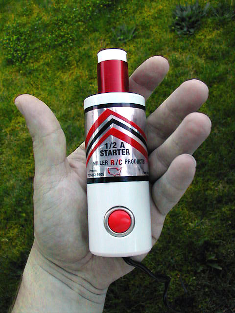

ORIGINAL: digital_trucker
Where does one get a Miller starter?
Miller R/C Products
159 GREENE STREET
PO BOX 425
KENWOOD, CA 95452
PHONE: 707-833-5905
I've attached a picture so you can see what one looks like.
