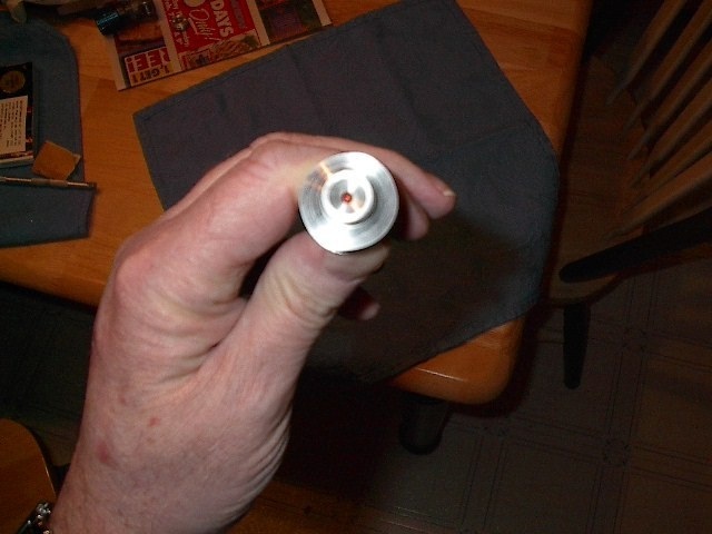

Well I have just about finished this custom head for my norvel, It is 5 fin like the (oh god can I say It) cox texaco which I always used on my high nitro runs but at ten bucks each I wanted something that would take a short std. plug, so I came up with this, It will take a stock Norvel plug also the custom adpt. has the shape and volume as a cox high comp. hd. and can be either high or low adj. for comp. pic. shows the 3 fin stocker to the right, and the fins each have more area on then,

top pic with plug

plug holder is blind to the end of plug as to not affect shape and compression, here it is lit
