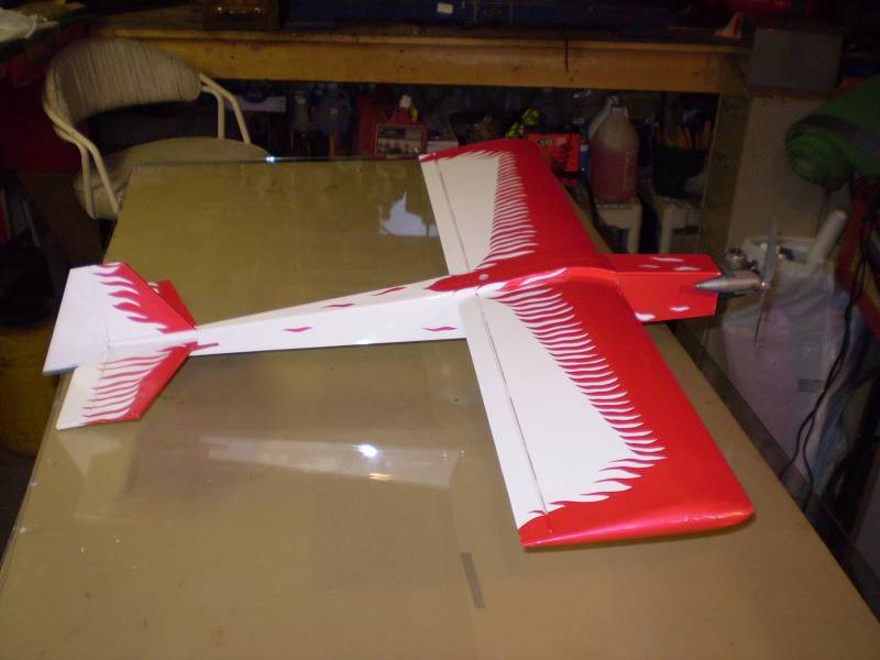

Howdie gents. thought I should show you what this fourm started. I have been watching this thread for about a year now. I have been modeling for about fourty years and was starting to get bord then I came acrosed this fourm. Well the juieses started pumping and this is what hapened. I call it Zip. ws.. 34.5 in. .09 cox. auw.. 22.4 oz.

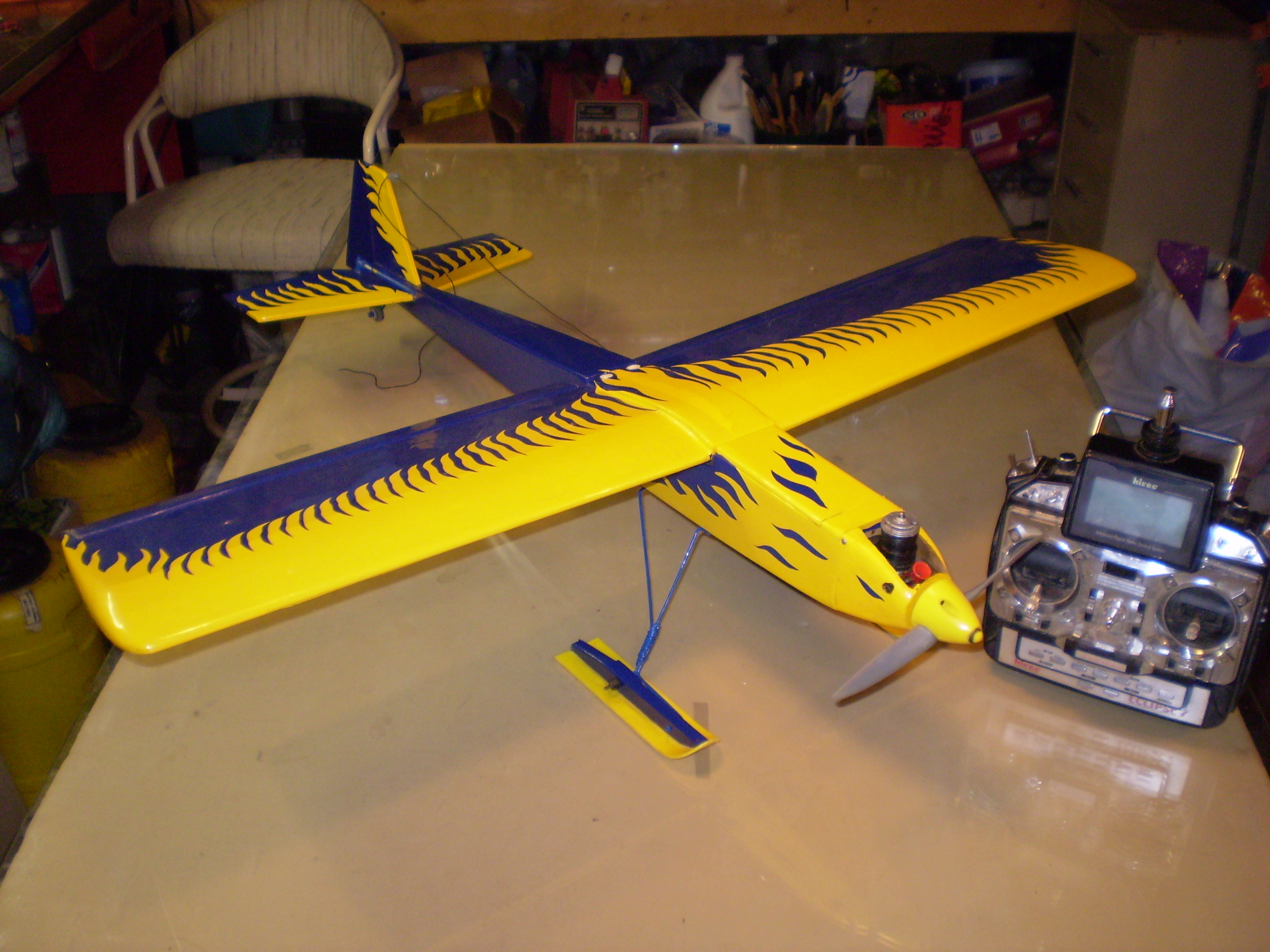

Howdie gents. thank you for the kind words. yes I have some pics. I tryed to post with opening but I messed it up some how. I took her to the lake twice but could not get a reliable eng run. I replaste the cox with a os 10.. 7x5 apc. It took about 15ft to lift of then climed out at about a 70deg angle for about 200ft then leveled out to trim her. 4 clicks left ail. 4clicks down. She goes over 80+mph. she tracks like the alatra sport. She flew so nice I had to build an other one. The new one has a 36.5 inch wing. Ok heres some more pic. enjoy.

Well it seems that I canonly send one pic ay a time . got to addjust some thing. Ok how aboutone with her close off?

I found a pic of the ultra stick. Yes they do look a lot alike. I tryed not to look to much like any thing like another plane but I gess form follows function. The frist draft I had it as a low wing then I saw the new pulse xt.so I started over. I guess its getting harder and harder to make some thing that doesnt look like some thing else. I made this for high speed to handle the wind. and it does fly nice in the wind. On the maiden flight of the red and white one I took it out on the lake the wind had blown the snow off so it was smooth ice I dident need the skies. there was a 7to 10 mph wind . as sone as she lifted off the wind about knocked me off my feet. About 35-40mph, she went up about 300 ft and was blown back about a1000ft. I got her pulled out of the loop with about six ft to spare. I got her back to me then landed. I keeped about half throtle and she sat there till I could pick her up. whew!! seconds later the wind lifted , but it was just above the tree tops so I did not go up agin. hkbii

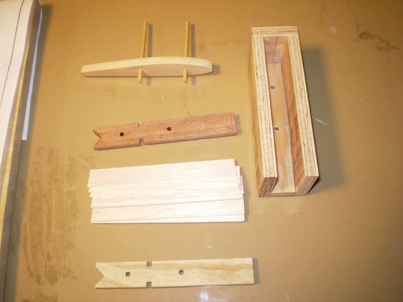

Howdie gents, I'm back to working on Zip. I had to redraw the plans ( long story and not worth reading) I am now going to build one to write up a manuale. I have built a router table and built a bunch of jigs. I will build this one on a balsa building board with the plans taped to it. after this one I'm going to build a wing jig so I can crank out a bunch of them. Here ar some picks. This is to cut the ribs out. Cut to length.hkbii

Now cut to width. hkbii.

Now I'll put the blanks in a jig to drill holes. hkbii.

With the dowls inplace its off to the routers. hkbii
