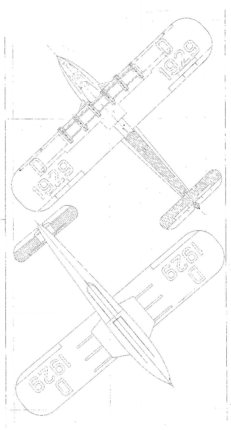

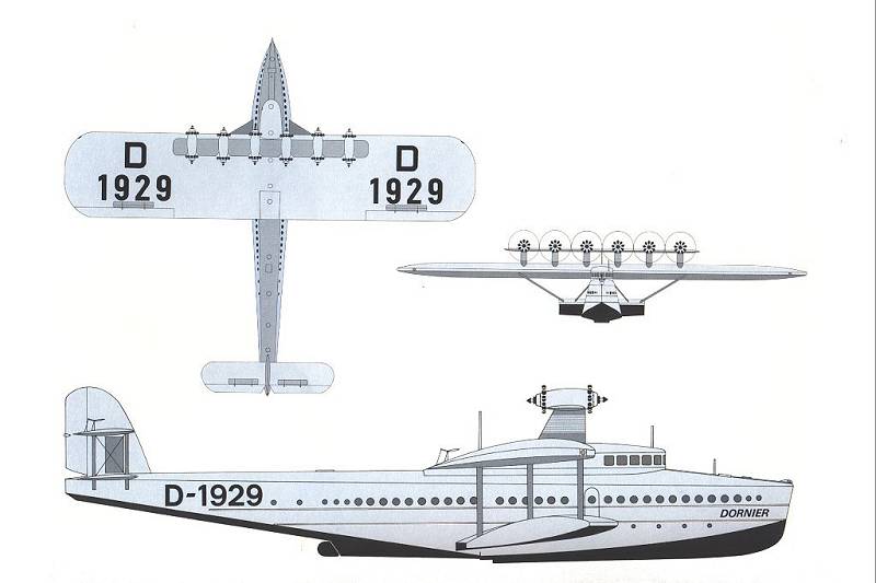

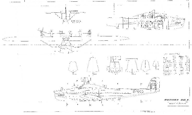

Just so ya know I ain't TOTALLY off'n my rocker, here's what I have in mind. I've wanted to build one of these ever since I saw a picture of one in my youth.

That raises a good question. How much thrust does a Wasp produce with, say, a Cox 6x3? Even though 12 Wasps is less than a .75 in terms of displacement, you'd be getting a lot more thrust. Maybe 12lbs or more, who knows?

I figured to have each pair of engines running off a common tank, where the nacelles would basically be just tanks with an engine on each end. I hope to achieve something close to 2 oz per engine. That oughtta give me enough reserve to get 'em all going if they're cooperative.

They may have trouble sucking the fuel from a 2 oz tank. You'd want to try it first.
But I doubt you'll have any trouble at all with the power. I'd shoot for keeping the weight down a little. Say 7'ish lbs tops. First of all it would give those Wasps a fighting chance and second it'll make the airplane fly slower. The original was apparently a very slow flying airplane.
Even at 7 lbs and if you only ran 6 engines. That's only just over one pound per engine. And I doubt if a Wasp would have any trouble flying a one pound airplane.

15.5 lbs. of thrust, eh? I've got a Great Planes 1/4 scale Cub (90" span) that turned out to be a lead sled. Flying weight 13+ lbs....flew well with a .61 2-stroke. Sounds like I could scale this thing to fit the props and have everything work out OK. Excess power would be a good thing. I'd say there's a fair-to-middling chance it'd lose more than one engine per flight.
I've used both 2oz and 4oz tanks with reedies...I don't imagine the draw on a Wasp would be much - if any - worse.
Hmm...one problem with having someone go down the line with the ignitor is the push/pull arrangement and the fact that the nacelles are so close together. Be mighty dangerous to do that. Perhaps some sort of wiring harness built in would be a better idea, maybe with a switch or similar to light up only the engine being started.

As for throttling the Wasps, I had this idea: Take a long piece of music wire and wrap and solder "L" shaped pieces of wire onto it with the same spacing as the engines. What you have is like an aileron torque rod with six posts sticking up off of it. These posts connect to the throttle arms on the engines. The end of the long wire is bent at 90 degrees just like an aileron torque rod and connects to the throttle servo.
So, one throttle servo controls all the carbs together off of this single, long torque rod. It could be run through the wing. Picture the way an aileron torque rod actuates an aileron, but, instead of the wire inserted into the LE of the aileron, you have six extensions coming off the rod connected to the carbs.

Then the torque rod system is ever better. The rod in the other wing which is driven by the same servo operates the pusher throttles (the same way the two ailerons operate in opposite directions). You just have to use two throttle servos each with their own pairs of opposite moving torque rods. I've seen much more complicated setups with tri-gear mechanical retracts.
One servo operates the tractors in one wing and the pushers in the other wing. The second servo does the opposite.
Since the engines are back-to-back their throttle arms are on opposite sides and the pushrods from the torque rods won't get in the way of each other; they're staggered down the wing.
