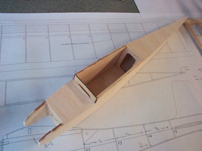

I have been studing the Mini Mambo plans for a while and I do see one in my near future.
While I see no difficulties to a build there is no top view.
What is the width of the fuselege?
That is is it parallel from the check pieces to the back of the rear cabin former?
Or, is it tapered from the front cabin former through the firewall?
Is the cabin even parallel?
Does the rear of the fuselege straight taper to the tail?
Or is it a bowed taper (as in not a straight line)?
I realize the width will be dependent on the radio gear. But someone my have
a kit they can measure. What was Sterlings vision for this model?
I don't know if I want it single channel or muti (two) or even what I will use
for an engine but I'm thinking Wen Mac. I'll sort this stuff out myself.
TIA - Steve B.

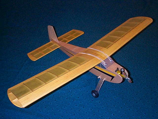

Well, most kit manufacturers did not include the top view to discourage scratch building. Sterling was very good at this. My Minnie Mambo, which is taken from an original kit has the firewall 2 inches wide. F1 is 2-3/8 and F2 which is directly behind the wing is 2-1/8 wide. The rest of the formers are positioned for a straight taper back. All are inside dimensions of fuselage. The critical point is the horizontal stab position in relationship to the wing saddle. Make sure this is held or you will have a wild Mambo!! My current Minnie Mambo has an ACE single channel pulser with a OK Cub .049. About 200 flights to date!! Here is a picture of the finished fuselage less the wingsheild block from the manual. You can see the straight taper.
Bob Harris
Bob Harris

Bob:
Wow a triple taper, I wouldn't have guessed - but why not. I use a fuse. jig so that will be no problem.
I am assuming inside dimensions on the firewall, F1 & F2. I can build on the wing saddle so the stab
incidence should be no problem.
thanks - Steve B.

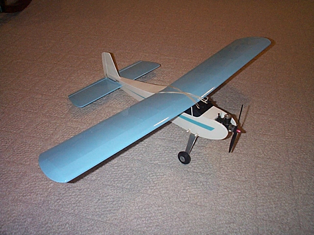

My Feedback: (18)
Yep, the Minnie Mambo is quite a bird. Here is a picture of one I bult for my nephew to learn to fly on. It has his full size radio in it. Futaba 127 rec, 3ea 3004 servos and a 500mA pack. Black Widow .049 with throttle sleeve. Flew quite well even with all that weight!
Bob Harris
Bob Harris
