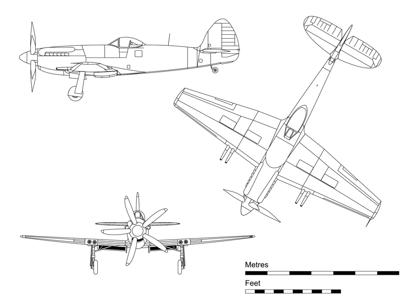

cp, your P-51 contest entry is amazing! That thread was before I knew about RCU. I think you should build a Supermarine Spiteful. It was one of the first (if not the first) British planes to use a laminar flow wing like the P-51. It would make a great SWR:

RD, that Supermarine job was even hotter than the P-51 by a slight margin, wasn't it? It's too much like the P-51 for me to want to build it, I want to branch out and try something different. Translated that means a project with a higher probability of failure.
