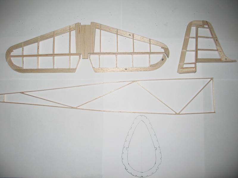

I am currently working on a Guillows Hellcat, and I have a couple of questions. I've redesigned the fuselage for 1-piece formers aligned with a horizontal keil. I'm using the design in the kit for the built-up tail feathers, and I plan on redesigning the wing to include a hardwood spar. I plan on sheeting the wing and fuse in 1/32" balsa.

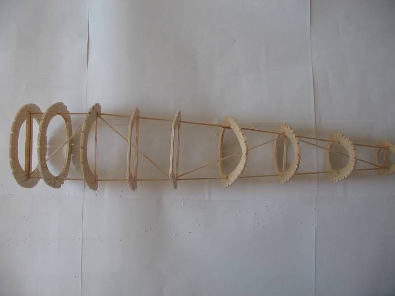

In the meantime, I framed up the tail assembly, awaiting finishing sanding, and built the keel for the formers. It serves no structural purpose other than to serve as a guide for aligning the formers. You can see a rough design for a former right below. This should reduce weight and free up a lot of space. The stringers and sheeting should provide the strength for the fuse.

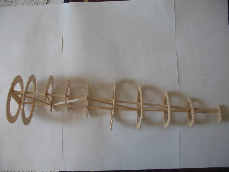

OK, here's the formers test fitted on the keel. So far not so bad. Once I have enough stringers in I can cut out the cross pieces to make room in the interior.

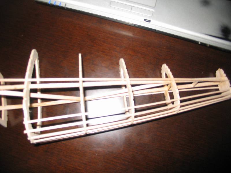

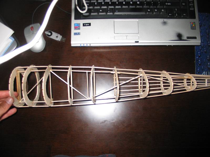

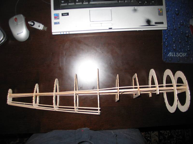

Sorry for the long absence, was on vacation. Did a little work on the Hellcat. I glued all the formers into place and began on the bottom stringers. Still debating on engine size - what do you guys think, .061 or .09? So far weight is nil. Sorry for the low quality pictures, but you can see the general progress (or lack thereof). All in all the project is much fun. I think there is a need out there for 1/2A's with more scale outlines and features - what do you guys think? For whatever reason I like the challenge of small, scale models.

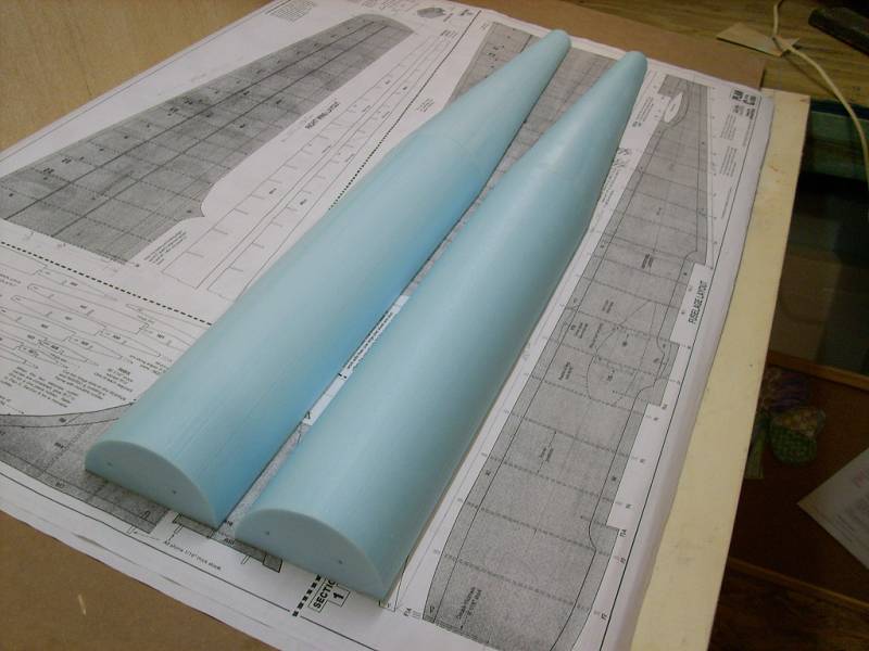

Looking good on the Guillows conversion! They look like a lot of work with all the stringers and such! I just did a B-29 job for a friend in TX where I used the Guillows plans, and cut it out of Blue Dow foam. He's going to use carbon fiber for reinforcement and is going electric as well. Good luck on you project![8D]
