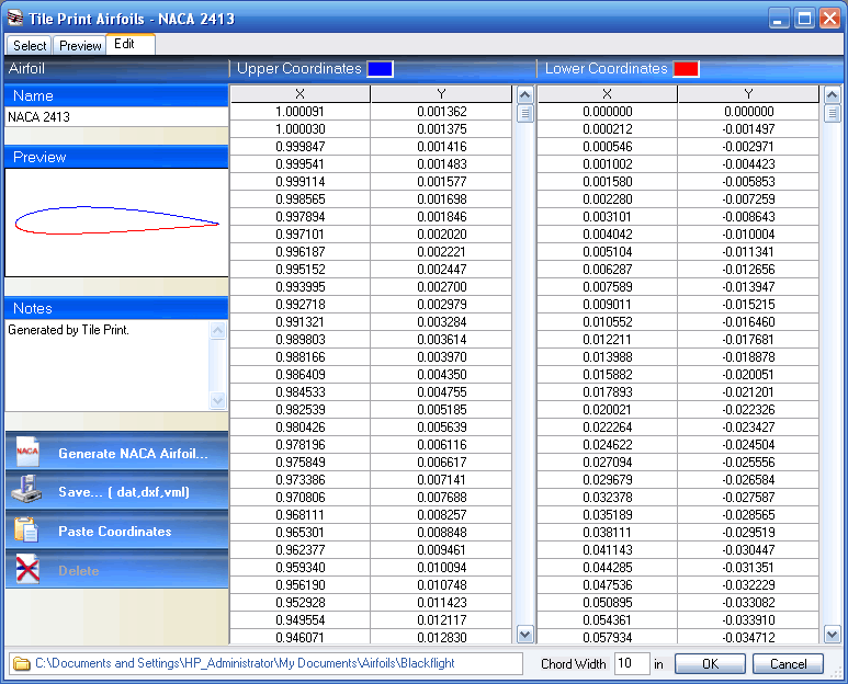

Tile Print has a database of over 1500 airfoils and can generate NACA 4 digit, 4 digit mod, 5 digit, 5 digit mod, 16 series or biconvex airfoils and export them as dat, dxf or vml files. It does not use a database, but reads DAT files directly from disk with no importing. It only creates the airfoils though - no spars etc. I use it for creating DAT files for my foam cutter and DXF files for designing planes.
All of the airfoils functions (generation, editing and exporting) work without purchasing an unlock key. The key is only required for printing.
You can download it from http://www.blackflight.com/tileprint/
