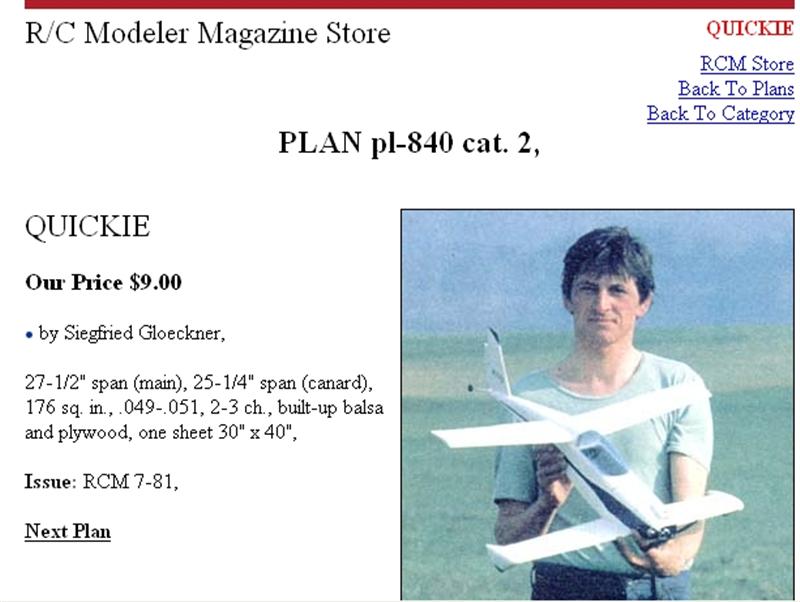

RCM published a Quickie in half A form once upon a time. Cute li'l bugger but it always seemed a little too flimsy for my tastes. Darn narrow chords. Today might be a better time to try something like this with CF in it.
Does this look like yours marwen1?
Robert
Robert
How much weight would you guess that thing can lug around with grace, agility and pizzazz?
I would love to have anyone show me a truly outstanding flying 1/2A canard that isn't some "gollywock" looking creation. I'm talking about a flying machine that is worth the time it took to build.
BTW, the plane in that picture is a "looker" IMO. But unless it is really light, I'll bet it is all show and no go.
As an SWR style that isn't intended to slow down much I'll bet it would be a winner. But yeah, for small field slow flying their just isn't enough wing area to airplane volume to easily ensure a good light wingloading that is needed for slower flying and gentle stalls.

Hah! Bruce. Ya grab me dude! LOL
The article in RCM is exaxctly tyhe one brought to attention by the cropped page from RCM.
Nope you are 100% RIGHT ON. This thing is S-L-O-W ! .049 I don't care which one you have -- it's still a small engine
This was RCM 7/81
I'm still bangin' out FULL SIZE PLANS with that old ENCAD PRINTER that I bought back about 2002 -- or so
Specs on it call for 18 oz. Mine came in at 22.25oz ?? !!
