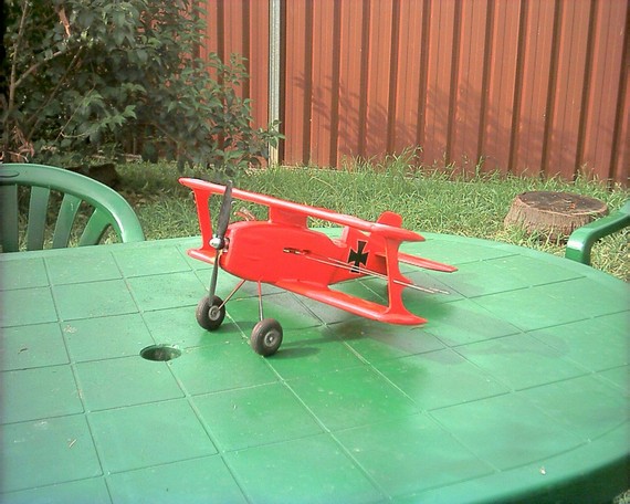

In view of some recent threads relating to small bipes and Walt Musciano's control line models , thought I'd show you the Tiny Tot C/L that I built from Model Aircraft 1961. Free plan on Tony Elmore's U.K. site.
Norvel .061, uniflow tank, Cox 6X4 prop and 35' lines.
Test flight tomorrow.
Anyone else built one?..........John

Well, it was about what I expected, although a little tail heavy and having too much elevator throw, managed to survive day one.
I'll add some weight to the nose and move the pushrod in a hole on the bellcrank.
With 25% nitro and a Cox 6X3 and big control throws it was twitchy, but not as fast as I'd hoped for. I did use the 35' lines.
Non aerobatic at this stage, just mushed when coaxed into a loop.
Fun project anyway, and it can only get better.
Makes a change from Noblers etc.
