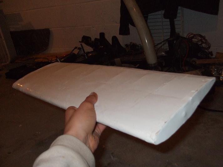

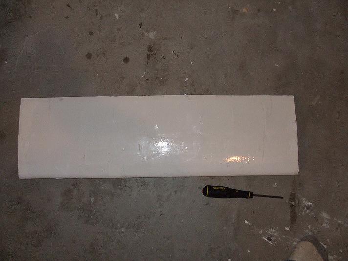

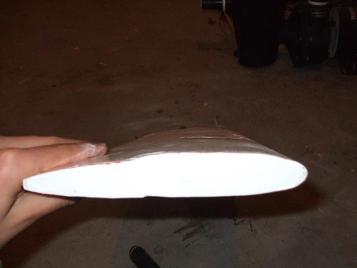

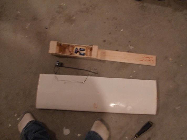

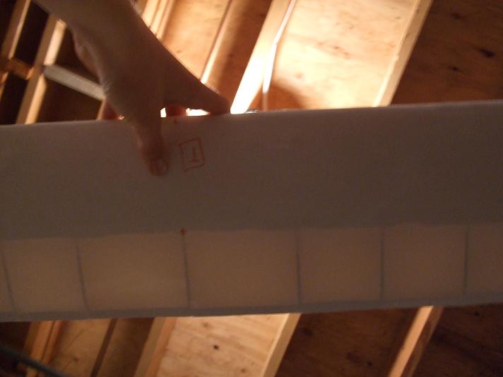

Finally finished the wing. It is 26in long with a fully symetrical airfoil and 0 dihedral. The plane is generally going to be a little heavy. In the following pictures you can see the wing compared to a screwdriver and the partially assembled fuselauge

Looks like a Sure Start would be perfect. Four servos? Needs a throttle ring, or is it setup along more functions?
Low aspect ratio, for sure. It would help once the tail group is on, to get a better visual of the layout.
