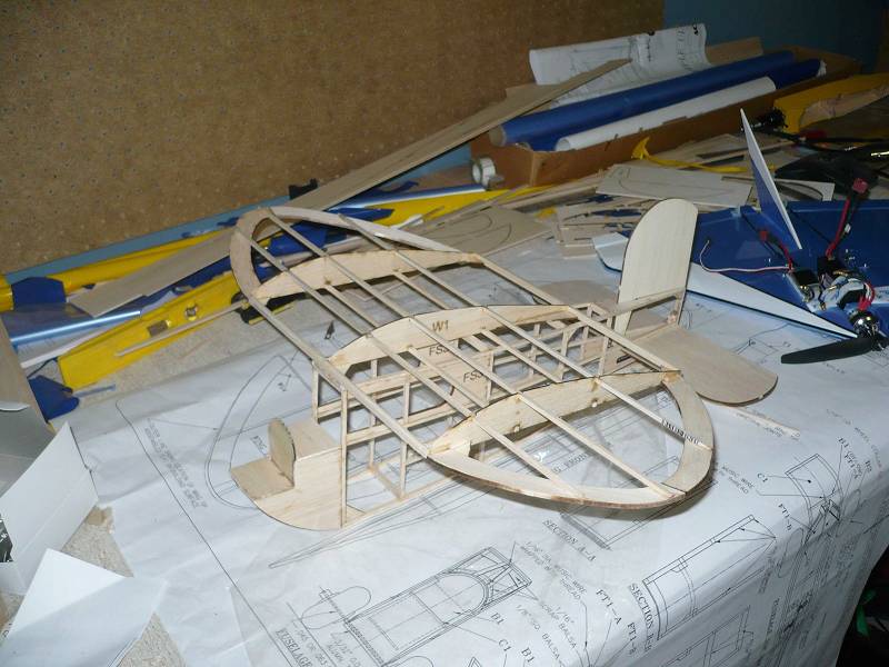

Default Lady Bug
Well here is my Lady Bug that I am framing up...so far it only weighs 2oz....I am still trying to decide whether to make it electric or glow, I scanned in the parts and then traced them into delta cad and had them laser cut, framed up very fast. These planes are kind of ugly but at the same time seem like a blast to fly. Rog, when I get moved back there I will have a ton planes to maiden!!
Oh and that little test airplane I was working on with the swept back wing.....I decided to do some glider tests(as my front yard slopes down to the road pretty good)....yeah well it would make a good lawn dart to say the least....it is still sticking out of the front yard but the birds to love it to perch on.

Hey Bill what is the wingspan on that bug?..Raymond had his at the swap meet and he had an .010 on it and said it was a handfull!!...Rog

That would be the Lady Bug Rev.B. 21 1/2" span. Rev.E has the 2 wing options. Rev.E has 22 1/2 and 18 1/2" span options. Just measured my plans. Difference otherwise includes the tail surface shape. And lastly Rev.E has a plywood mount to rubber band on for use with electric motors.

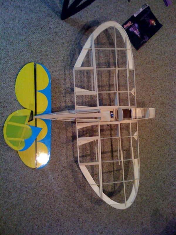

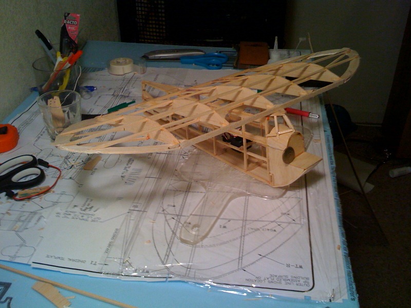

WOW! I am building a lady bug too! I start covering tomorrow! I had to hand cut all my parts so its not as perfect and clean as yours. The plans are good though it was a fun fast build. I opted for the longer wing version because it is suppose to fly slower. I picked up a brushless motor and speed controller for 20.00 from graysonhobby.com I am planning on using my two cell 860mah lipos from my cx2 heli to power the plane.
I am also building a speedy bee from scratch and just got in the servos to mount in the wings. So after I do that I have to put in the motor (os .15) and then finish my covering. I have a 40 size lazy bee arf that I really enjoy flying to I can't wait to get these other two buzzing. I do love my bees!!!

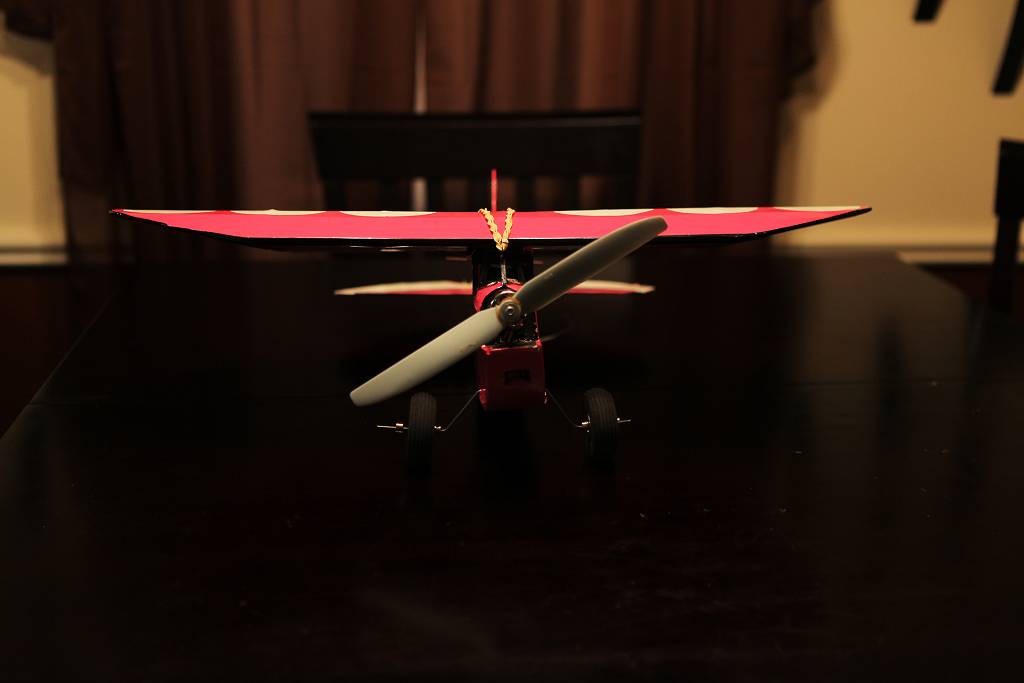

Ok so here it is covered and ready for its first maiden flight. Weighting in at a womping 8.4oz it is powered by a 300 brushless motor, 18a esc, and a 800mah 7.4 lipo battery. I can tell already that the plane is way over powered but it shouldn't take much to keep it up in the air. Just waiting on a nice calm day to take it up for the first flight. The suggested control throws seem very small for the plane and after reading a few posts that seems to be accurate. So I will plan to add more throw in the feathers. Can't wait to fly it!

Make sure you don't launch it with the throttle pinned open, or you will get a nasty surpriseDAMHIK. Nice covering job, BTW.

ORIGINAL: focusproduct
OOPS, yet another electron powered plane crashing the 1/2A party! Cute but wrong fourm.
