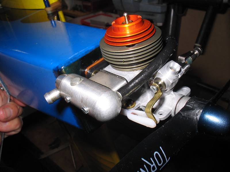

I've been doing anodizing for years. Heads can be hit and miss, it depends on the grade of aluminum. If machined from 6061 or 7075, you can get good results. If its cast from high silicon aluminum (and many are) all you get is a nice, dark grey finish that won't take the dye. The dyes are special, very fine grain products with the correct PH.
Any part that isn't meant to be treated, can be masked off with a soft epoxy mix that doesn't fully harden. Depends on the brand, but mixing only half the hardener usually works. That peels off easily when the anodizing is finished.

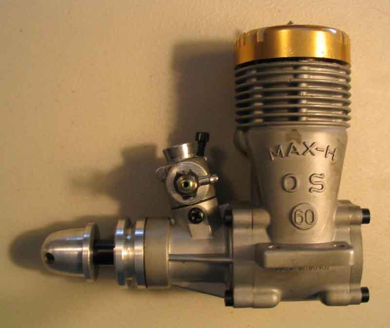

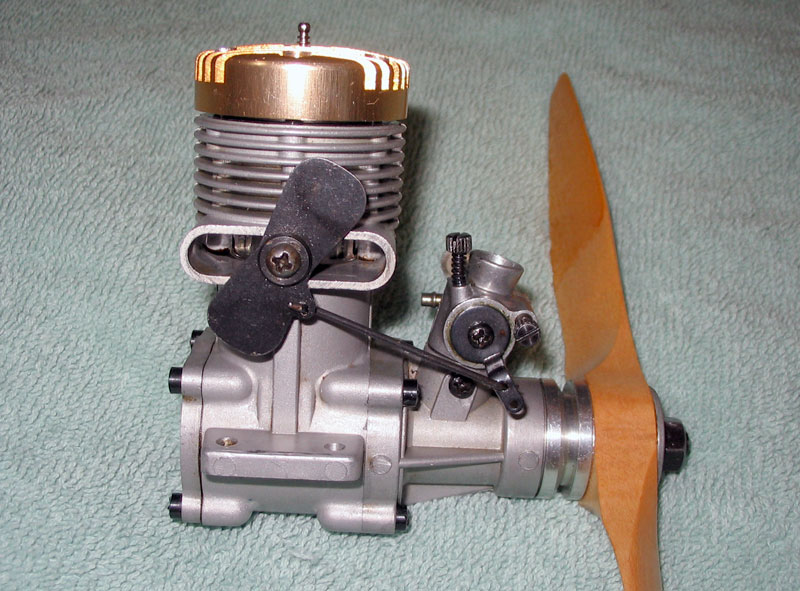

Thanks Andy. I guess if the heads were originally anodized by the factory them should work fine, yes?
I have a used OS Max .60 Goldhead that the previous owner cleaned too well. I didn't even know it was a Goldhead until I disassembled it and saw the underside of the head.
Here's what it's supposed to look like. This is av8rsodt's engine that I cleaned and restored for him.
I know this isn't 1/2A, but the people here know about all this stuff, like anodizing, etc. There's probably more modeling knowledge here than anywhere else on RCU.

Yes, that would make it the right grade for anodizing. Note that all the old anodizing must be stripped off first. This can reduce the part size by a few thou but it's only noticeable by way of slightly rounded edges. Takes the edge off,,,,
That gold colour though, may be a bit hard to duplicate. The Norvel head was done with a gold dye but it comes out more orange than gold. How accurate do you need the colour? I could experiment with some spare heads of my own but the grade of ally from one manufacturer to another is unknown.

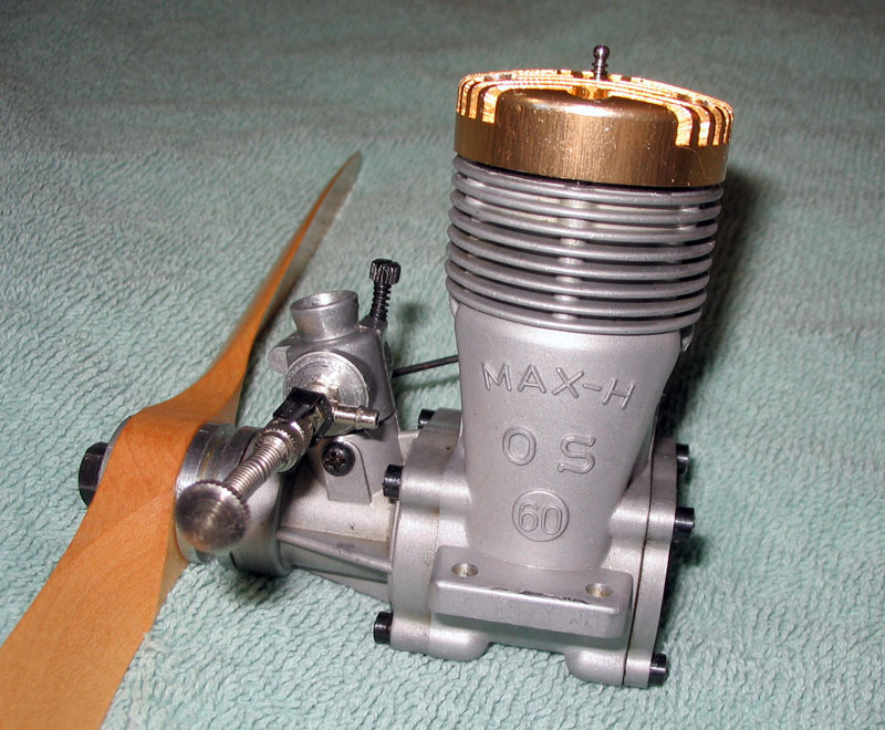

That engine was the "GP" which stood for "Golden Pride". It was an anniversary engine. I think it was available as front or rear intake.
Here's mine:
George

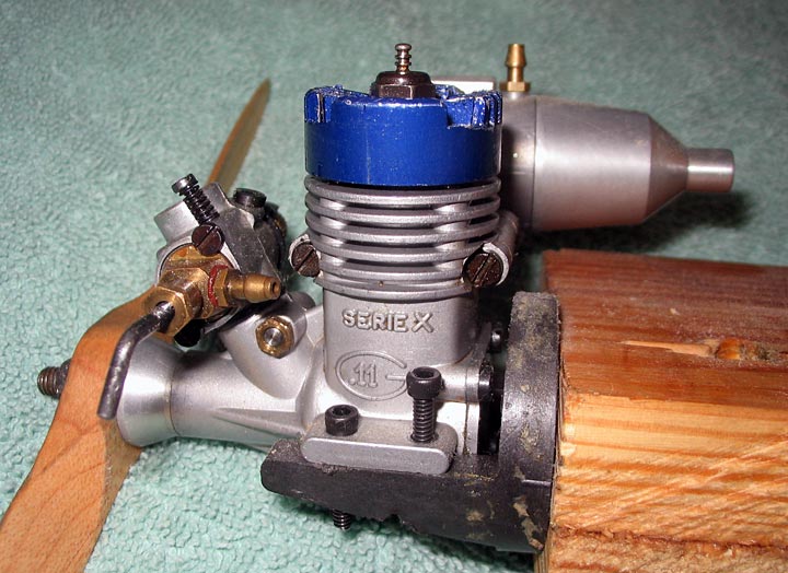

George, I know there is no engine that you don't own (two of). So, how many of these do you have?
BTW, I'll bet that "Super Tigre Blue" is a probably tough color to duplicate accurately.
