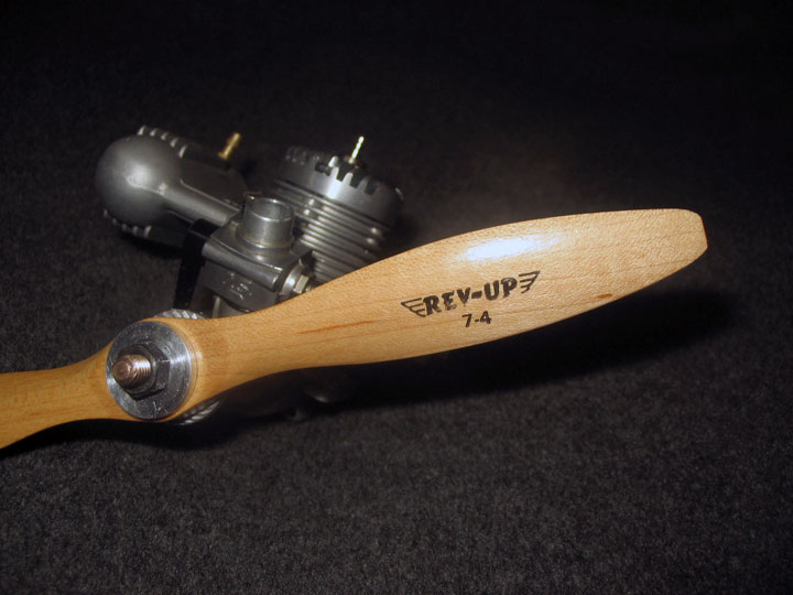

I just got this one for $16. I cleaned it up and I will run it tomorrow on Powermaster GMA 10/22 with the Rev Up 7x4 in the artsy photo. The Italians called that [link=http://en.wikipedia.org/wiki/Chiaroscuro]Chiaroscuro[/link]. It is a bit Caravaggesque.[8D] Man, I hope mine gets near 19K!

Yes, I ran it earlier today. After reassembly the compression was down on mine, too, but after a few short runs it started coming back. I was careful to put the piston back in facing the same way it came out. I usually don't mess with honed piston/sleeve assemblies for this very reason. It starts easily and seems to run fine. I will run it some more tomorrow and get a tach reading. I use Powermaster GMA fuel with lots of castor in all my oldies and that seems to help with well worn engines. I may need to wear it back in and build up a little varnish to get it back where it was.

Well, I think mine is just old and worn out. The best I could get on 5% nitro and an APC 7x4 was 15,825. That seems pretty weak. I'd certainly break 16K with 15% but not 17K.

Yeah, those are low numbers.
