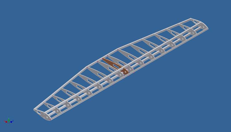

Ok so i designed a tenative wing tonight. 30" span, all 1/16" ribs, 2" taper. Let me know what you think.

Looks like a winner, start cutting some wood!
Be careful about hogging the ribs out too much. Nothing substantial will be gained weight wise and open frame designs like this tend to twist and warp easily enough as it is. I would only remove enough wood as is necessary to allow free movement of the lead outs.
The thick airfoil that you show will help build in some strength. Keep it as light as you can, 30 inches worth of wing can add up weightwise quickly every time you get a new idea to add something for strength.

Be sure to use a scarf joint or add a gusset where the trailing edge goes from straight to taper.

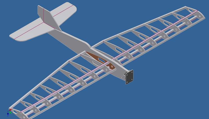

.008" lines would have helped for sport flying, but they aren't cheap and 1 little kink ruins them. Spiderline fishing tackle works and is 10 times more durable for flying lines. 30 pound works great for .15 powered planes, I'm not sure I remember what weight you could get away with for 1/2A, but I'll bet something like 15 pound is what works. I do remember trying it out with a Cyclon and having no problems. The ends of the lines are simply wrapped around brass eyelets a few times and tied off, no crimp sleeves needed.
Old 06-12-2009 | 08:23 PM
CAD_Flyer_321's Avatar
Joined: Jun 2009
Posts: 20
From: Liberty Twp, OH
Default RE: Need some help
well hopefully this one wont be too heavy, but we'll see after i build it, if it is i guess ill just have to go bigger with the engine. but i have attached a picture of where she stands so far...
now i just need to find her a name
and one other thing, whats the best material to cover the wing with?
