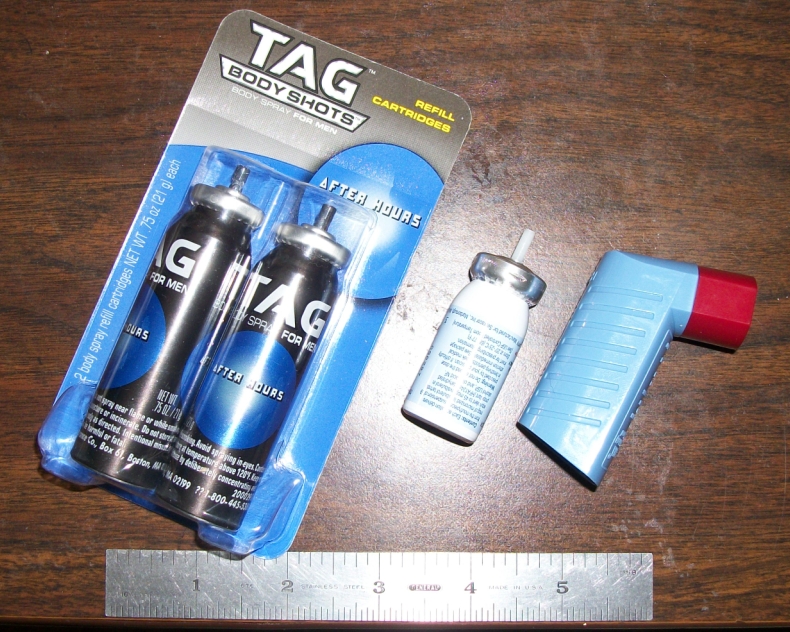

I have thought these small cannisters could be used for something and Have thought could be used to replace a lost Norvel muffler. As a fuel tank a little on the small side but maybe for a Tee Dee .020?
I have a recent discovery. TAG Body Shots refills. 3/4 oz volume and shown in comparison to one of the inhaler carts. This could be used for a fuel tank or a muffler pipe. Also part of a dummy torpedo or bomb, tip tanks, or even a radome? Cost from 5 to 7 dollars each twin pack but I checked on $BaY and saw two listings of three packs, buy it now, for $6.99. Just a little more than a doller each cannister.
Thin walled and light these could be quite useful.
Robert
Correction regarding the TAG canister volume. The package reads NET. WT. .75 oz(21g) each. The Volume must be closer to a fluid ounce or maybe a tad more.

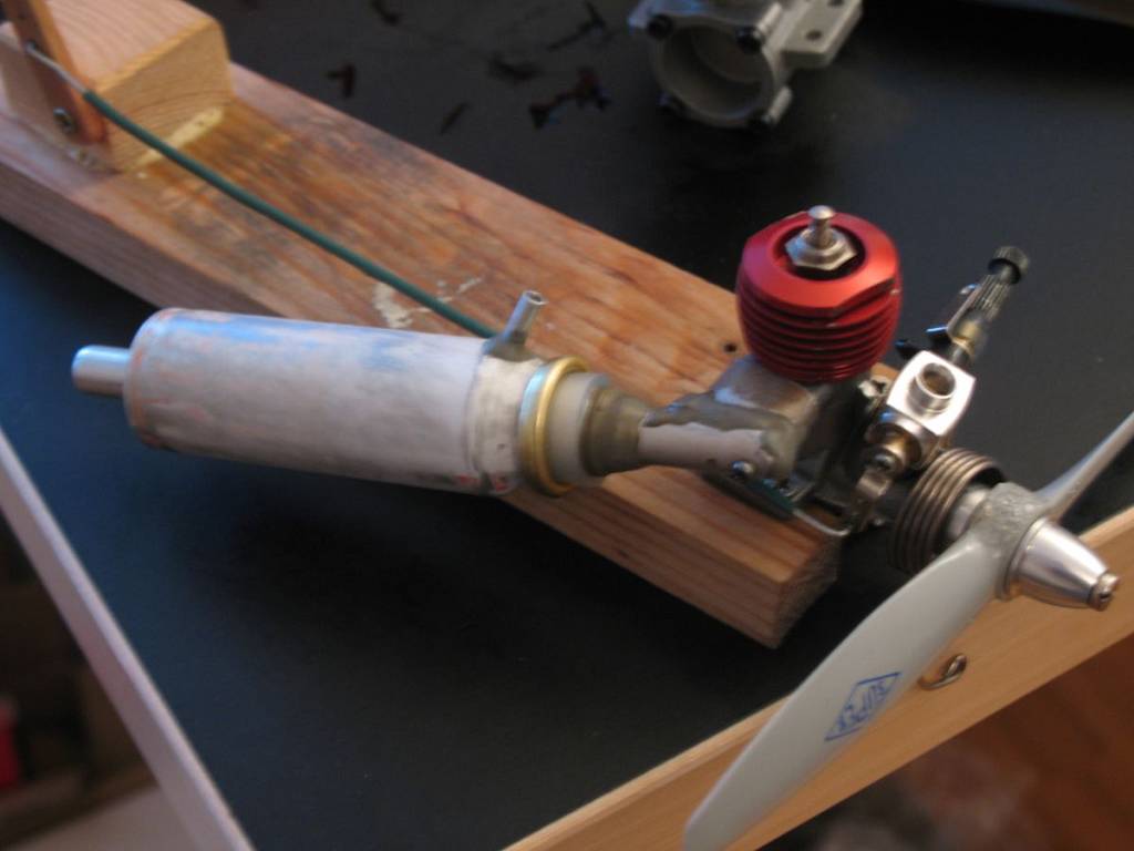

Yes, it works. Here is one from a can which had de-icer liquid for car doors. Made in MVVS style and adjustable to find the right distance. Marker pens are useful and thin-walled raw materials also.
But the .049 cox breaths best when they're naked...

Yes, sure any engine can in principle benefit from a tuned exhaust (even 4 strokes). But the exhaust timing is also important for the effect, how much exhaust opening does the cox .049 have?
Most cox engines also have SPI and so you'll have two events to time and tune...?

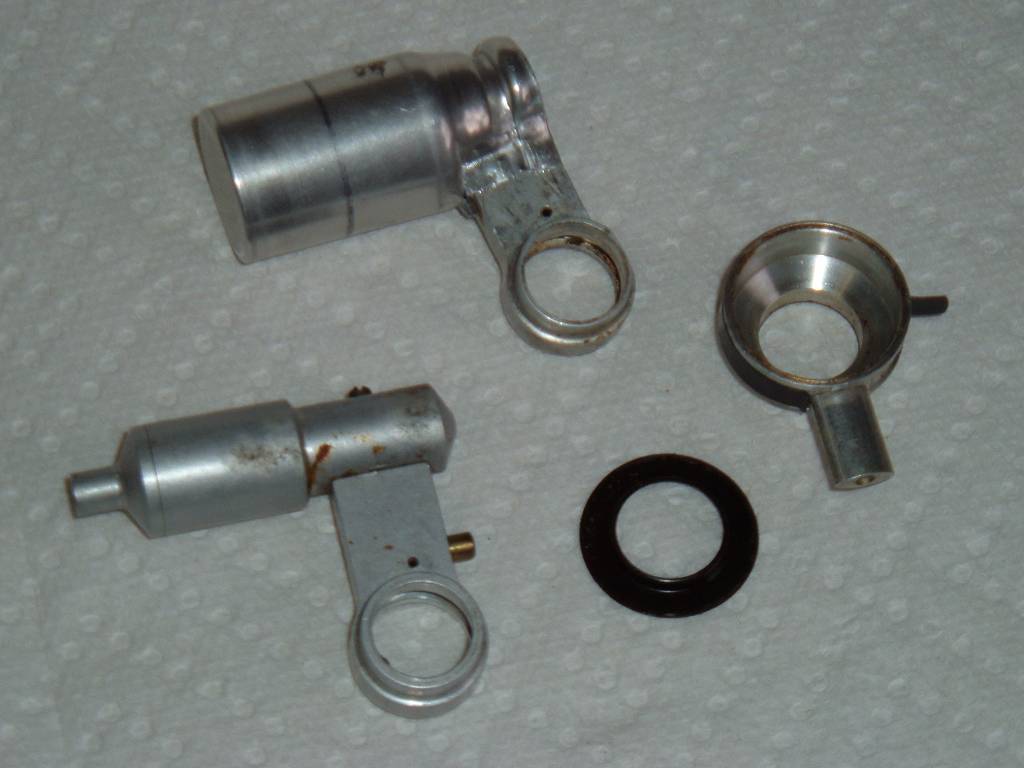

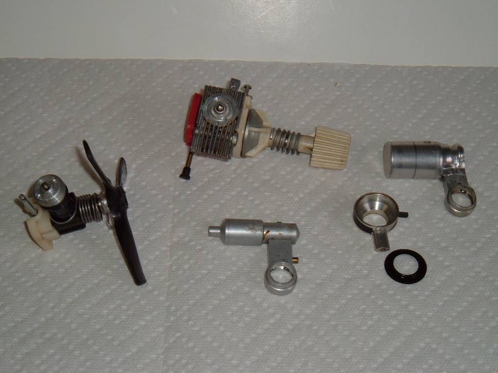

Some of this may bring back memories I have an old car and some pulling tracters And I have some of the slip rings for the cylinders. Throttle for .049.
ID:	1410092   Click image for larger version
ID:	1410093   Click image for larger version

My idea has been to solder a block off plate on one of the exhaust ports and create a 3rd transfer port. Then solder a fitting to the other exhaust port that allows 1/4" ID silicone tubing to slip fit over it. From that point it would be a matter of trial and error [for me] to come up with a cannister that works.
A Pitts style that can tuck into the engine compartment behind the engine would work for me. Similar to the VA muffler.

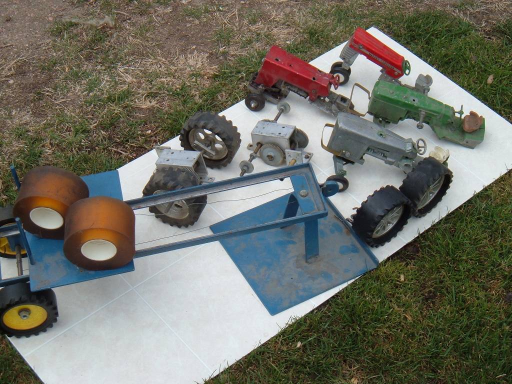

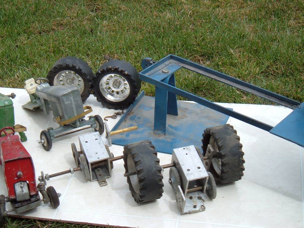

I will try to dig out the box they are in and take some pic's . I have the sled and power boxes they use Jerrobee gears and clutches. I was a dealer in them back then You would not believe it but the little tractors pulled up to 125 lbs on a 18 ft track.
Larry K
Old 04-03-2010 | 03:19 PM
Live Wire's Avatar
Posts: 6,059
From: Sterling , CO
Default RE: Let's try something !
Well here are some of them all in peices.
ID:	1410984   Click image for larger version
ID:	1410985   Click image for larger version
WOW! Look at all that stuff! It must be pretty fun to see those little guys tugging so much weight.
I'd never guess those tires could grip good enough to do much more than spin.
What is the gear ratio?
