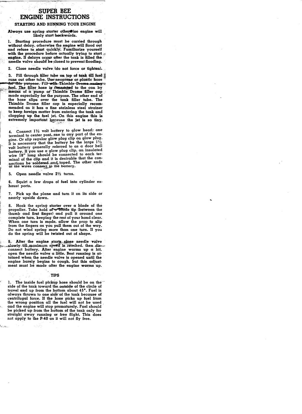

Always an interesting engine to talk about. I uploaded a copy of the original instructions.
