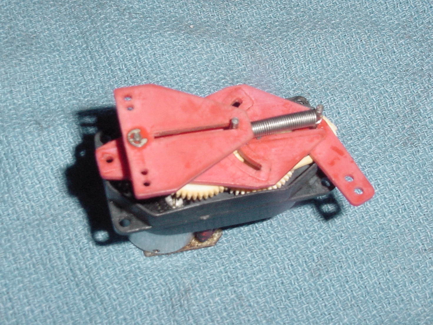

The second generation of the Rand actuators were produced using injection molded plastic for virtually all the pieces including the gears, base and output arms. All motors used were of the Mitsumi type, and were designed to use a 2.4-volt power supply. The very first batch of these actuators had a white pinion idler gear, which was prone to breaking in a hard landing or crash, so it was changed to a black plastic which was presumably stronger. The bases of these actuators are black plastic with two small pins on the top rim of the base near the throttle arm. An early version of the HR-1 had a shorter plastic base with the centering spring looped over to attach to the base. This was quickly replaced by the same base as used in the HR-2, and LR-3, presumably to simplify manufacturing, thus a later HR-1 can be converted to an HR-2, or LR-3 by adding additional parts.

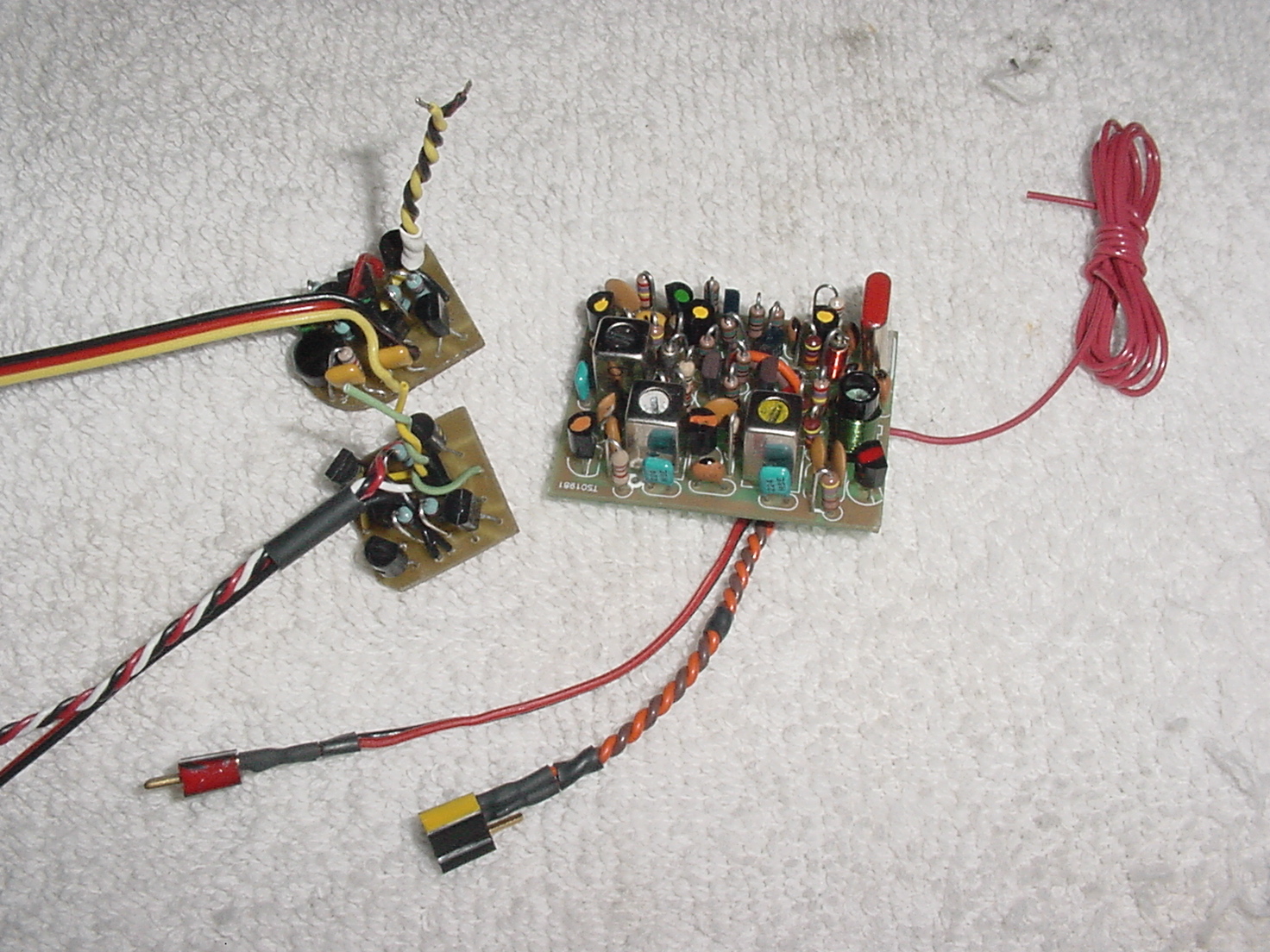

The very first Rand servos, and later versions as well, all had some sort of noise filtering in the form of capacitors and chokes soldered to the motor of the actuator to reduce interference with the receiver operation due to the motors electrical noise, which was significant. Later on Rand simplified this filtering by soldering a small circuit board to the bottom of the motor, which contained a couple filter caps and two RF chokes. There were several iterations of this board, and some only contained two filter caps, while later ones had the chokes as well.

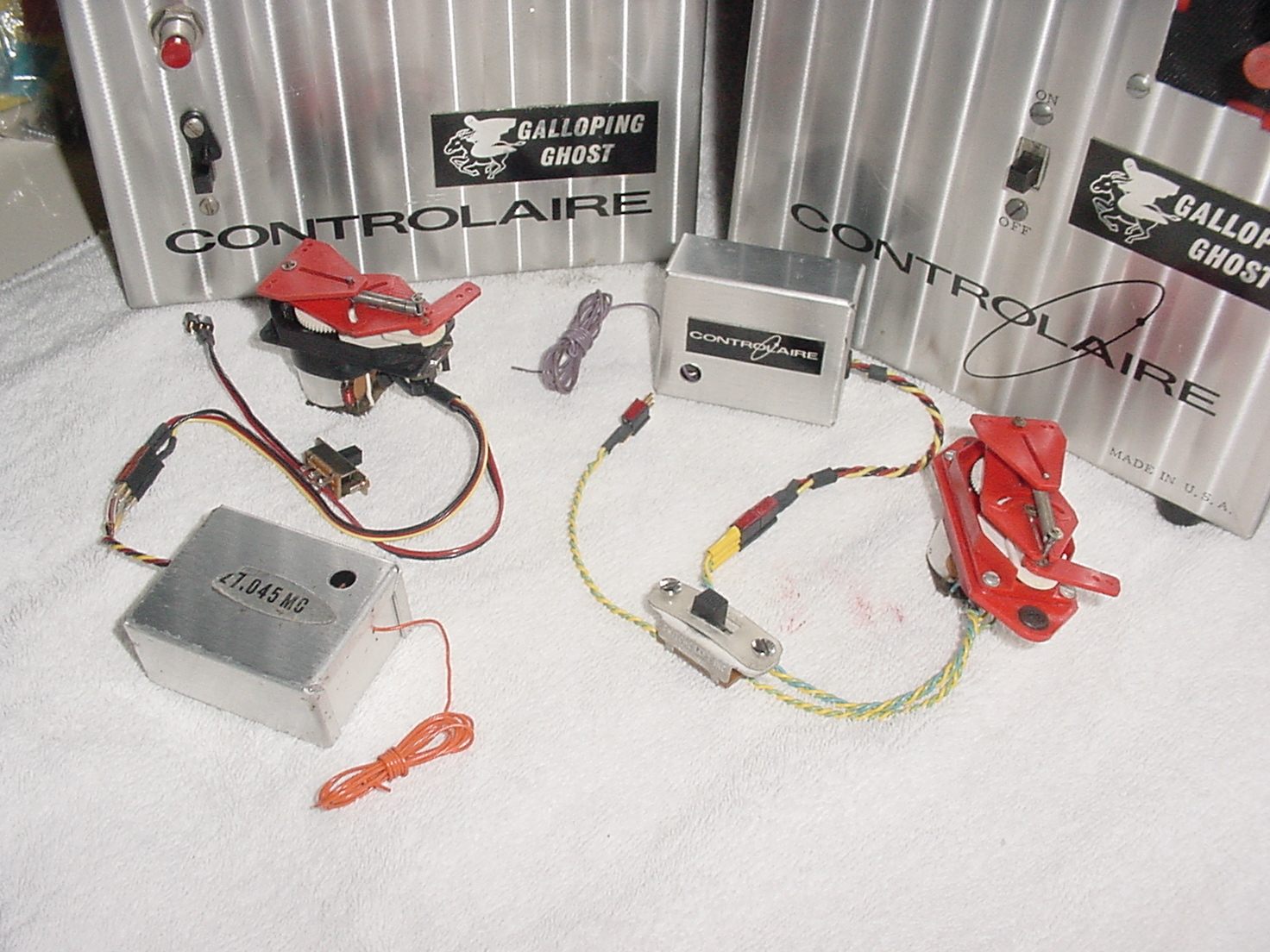

By around late 1967 Rand’s engineer Herb Abrahms responded to many modelers building their own transistorized switchers for his actuators by having Ed Fisher design one specifically for the LR/HR series actuators. This then allowed the use of a single 3-cell 3.6-volt NiCad battery pack, and eliminated the need for an additional actuator battery and a relay in the receiver as well. This significantly simplified the system wiring, reduced weight, and improved reliable performance. Rand introduced this as the “GG Pak” which had a modified LR-3 complete with wiring harness, on/off switch, 600 MAH NiCads, and plugs. The actuator had a red base, which contained a pocket on the underside to hold the small six-transistor switcher board and wiring. Additionally, it now used a 3.6-volt motor.
The “GG Pak” was a sensation, and so it was offered by all other OEMs for their Galloping Ghost systems; Ace, Controlaire, Bonitron, F&M, Logictrol (Digi-Ghost) all came with the GG-Pak, and later the optional high rate “Dual Pak”. This leads into the next Rand offering, the Dual Pak. The Dual Pak was as stated a dual actuator system complete with wiring harness, switch, plugs, rate decoder, transistorized switcher, and battery pack. It was designed for high rate only, and offered what was touted as “steady” or low dithering of the control surfaces. Put simply, it pulsed so quickly that the control surfaces effectively just quivered. Of course, your transmitter had to be a high pulse rate type, and many had a switch to select high pulse rate. In response to this, Controlaire, Ace and others offered retro fits to convert earlier Galloping Ghost transmitters to high pulse rate. Hallco called their version of this “Steady Ghost”.
The actuators supplied in Dual Packs also had the red bases with pockets for the electronics: the HR-1 had a rate decoder with switcher, and the HR-2 had the same switcher board as in the LR-3 GG-Pak actuator. A cable and connector from the HR-2 switcher board plugged into a mating cable on the HR-1 to supply power and signal to it. Both HR-1, and HR-2 actuators as supplied in the Dual Paks had 3.6 volt Mitsumi motors, and lighter tension centering springs.
Last, but not least, Rand also offered their switcher, and decoder/switcher separately as replacements, and as retro fits for earlier actuators. There were do-it-yourself kits offered as well for the switcher, and decoder for the electronics minded hobbyists. Rand additionally offered a version of the LR-3 that was similar to the GG-Pak version without the switcher, but the base included the pocket for the switcher, and these can be identified by their black base. These were sold separately as replacements, and also re-packaged by Ace as part of a complete do it your self-kit. You could buy the completely assembled GG-Pak, or Dual Pak, or get them as kits. The black base with pocket distinguished these kit version actuators from ones sold exclusively in factory assembled Rand Paks and Dual Paks; for warranty reasons they were not the same. The decoder kit came with a lighter spring for high rate, and instructions on how to convert an LR-3 to work as a high rate HR-2, or HR-1.
