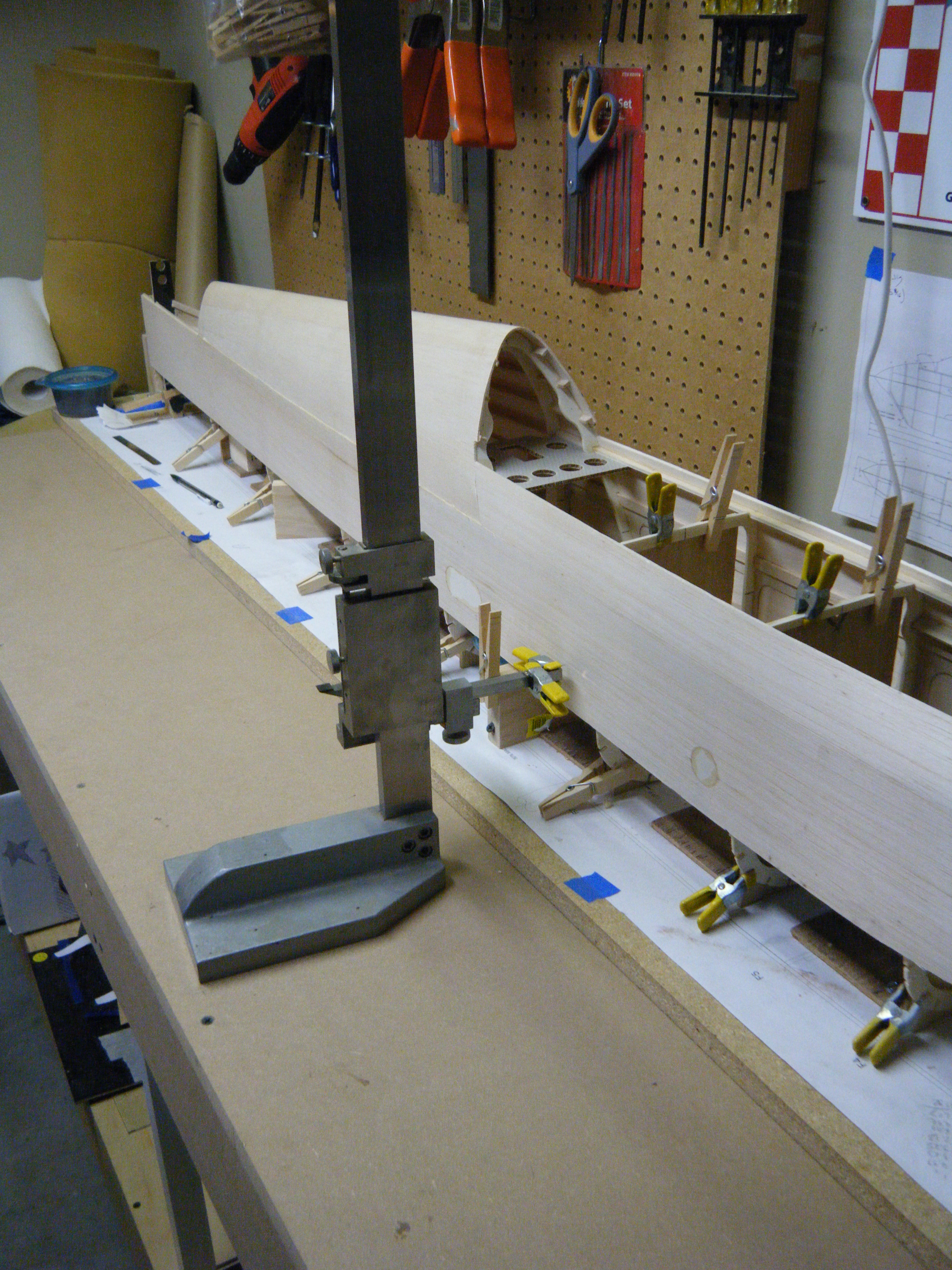

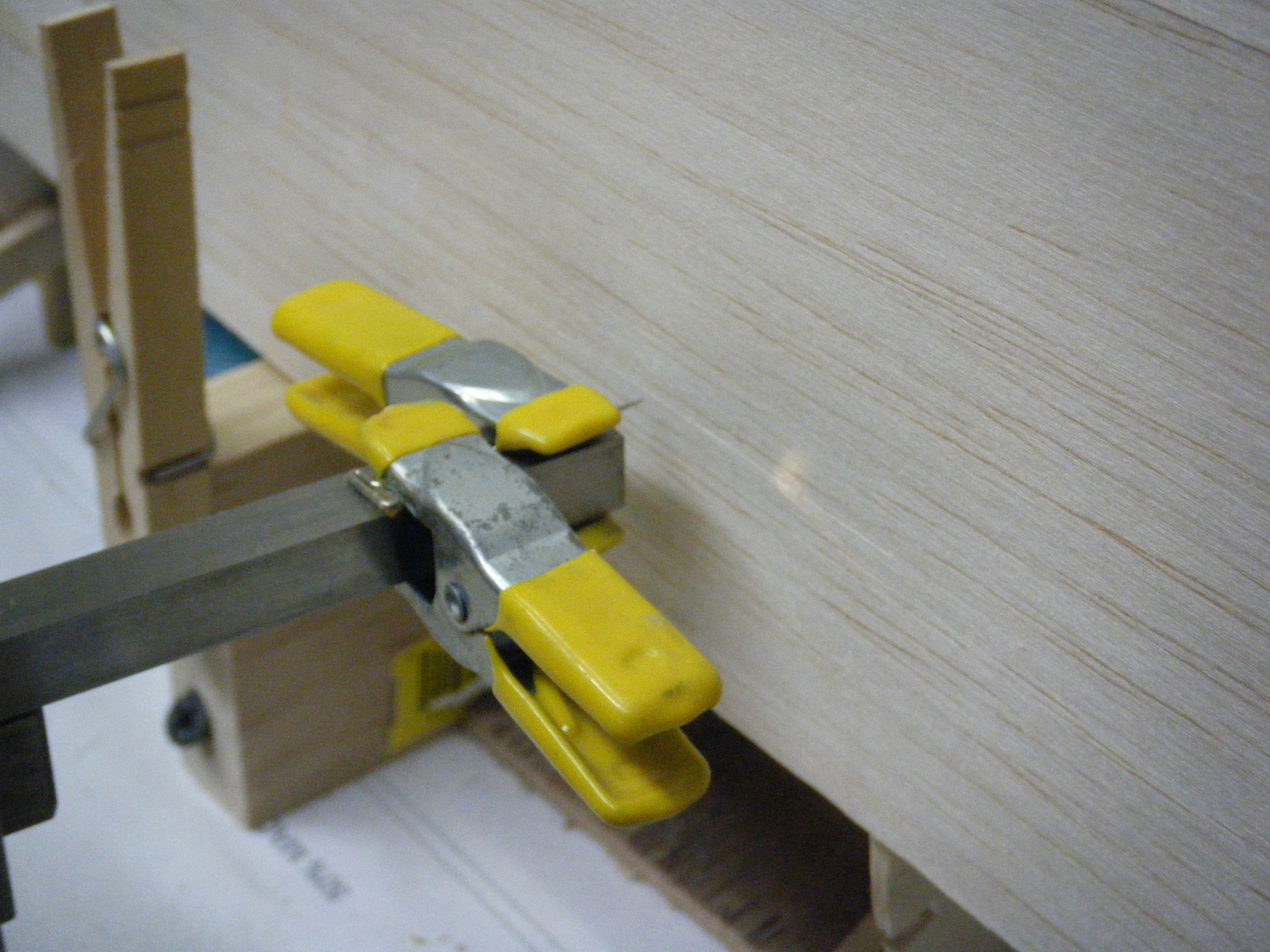

Prior to removing the fuselage from the jig, I used my trusty height gauge, with a minor modification, to mark the thrust line and the wing and stab reference lines. This is the time to get the most accurate measurments for these references and will aid in aircraft setup later on down the road.
