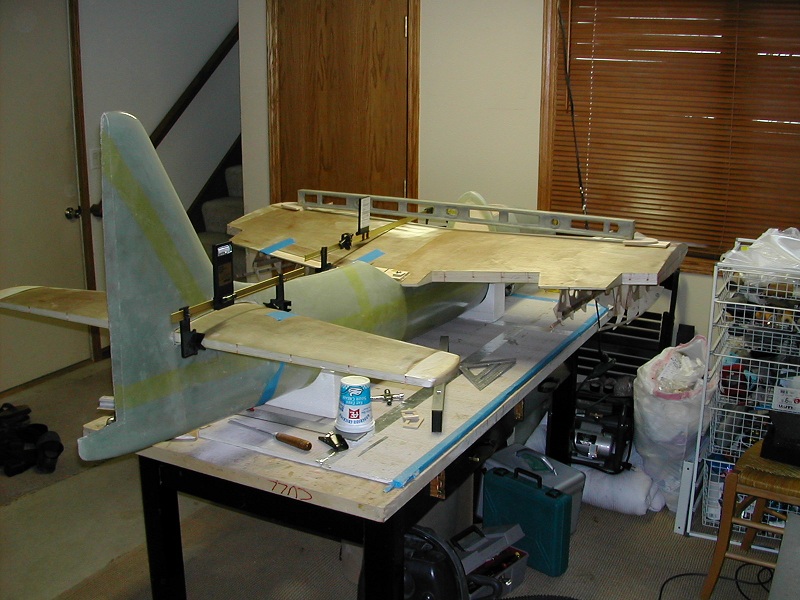

Also got the stab saddle sanded such that the incidence of the main wing and the stab are +1.5, 0 respectively.
Still need to mount the stab permanently, but it's ready to go in whenever I'm sure I no longer need access to the rear fuse.
