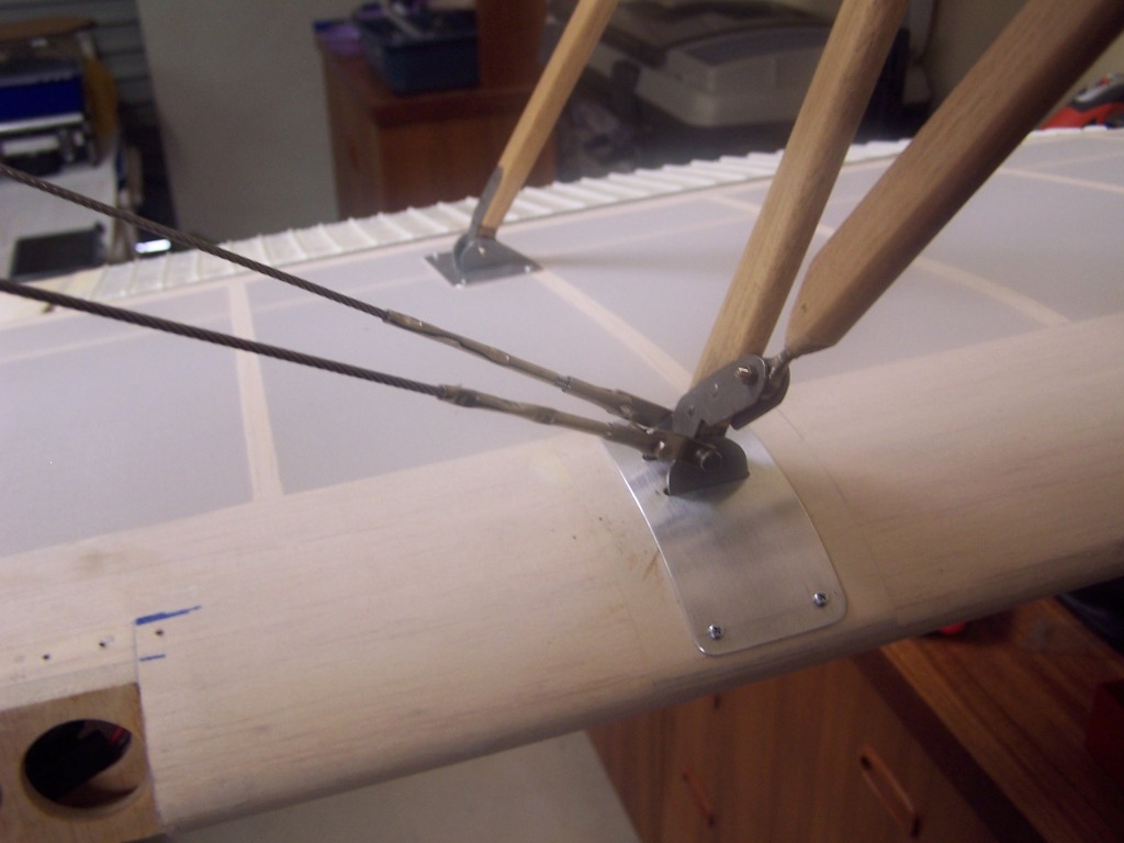

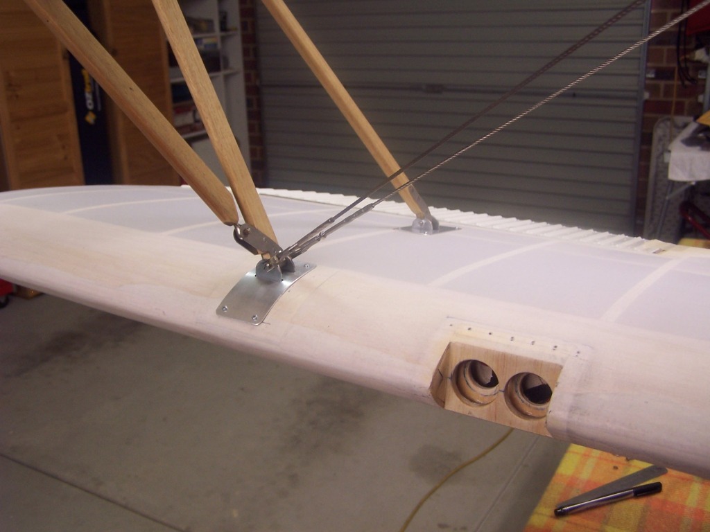

Looking good mogman,sure wish I could afford a Moki, I keep telling the family how much I want one but a Xmas & a birthday have passed and no Moki. After looking at the javelin I decided that the solid stainless flying wires had to give way to 2mm flexible stainless wires. Drilling the 2.1 hole up the stainless steel couplers was a bit of a challenge but finely got them done and swagged to the wires. Then the exciting bit was drilling the holes in the javelin in the correct place and at the right angles, a bit of trial and error but once again we got there in the end. I will wind cotton around the wires to attach the javelin as per the full scale. The javelin and the wires will remain attached to fuselage. Will post a couple of photos
