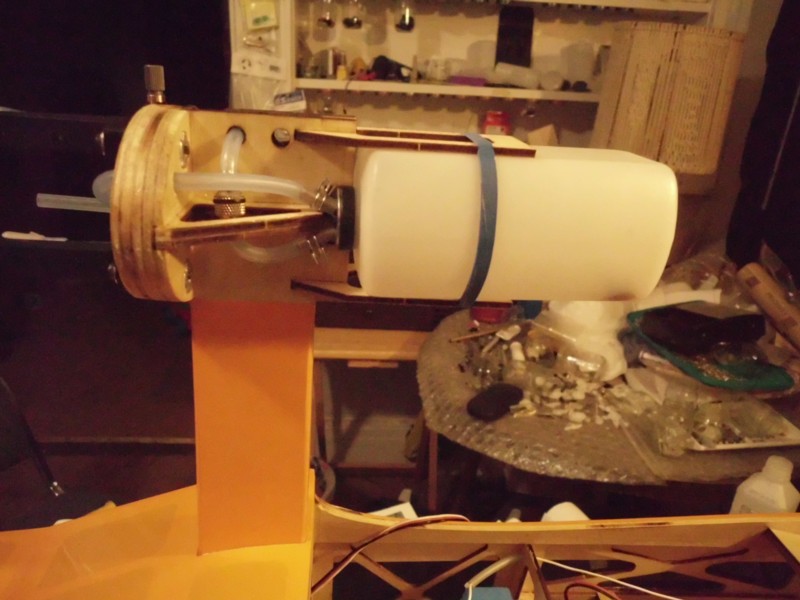

I only had to do little when it came to alternating anything, my stock glow tank was a little chubby and wasn't narrow enough for the cowl to fit over without risking damage. So I had another 260.c.c tank that fit perfectly and I'll be using that instead. I had to flair out the male vent and flow brass tubes in my glow tank so I could push the tank forward tight against the firewall post.

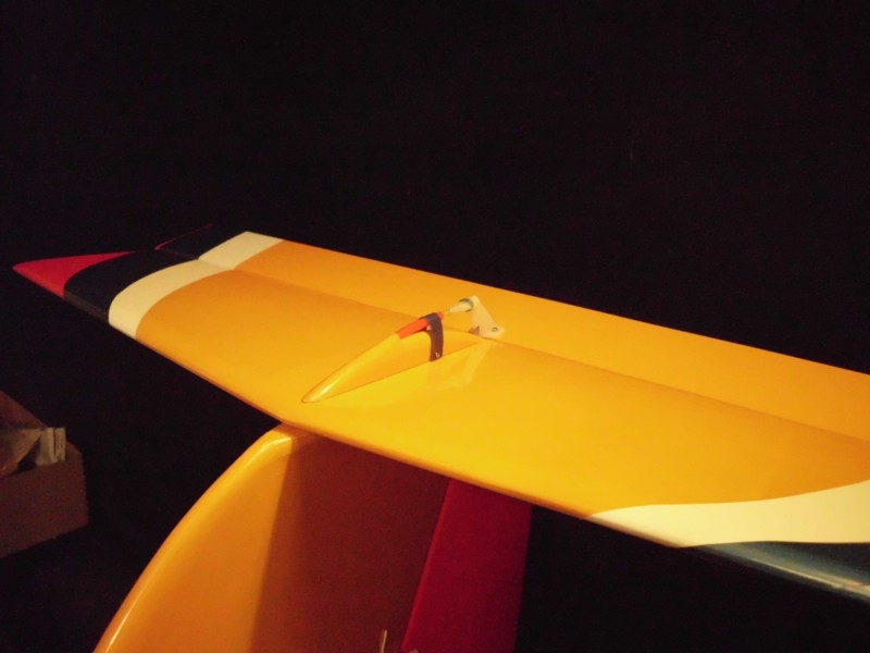

In the pictures you can see the way I have my electronics installed. Made a homemade switch handle by crimping a bike brake cable end safety tip, then applied CA and slid over a rubber screw thread guard.
I took a piece of soft plastic and made a support mount for the elevator flex rod. Right now I have the engine off because I'm about to cut the cowl and put it on. My plane has flapperons, but I know they aren't really needed- Just gets me off the water quicker. Plus it adds conversation at the float fly's.
