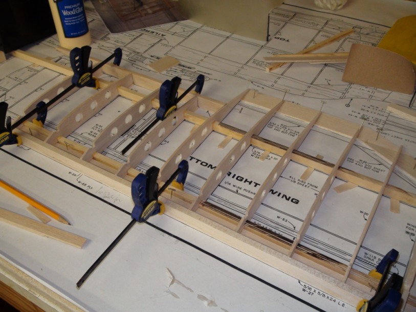

Progress on the new wings are coming along slow but coming. I’m doing things a bit different this time. To start I reshaped the ribs so I can use a cap strip. Instead of using the 1/8 ply dihedral brace I used 3/8 plywood with the 2 degrees dihedral cut in hope this will be strong enough. I may end up with a second Waco when I finish I’ve been know to do some strange things but having a spar Waco can’t be all bad LOL.
