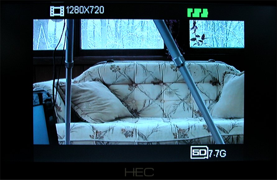

I took some actual photos of my LCD screen display. Although the photos didn't come out great, you can see the various capabilities in the screens.
The FlyCamOne HD displays information on the camera resolution setting, on-board battery charge, and remaining memory in the plug-in SD card. This can be seen in the first screen image. While this information cannot be turned off, it shows up outside the camera display and does not get added to the on-board recorded video.

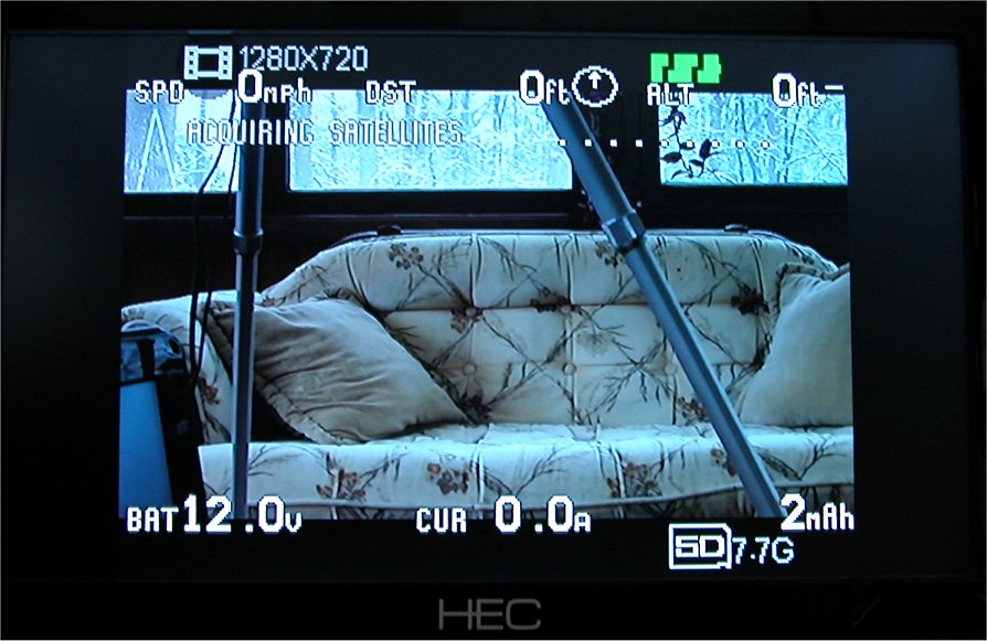

The second screen image shows the EzOSD information along with the momentary acquiring GPS status. Since it snowed here last night, the snow on the roof made for a longer than usual GPS tracking time. A few days ago, without snow, I was tracking from inside the house after only a few minutes.
After initially testing the EzOSD features, I cut into the current sensor unit and adding wires for the RSSI and Display On/Off features. I haven't wired the RSSI line to my Futaba receiver yet but the Display On/Off feature worked nicely on Ch. 5 normally used for gear.
