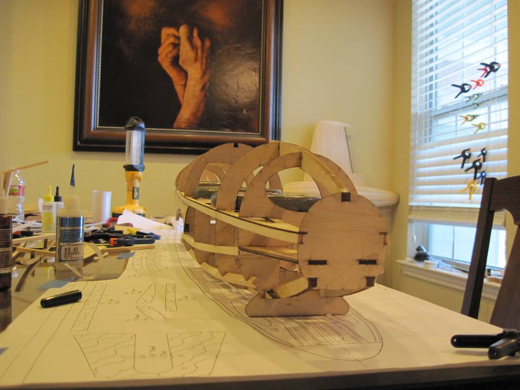

<div>The fuselage builds nicely. The jigs come in handy to keep her strait!
<div>I used weights to keep her put!
<div>I tacked the first two jigs to the frame with CA!

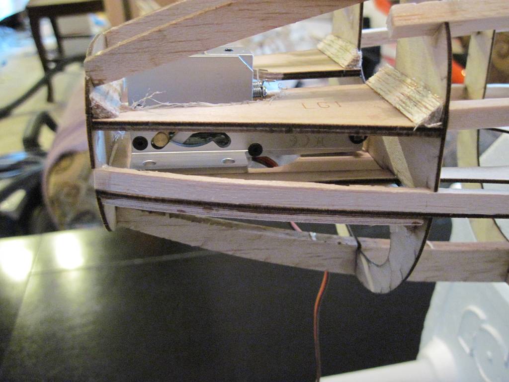

<div>For the nose gear the supplied gear mount is too high for the E-flight retracts. I cut a new mount and set it on top of the crutch.
