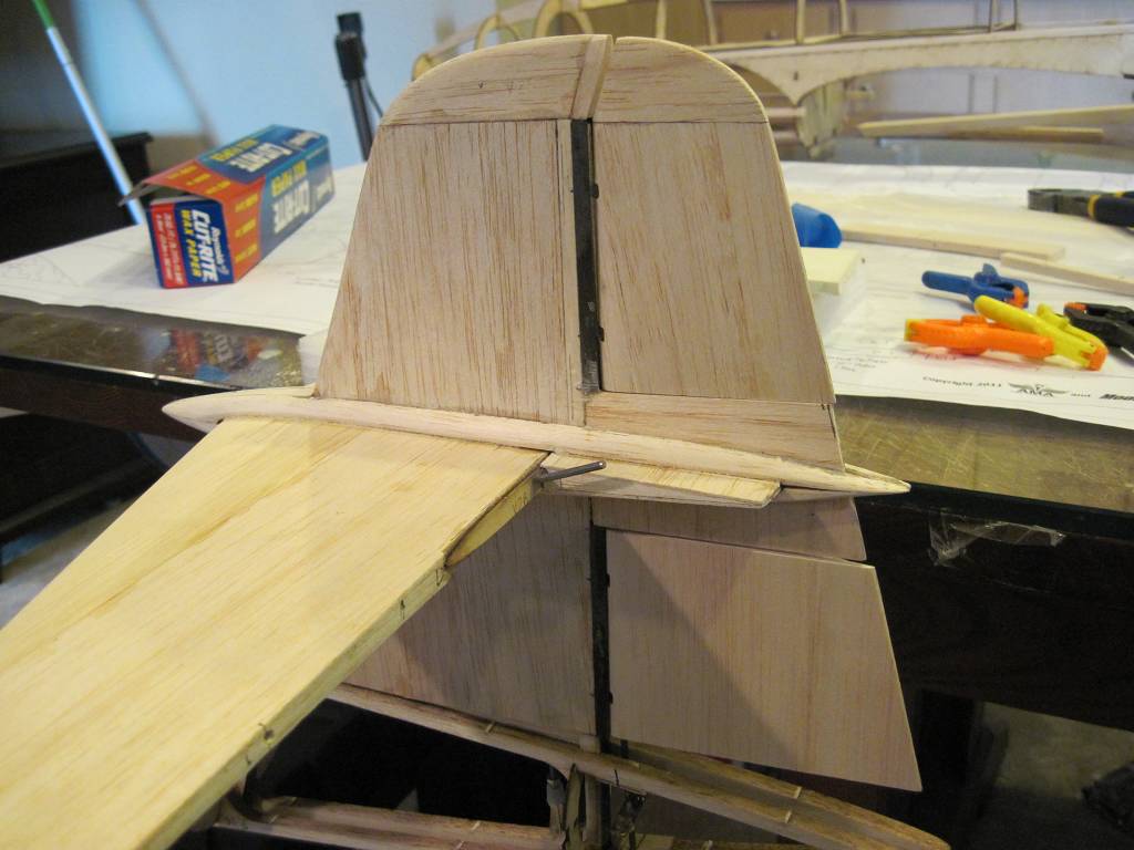

<div>I got back to the tail section and decided to do the closed pocket hinge line. I’m also doing a pull- pull for the rudder too.
<div>I cut in some blocks for the hinge points.</div></div>
