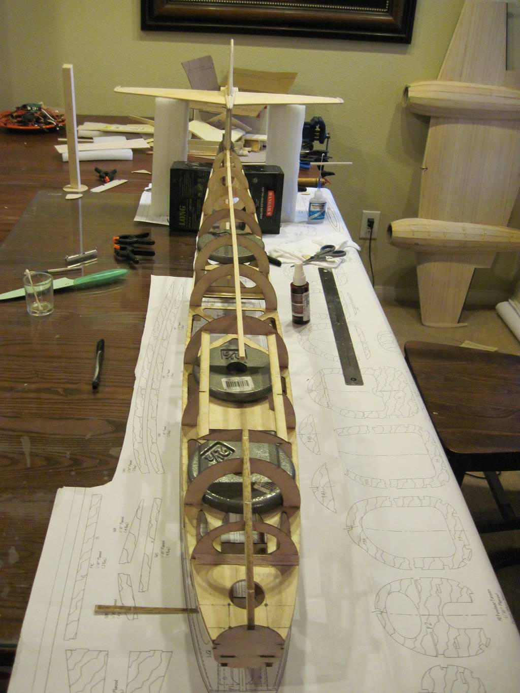

<div>Fitting the tail section takes a lot of dry fitting to get it right.
<div>I did the bottom section a little different then the plans. I used a solid piece of &frac14; balsa for the lower fin section where it meets the fuselage!

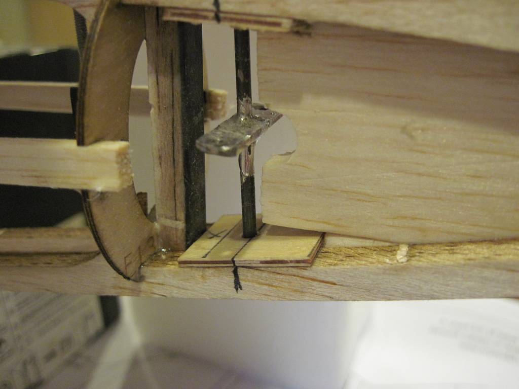

<div>My elevator and ruder servo setup, I&rsquo;m using a carbon fiber sleeve with a 2/56 push rod, and 2/56 pull-pull.
<div>My bell crank setup, 4-40 threaded rod with nylon crank.</div></div></div></div>
