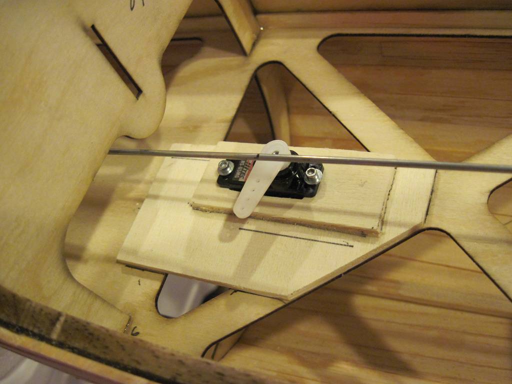

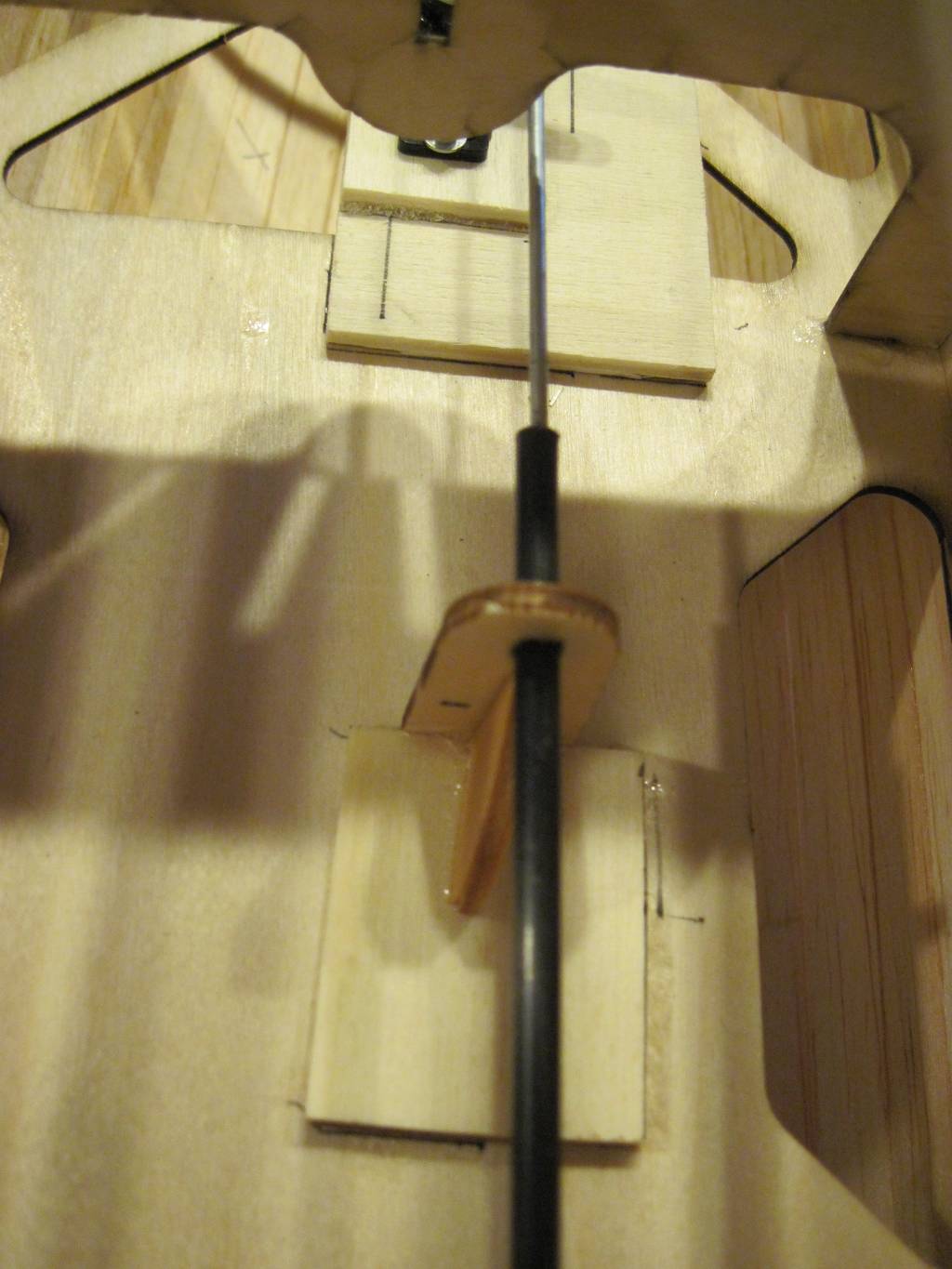

<div>My final linkage setup before it gets berried in the fuselage never to be seen again!
<div>I can reach post of the interior to apply CA to the inside planking.
<div>Next I needed to figure out how I was going to do the steering servo and connection for the nose gear. At first I thought a pull-pull system, but the e-flight gear comes with a clever lever that attaches to the arm and it works great for a push rod setup. I used the same carbon fiber sleeve as I did on the elevator and I&rsquo;m putting the servo at the belly where the wing sits in so I have access for adjustment and service.</div></div></div>
