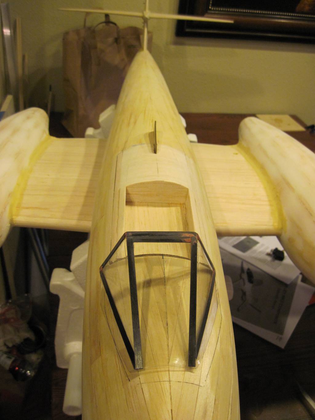

<div>Been chipping away at the canopy and main gear and gear doors, hers what I got so fare.
</div><div>So the canopy is all done, just waiting on my pilot to show up before I glue it all together. I attached the canopy slide fin at the back of the hatch, this acts as the tab to grab hold of to remove the canopy. I used magnet to magnet to hold it on and its very strong so you need to be able to give it a good pullto get it off.
<div>Not going to do the sliding canopy, too much work for this type of scale sports plane (lazy)
<div>The gear doors are all laid up and ready. I got one side done. I am still playing with ways to open and close them, sprig open, gizmo to close them!</div></div></div>
