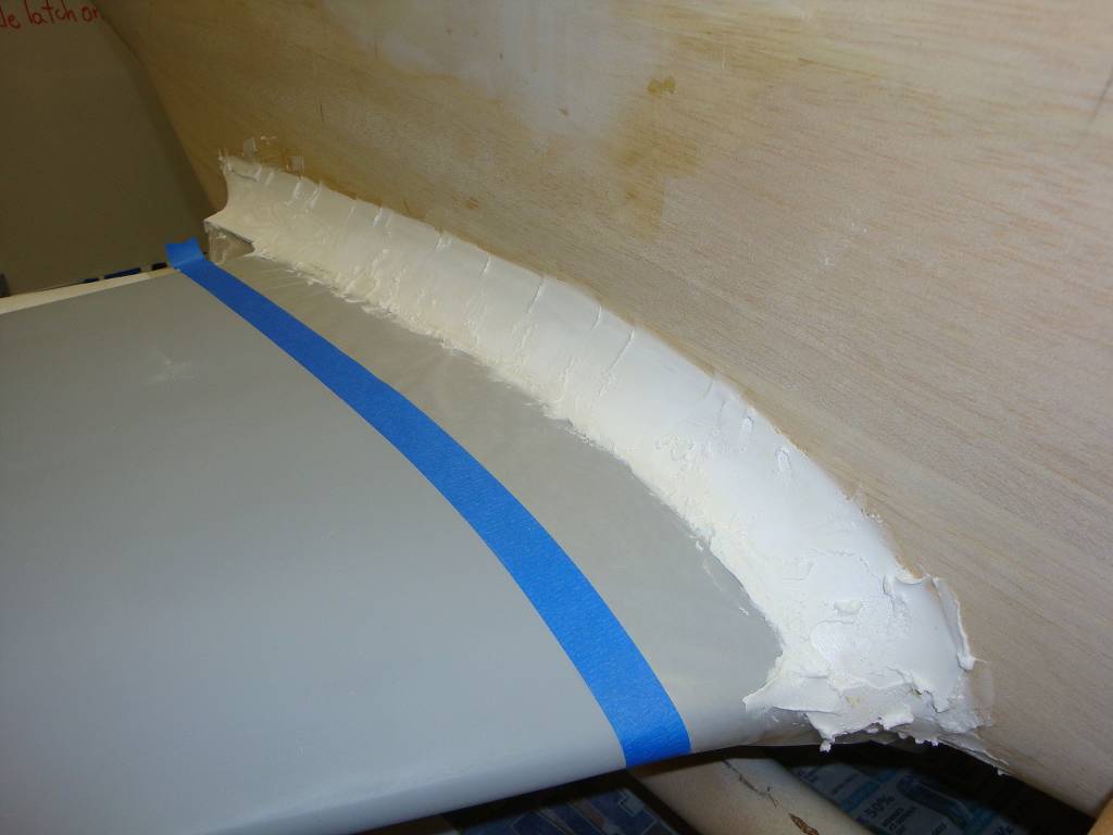

The kit comes with composites wing fillets which is nice also the match to the fuselage can use more work. First I gave a nice sanding to each area of the fillets especially the side that contact the fuselage, some epoxy was used glue them then again micro-balloon/epoxy mix to blend. Wax paper was used to protect the wing from becoming permanently attached to the fuse.
